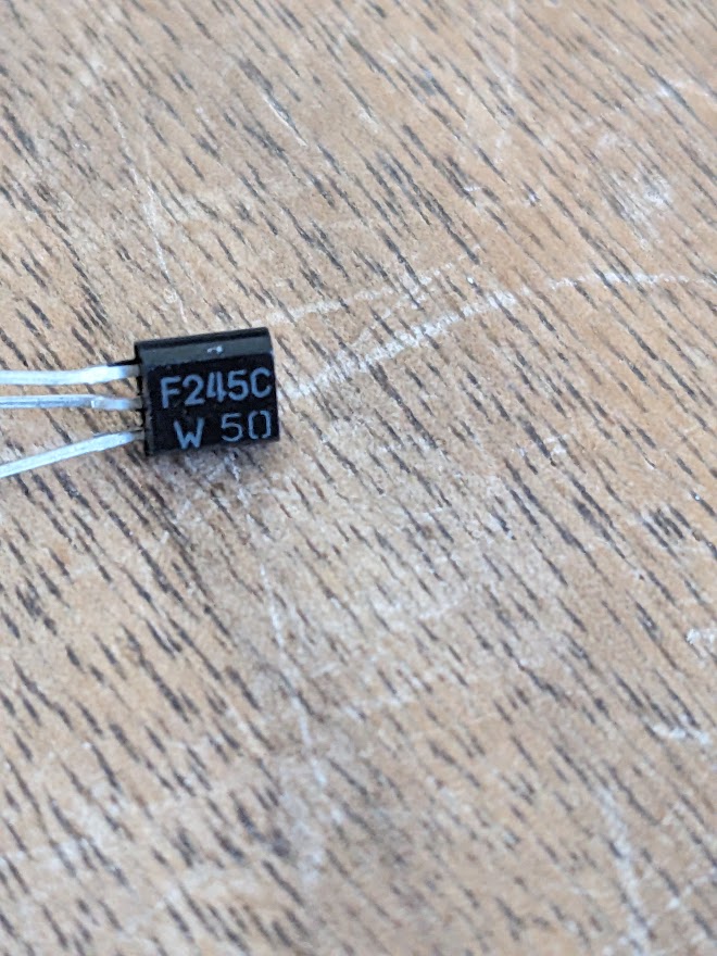

So what I did was I swapped the socketed transistors between the left and right channels to see if the problem would follow to the other channel, and indeed it did. So it does seem like it is one of the socketed transistors. Thanks everyone for chiming in about this.
They are marked F245C W 50. Would the 50 indicate 50V? The closest I'm finding online is BF245A, B, C. Though those are rated for 30V. Besides also being no longer in production. Any tips on a suitable replacement?

Thank you, Hugo!Art, it is a BF245C nFET. Buy from a reputational source (no Amazon or Ali and the like) and make sure it is a 'C'. If you can find it...

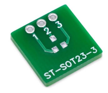

I've been looking for possible replacements but it ain't easy.
Some match but are also unavailable, unless you could go the SMD route.
