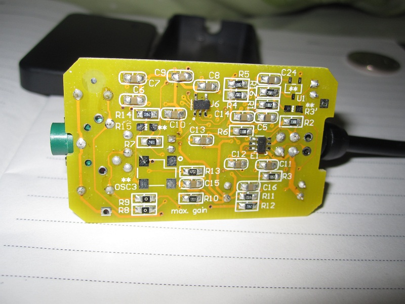

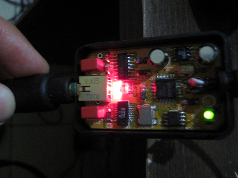

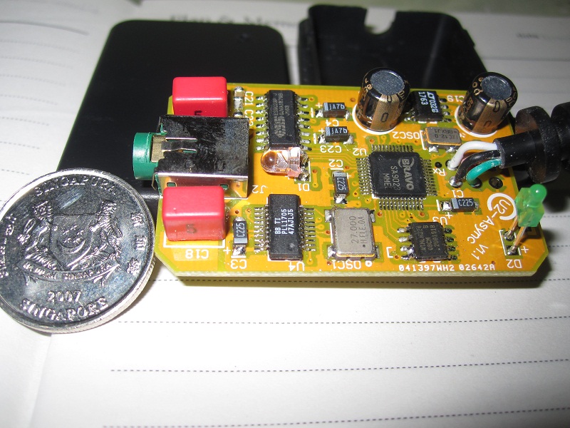

I open this little Asynchronous DAC, please see the attachment below. The cover not so good. Thin plastic, looks so cheap. It use Elna & Wima capacitor. The PCB also not so good.
