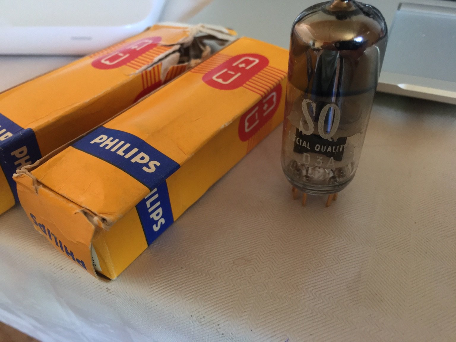

Got a pair of NOS Philips D3a. 🙂)

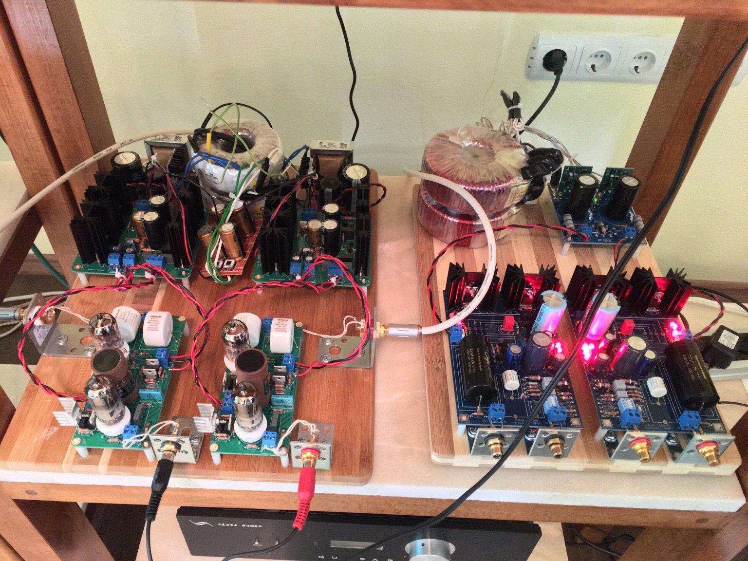

I just finished Salas folded simplistic and will compare against HMN.

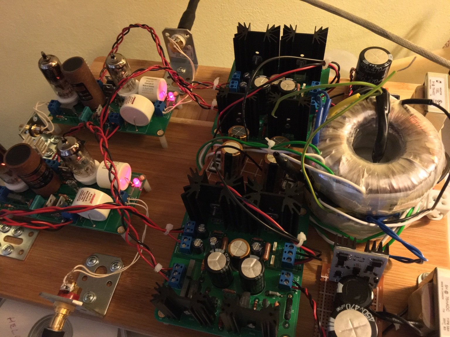

... and the winner is ...
First I will thank SY for such superb design.
I think a more appropriate name would be "The master of noise".
This phono is indeed noise free.

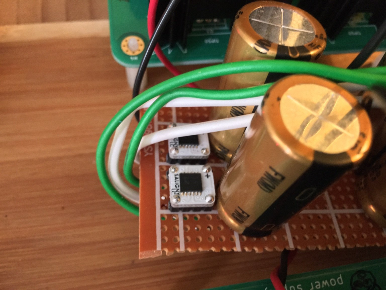

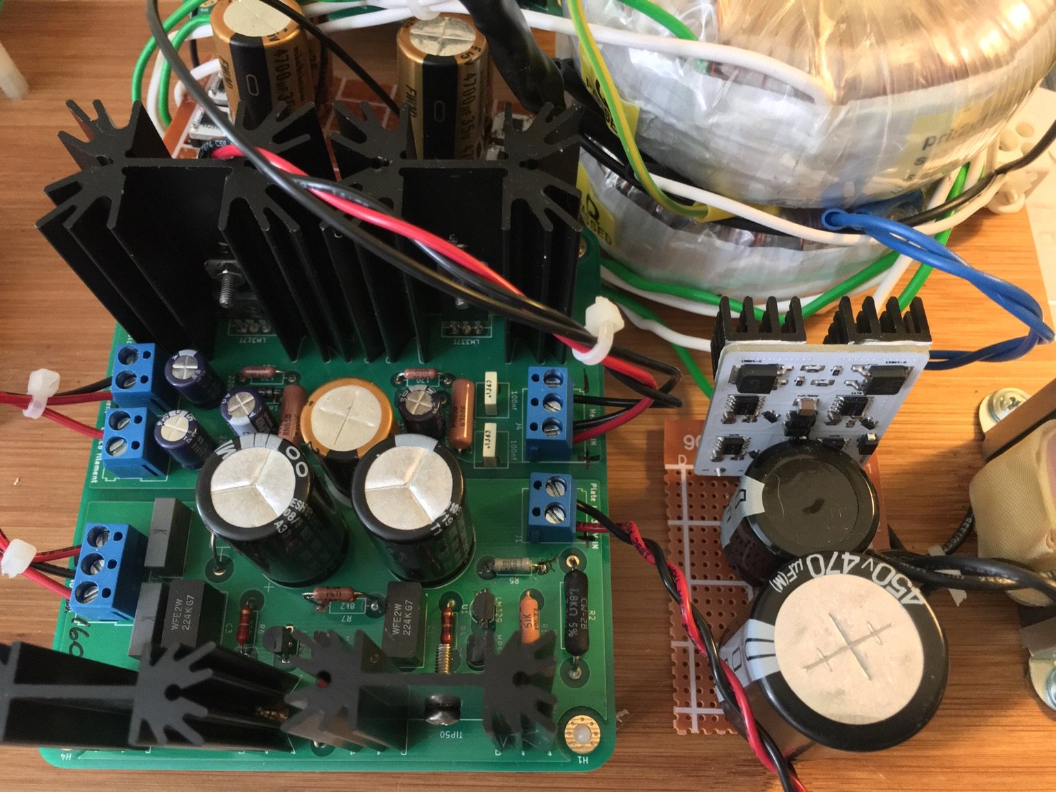

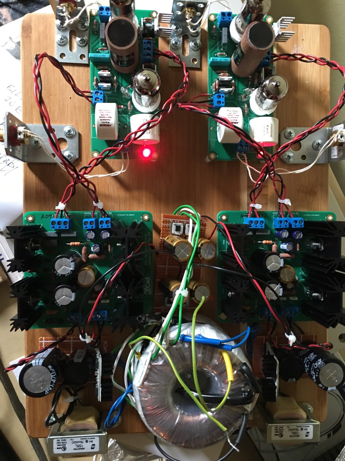

My implementation is dual mono with two transformers with three secondaries, 240V, 9V, 9V.
Rectification with ideal rectifiers, Saligny HVHF for high voltage and Saligny LC for heaters section.
The boards I have designed do not include rectifier and ballast coil. As soon I have time I will modify this.
There is also a small modification on heater that must be corrected as well.
Tubes used are Philips d3A and JJ E88CC.
System used: Rega Planar 1 with Hana EH, amplifier Quasar Q17 with High Density speaker cables.

Here is a direct comparison between Salas simplistic folded and HMN.
Again twitter compression is strong, but you can still hear a clear difference between two.

I love the Salas phono. It is well designed and sound good.
HMN is in another league. Timbre is different, better clarity, separation, huge soundstage, top spectrum is diamond clear, bass is round and precise.
To my ears and not only, HMN is a clear winner.
