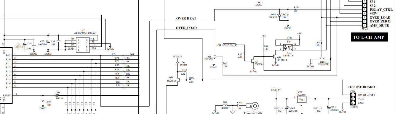

I got a HK980 for cheap today. I have a modified HK670 ( https://www.diyaudio.com/community/threads/hk-670-integrated-amp-sim-mods-etc.384245/ ) that I like, and this has the same power amp so I could not resist.
Owner said it goes into overheat protection randomly, but works fine other than that. I tested it abt 10min when I picked it up, and it worked fine. Did not heat up, and owner claims it's not hot when it goes into protection either. Based on this I guess there is a problem with the detection circuit, and not bias. Seems to be a NC temp switch that is connected to an input on a processor. Pictures below.
I have not opened the amp yet, thought I would check if someone here has fixed the same problem before, because it seems to be a common issue with these? If not, I will post what I find when I get to it.

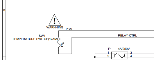

I have been fault tracing this amp a bit, but the overheat fault is hard to reproduce. Moving wires and tapping stuff did not seem to do anything. Played it for hours without a glitch. I ended up re-soldering all joints related to the temp switches, replacing caps in the low voltage supplies etc, but less than 1min after first start I got the overheat shutdown again. After that if did not happen while playing music for more than 1h.
I then decided to mount a not installed SMD pull-up resistor for the overheat input on the processor, and disconnect the circuit to the switches. I have several DIY amps without overheat protection, so I don't worry about that. The plan is to see if the fault is actually gone while the input is definitely high. If that works, the plan is to replace that resistor with a cap, since I'm thinking there might be some ripple on the voltage in the loop causing intermittent shutdowns. No filtering as is, and abt 1s filtering on the temp should not be a problem.
Possibly there could be some internal corrosion on the temps switches causing a bad connection..? I have never hear about something like that, but who knows..

A small update on this. No overheat protection with the pull-up. I found the temp switches online (China), so I plan to replace them when they arrive and I pull the amp apart again.

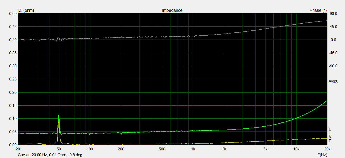

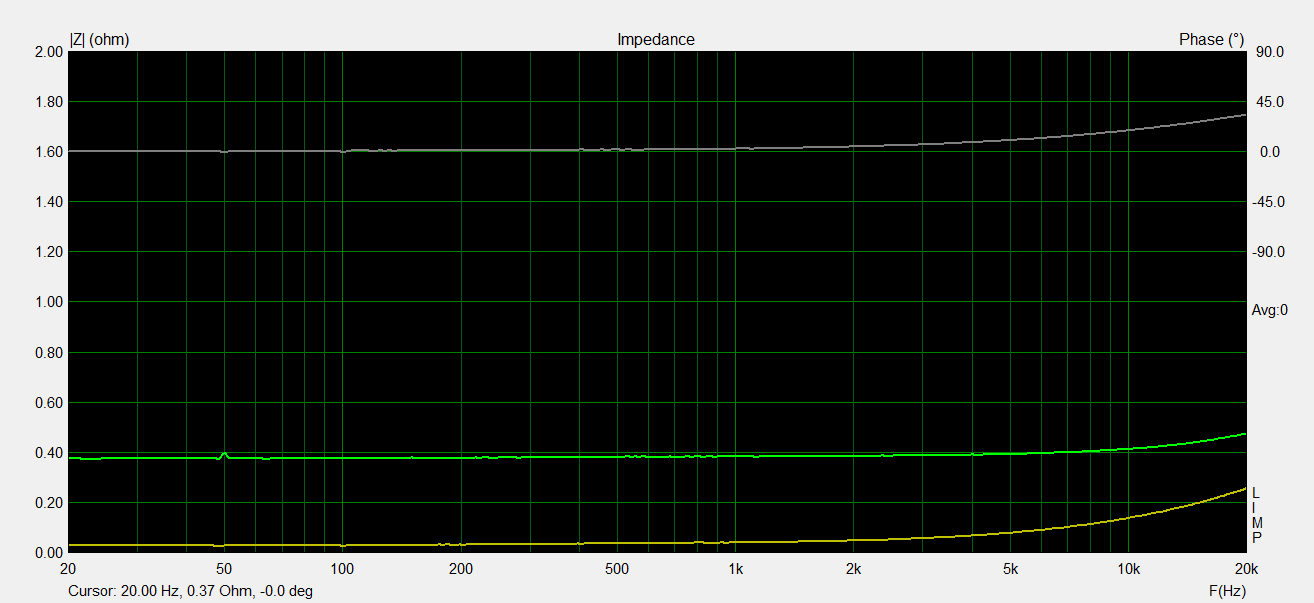

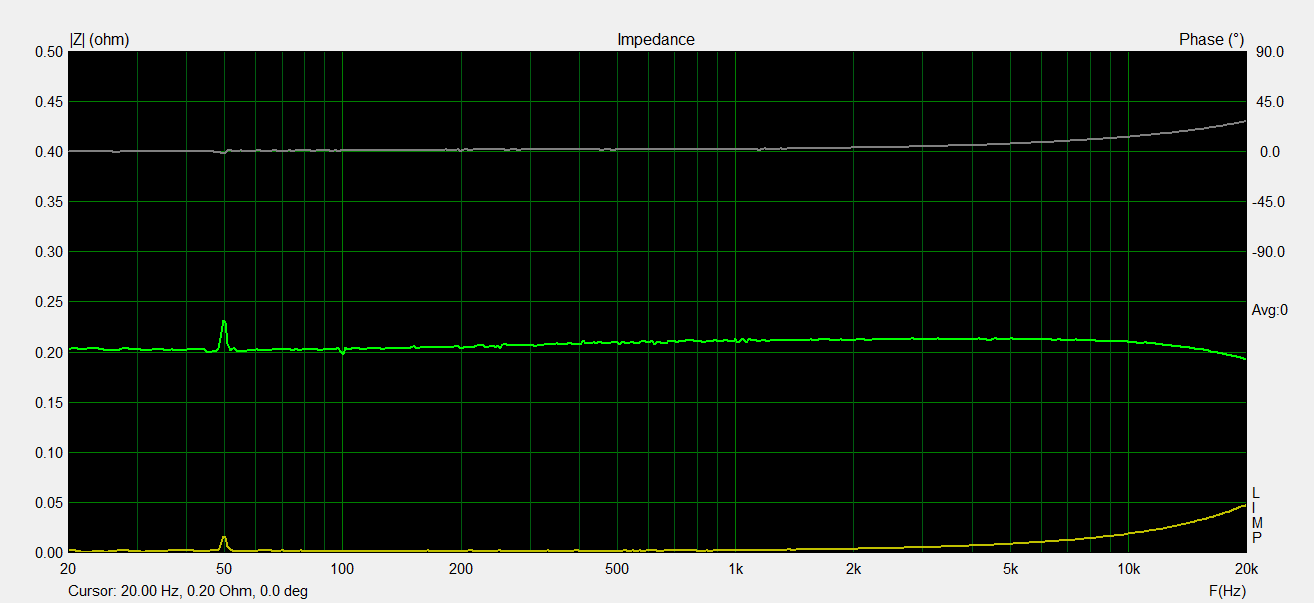

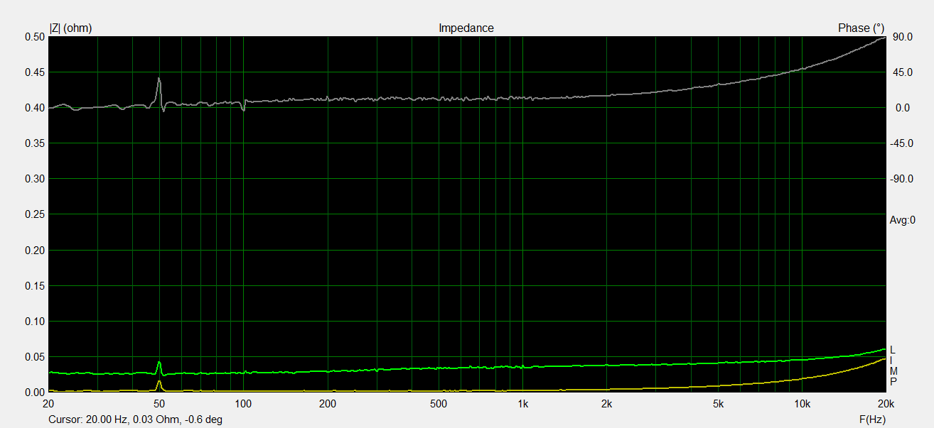

I decided to try some output impedance measurements with LIMP (ARTA) today. Not all plain sailing.. The version I had installed actually added cable compensation to the measurement, even if it should have subtracted, so after measuring one channel, I had to update to the latest version. There is also trouble measuring really low impedances, the result is like there is inductance, but with higher impedances, the phenomena disappears. I tried using different reference resistors, changing sample rate and bit depth output level etc, but nothing seemed to cure it. Ok, LIMP is not meant to measure mOhms so I can't blame it, and its also free (demo).It could be my setup too. High frequencies seem sensitive when I move the cables around while I measure a short. I'm guessing the reason is that the signal on the DUT-side of the reference resistor is basically zero when measuring shorts/low impedances.
The setup is a normal impedance measurement setup as described in the ARTA/LIMP manual, I just reduced the reference resistor to 2ohms, and measure the speaker terminals instead of a speaker. So, one channel is feeding the other in the same amp. In this case there is no common power ground for the L&R channels, because the transformer has separate secondary windings for each channel. The only common ground is the signal ground. This complicates things a bit, because I need to link the Speaker grounds between channels, or the current would pass through he thin coaxial signal cable to the amp boards. To avoid ground loops I disconnected the input signal to the channel measured (input left open, I did not have a connector that fit to short it) . There is some 50Hz pickup, but not too bad.
To be able to visualize the impedance of the amp terminals, I did one measurement with a short, and used is as overlay, then measured the amp. So the output impedance is basically the diff between the two lines, except in the top end where the measurement is not behaving very well at mOhms.
Something wrong
Good IMO
Also ok
Pretty bad!
Surprisingly there are massive differences between the A/B output terminals, so this is definitely something I will have to look at when I take it apart. While measuring one of the 'bad' output terminals, I tried pushing the PCB around the output relays, output terminals and an angled connector between terminal PCB and amp PCB, and I could se the output impedance change. I don't think I would have investigated that without doing these measurements. I think on the two measurements in the middle, the effect of the nested feedback is visible, with output impedance going down slightly to abt 200Hz where it levels off. Maybe measurement #2 is the one where it's easiest to see.
This was an interesting thing to measure, I have simulated it before, but now I did it in reality :)
I was actually surprised the measured impedance is actually this low, I was expecting it to be higher with all the traces, output inductors, relays, connectors, terminals etc in the output circuit.

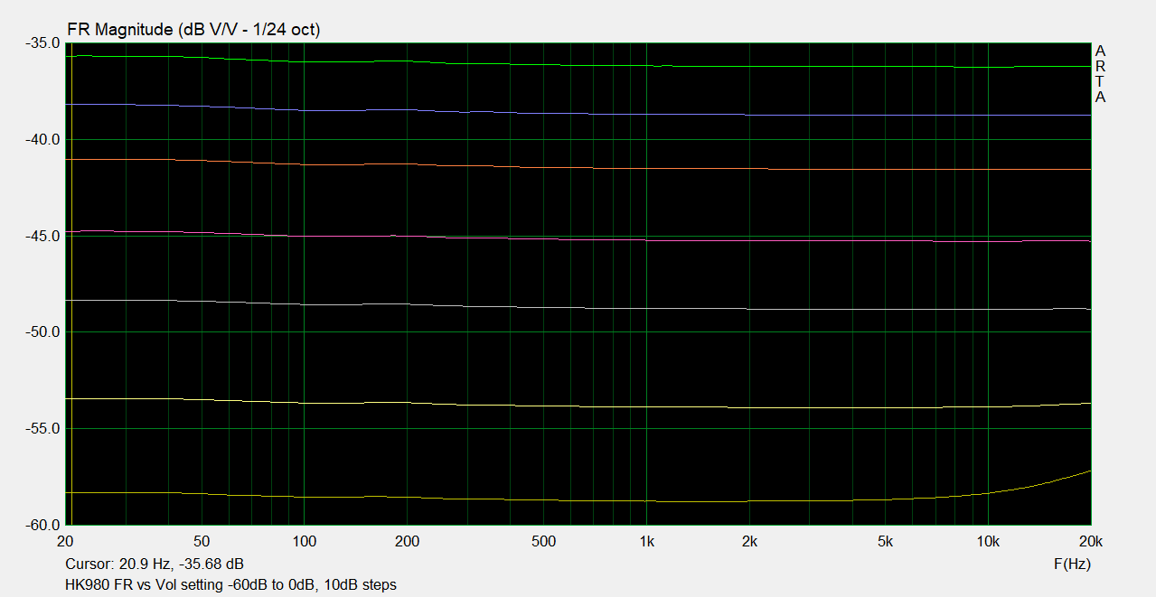

Another measurement while it's connected on the bench. Frequency response vs volume setting this time, since I saw something funny on low volume settings before. Did sweeps in steps of 10dB on the volume (-60 to 0dB), and adjusted output volume on sound card to get the response curves amplitude closer in the graph. Direct mode is on, so tone control is bypassed. The slight bass boost is most likely due to the nested feedback I added. The treble boost at -60db gets worse at lower settings, but I don't see even -60dB as a plausible setting when listening, so it's not as bad as I initially suspected.
Measurements are only done with pink noise, no accuracy is not so high. I don't have the patience for stepped sine!

I replaced temp-switches, and added a 1uF cap in the position of R73. This should filter out any noise/ripple on the overheat input to the processor.
I listened to the amp for a while, and the impression is positive. It's a keeper, -for me or somebody else :)
I forgot to update my last findings, so here is a short summary. I seems the transformer is not supplying enough current for the 12V(?) supply going to relay coils, led in volume knob, and overheat detection. I measured the voltage before the regulator, and it dropped below the regulator voltage with all relays energized. I think this makes the regulator flip out from time to time. Bypassing the resistors before the rectifier helped a bit, but energizing all relays still cased too much voltage drop. I could have added another trafo for this circuit, but I gave the amp to my brother and sintructed him to not activate A and B speaker outputs, that seems to solve it. You could try to mesure the voltage on your amp to see if it has the same issue.
Reactions: 1 user
It did not help for me, problem was that it was so intermittant that it took long to veify. At least check the supply voltage first to see if that is low in your amp too.
Mounting a pull-up resistor in the r73 position and disconnecting the wire to the temp sensing will get rid of the error, but disable the overheat protection.
