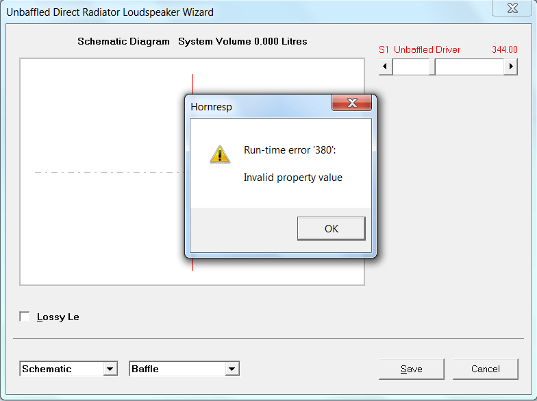

Hi Everyone,
BUG FIX
The fatal Run-time error message shown in the attachment was generated if the value of Sd for an unbaffled driver or a driver in a flat open baffle was greater than or equal to 1001, and the S1 slider in the loudspeaker wizard was dragged to the left in an attempt to make the value of S1 less than Sd.
This bug has now been fixed.

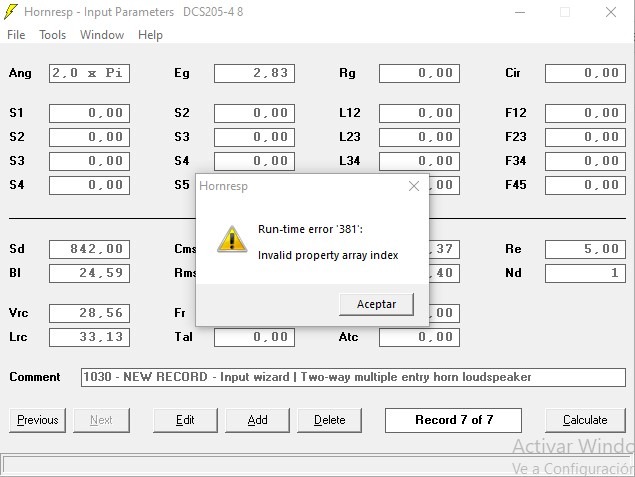

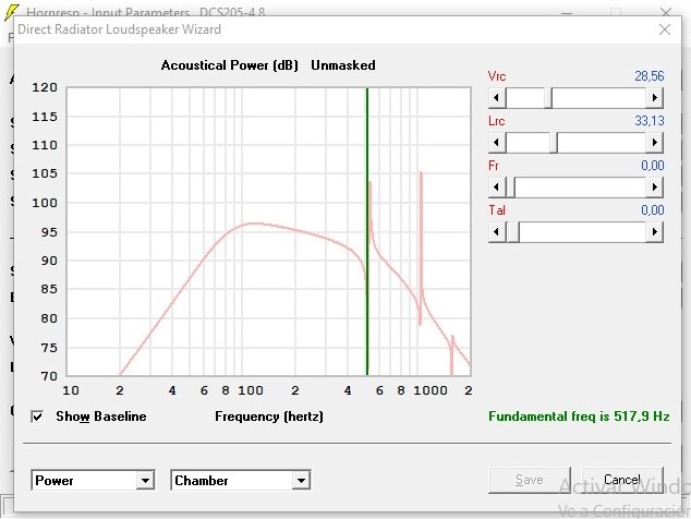

Hello @David McBean , I report two bugs
First, creating a new .dat file, click on save, nothing happens and after I click on editor button say error 381 (attachment 1)

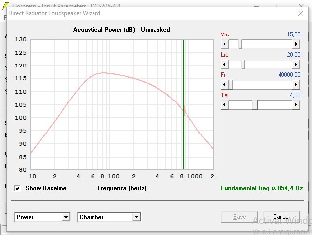

Second, loudspeaker wizard on closed box design, the fudamental frecuency is always the first peak in the graphic (attachment 2 & 3)

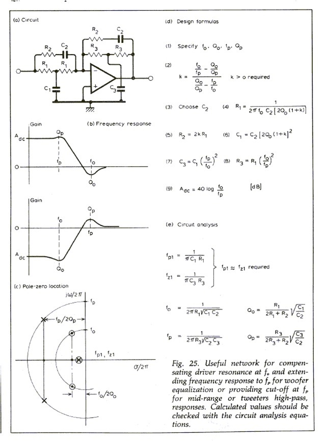

Finally, I have a request if possible add the "Linkwitz Transform" in filter wizard menu (attached 4 of basic formulas and analyses)
I see what you mean, many thanks for the feedback!
It used to work, so something has definitely gone wrong somewhere. I need to investigate…
Depending upon the loudspeaker design and driver, Hornresp sometimes has difficulty in identifying the fundamental frequency, particularly if the 'resonances not masked' option is being used. Try simulating with the 'resonances masked' option selected instead, to see if this makes any difference.
The impedance chart usually shows the frequency of the actual system resonance quite clearly. Depending upon the design, the displacement chart can also sometimes make it obvious.
I know very little about Linkwitz Transform filters. From the information you have provided it would seem that they have the general characteristics of low and high shelf filters, which are already included in the Hornresp Equaliser Filter Wizard.
How many filters would be required?
What would be the slider inputs?
What would be the expressions to calculate gain and phase at a particular frequency, using the slider values as inputs?
Fixed, turning off The Resonances shows the actually fudamental frencuency. I always had it checked for "accurate results".
In fact, it is the same principle, Linkwitz Transform seeks to extend the frequency response and eliminate peaks to have the response as flat as possible.
where:
F0=Fc
Q0=Qtc
Fp=new frequency to extend (ideally new cut-off)
Qp=new Qtc for flat response
The goal is to take F0 and Q0 directly from hornresp and with the sliders choose Fp and Qp and show the value of K which is important to be greater than 0 for the circuit work properly.
The overall gain of the filter is equation #9, the phase change I'm not sure, but I'm putting some links that have more information about it.
https://www.linkwitzlab.com/filters.htm#9
https://www.linkwitzlab.com/x-sb80-3wy.htm#part2

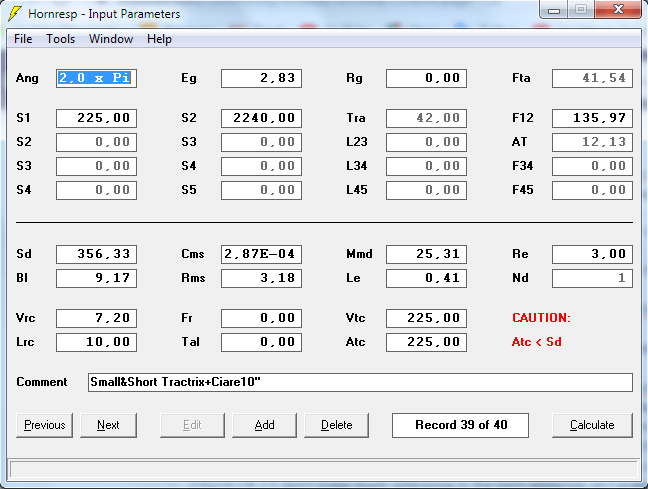

Thank you David, I did not realize I somehow messed up the excel sheet I use to calculate the various surfaces for rectangular horns, and so SD was wrong.
It is a Ciare driver, first time I use a driver of this brand so although a reputable factory I thought that perhaps the TS parameters from the factory might be off.
Thanks for pointing out my mistake (which would probably go unnoticed for the foreseeable future LOL).
@Kravchenko_Audio your remark about the quality of the driver, is it related to the the wrong data I posted ? Or you see something in the TS parameters which is off ?

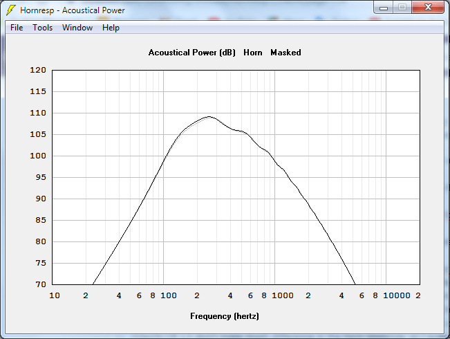

I attach figures and power response, it is a short/small Tractrix midbass horn, 42cm lenght and 70x32cm, intended to cover the range from 100-150 to 600-800 with EQ. Power response is not much different from what I get from a bunch of other drivers, actually some result in more ragged power response. It would be interesting to hear your thoughts on the project after reading your remarks on the driver's TS parameters. Lower range is on a 96db/W/m 18" woofer in a ported 250 liters box.
I have some concerns regarding EBP (152) and BL (9). Also not sure about compression ratio. S1 196 (14x14) CR= 1,8 or 225 (15x15) CR 1.5 don't make much difference in the horn response, so I guess this should be decided on what might work best with the driver.
BTW this is a driver I already own and am willing to accept some compromises.
