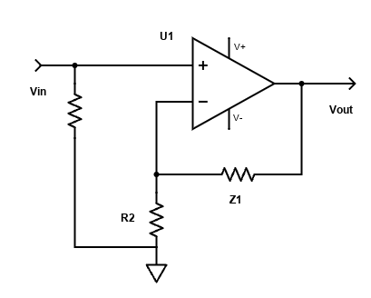

IMO, the most important thing is not to have systematic error. Your pre-amp implements the 75uS pole passively to avoid the typical "+1" error in active EQ.

Can you elaborate on this please? Is that related to the divisor of the general feedback equation A = A0 / (1 + bA0) ?to avoid the typical "+1" error in active EQ
For the non-inverting feedback topology: Vout = Vin x ( 1 + Z1 / R2 )
So the minimum possible (ideal) voltage gain is unity, when Z1 = 0.
