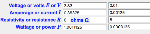

Regarding the potential distortion issue caused by DC offset:
10mv or 0.01v would be ~0.0000125 watt into an 8 ohm driver.
If all that DC power was converted into sound pressure in the form of harmonic distortion, it would be more than -86dB SPL (sound pressure level) below one watt level. Up to one watt, any tweeter of ~86dB 1w/1m the distortion level would be below 0dB SPL, around the minimum level that can be heard by 18-25 year old normal hearing people in the 2-5Khz range.
Quiet listening rooms are ~30 dBSPL, levels below that are "masked", difficult to hear.
Harmonics -60dB below the fundamental frequency are .1% harmonic distortion.

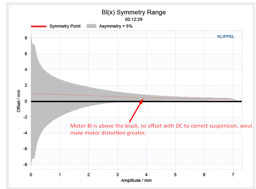

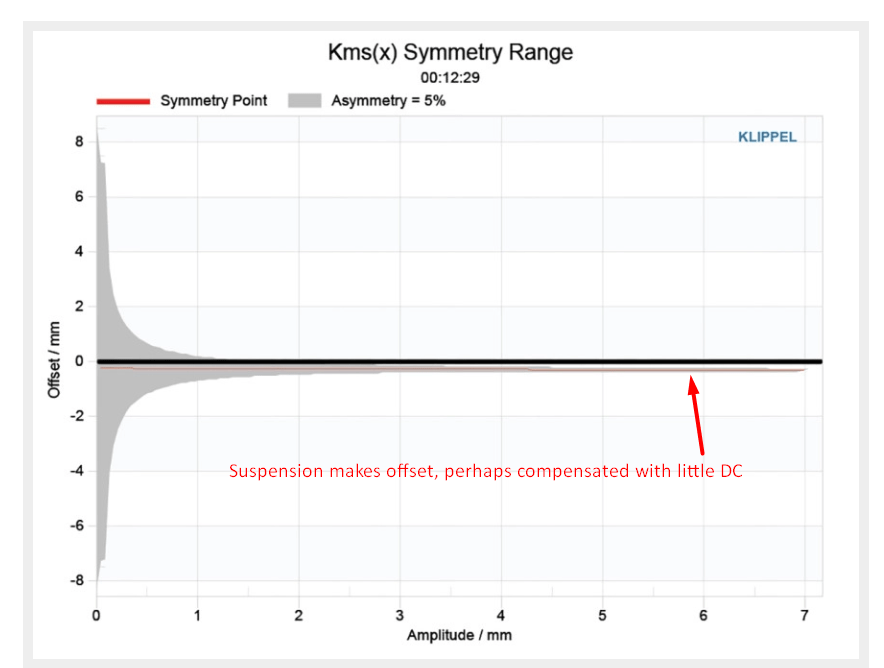

I'm not pro at this, but trying to stitch pieces of info together: I think suspension non-linearity makes 2nd harmonic, and suspension is involved mostly on the resonant frequency, so perhaps what NP shows in the video is what suspension offset does, and little bit of DC just "biases" the voice coil (suspension) better, just like with the KCS above, shifts operating point of the driver so that distortion reduces. KCS does this automatically, where NP has done it manually, and is somewhat dependent on driver I assume. I mean, perhaps not all drivers benefit? Although all specimen NP showed in the video did, with various amounts. Perhaps it's always fine, most drivers being very similar in their suspension always have the suspension stiffening to same direction? Anyway, interesting stuff, especially if the little DC allowed for "better" amplifier stage, good stuff for DIY folk.
edit.
thinking further, I think suspension non-linearity could dominate (acoustic) distortion around Fs, but not above where motor non-linearities start to dominate just because suspension is dominated by the mass. I think air in the box is also part of the suspension, and mostly involved on the lows. If the NP experiment was repeated with full bandwidth distortion data, I bet THD would drop on the lows only, while it could go higher on highs. If motor properties, like Bl(x) or Le(x) is offset above the black line, then the bias would increase distortion on above the resonant frequency. To reduce distortion whole bandwidth, all Kms(x), Bl(x) and Le(x) need be offset to same direction.
Here is BL offset of the same driver as Kms offset above.
Now, which one to compensate for, suspension or motor offset, or all of them? Depends if the driver is mainly used around it's resonance, or above. On fullrange driver system better get driver where everything offsets to same direction. Anyway, perhaps DC is best tuned observing full bandwidth distortion measurement.
ps. looking at VC test bench speakers, some have asymmetry offset on the same side, while some others don't. Here is fullrange driver that likely benefits from DC on the whole bandwidth. But would this need negative DC?
edit.

Interesting I agree, but not important to ponder what .001 volts does when the speaker
operates at 2.83 volts or higher. much much higher in high SPL
Sure you can Add the offset. Test a speaker at 2.830 volts then test it at 2.831 volts

So the significance of 2.83 volts at 1 watt compared to .001 volts of DC offset
is such a waste of time to even ponder.
If .001 volts makes a difference to a speaker its = junk
