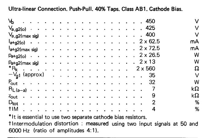

Follow up question: why does MO Valve assert "it is essential to use two separate cathode resistors" for each of the self biased push pull output stages. I have followed their advise in my builds, but shared cathode resistors are very common in many commercial amplifiers.
For lower distortion Class AB is better with separate resistors and class A with common resistor.
Reduction of plate voltage is one reason. But the big one is that class AB operation becomes possible with fixed bias. In class A, peak cathode current is twice idle current, no more. In AB, peak current can be higher, while opposite tube is cut off. Average current increases, which would increase bias voltage if cathode bias were used, causing crossover distortion. So cathode bias is limited to class A operation (except for brief peaks). For the same reason, idle current can be reduced - peak current is limited by the tube, not twice idle current.
Absolutely right. Fixed bias allows running push-pull amps in class AB mode, with higher anode voltage, to get more power.
