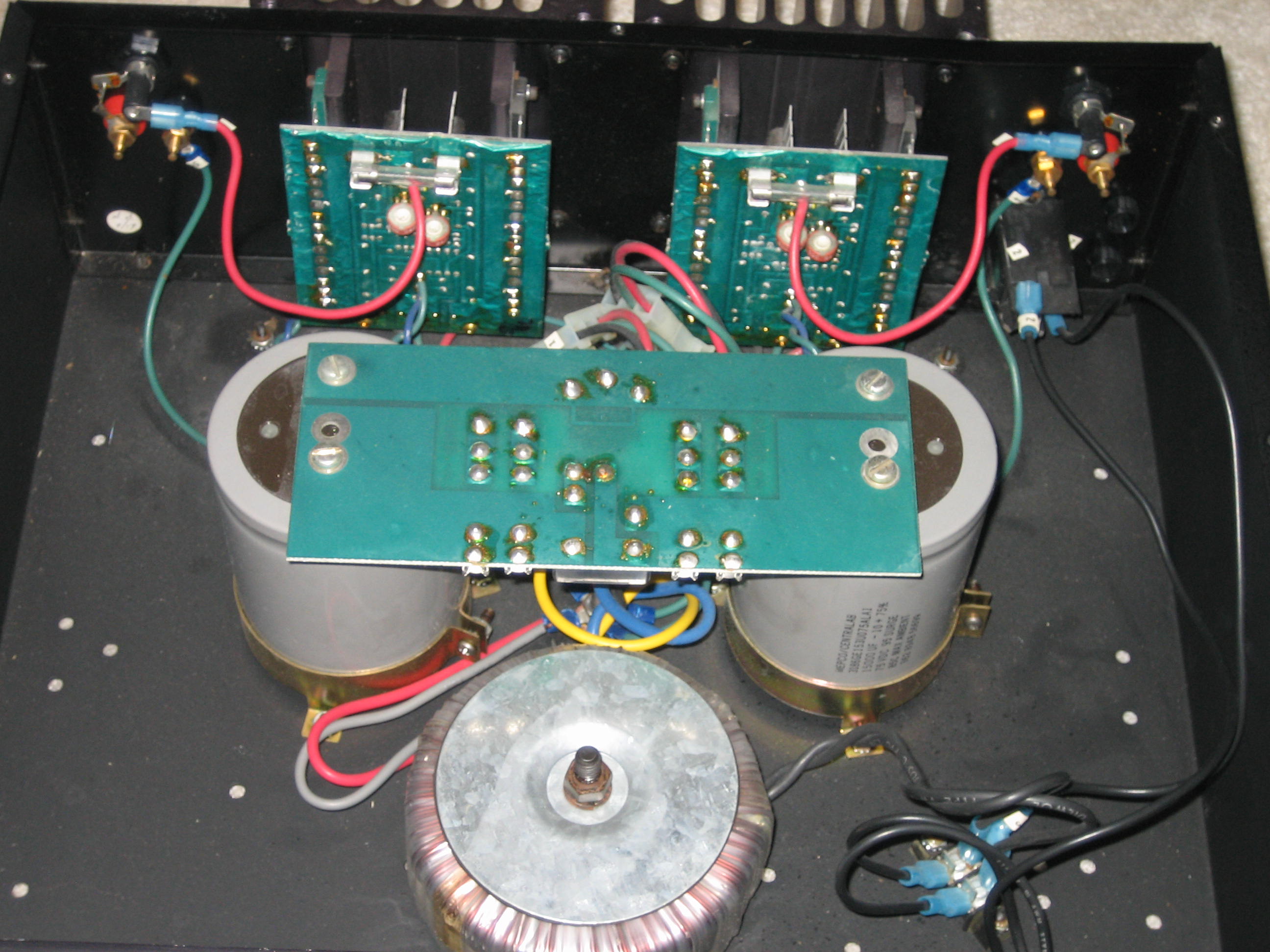

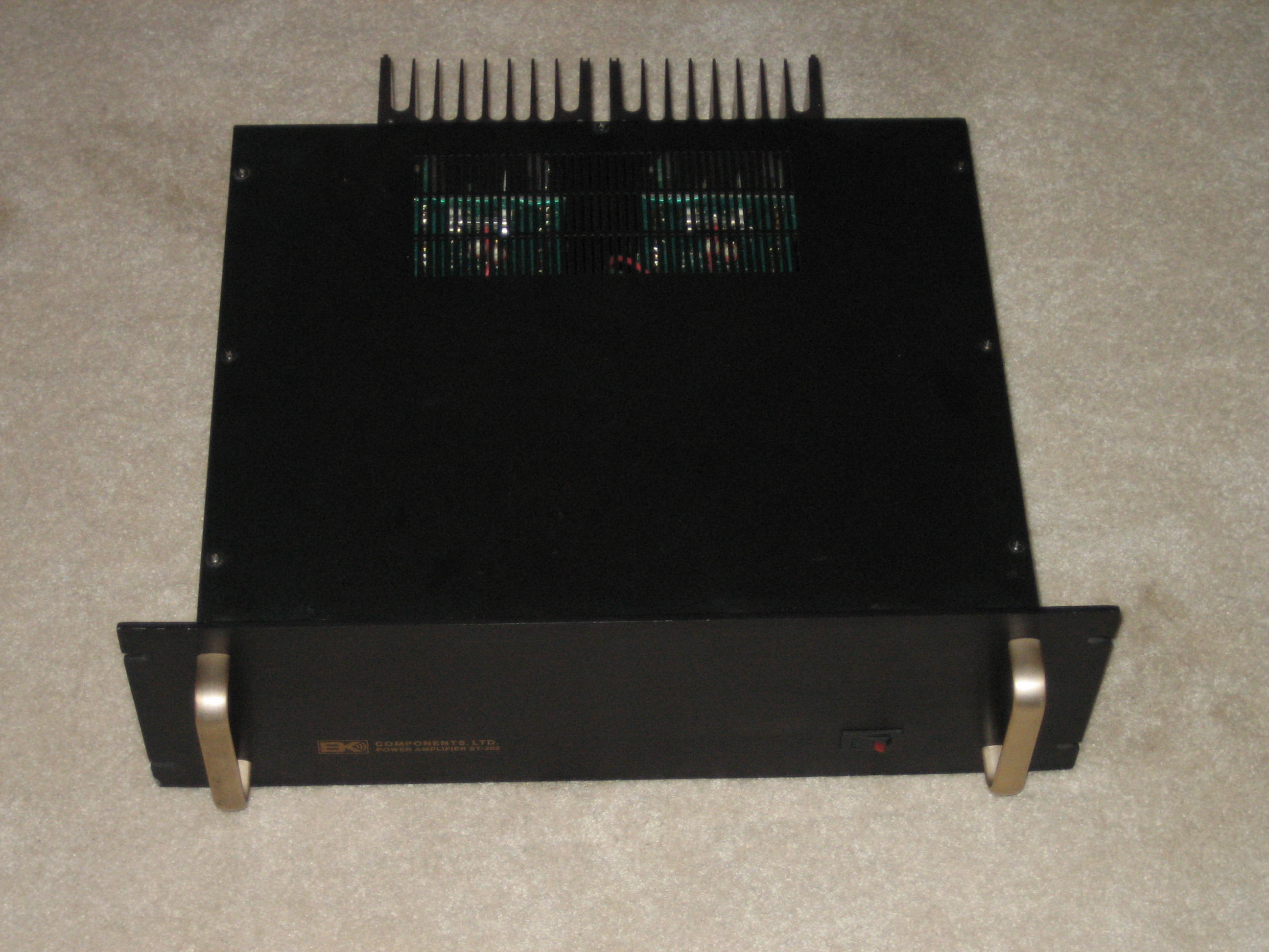

I like the idea of salvaging the chassis. Can you give a rough measurement of the heatsinks? Alephs run hot.
I'm attaching 2 pix, one of the outside, one inside (we all like looking at equipment, right?).
The chassis is approx 16" wide, 13" deep, and 5.5" tall. The faceplate is 19" long.
I have no doubt that the existing heatsinks are inadequate (and in the wrong location) -- they're 4.75" x 4" x 2.25" (fin height).
It's got some huge caps inside - 4.5" high x 3"diam. 15,000uF 75VDC, 95VDC surge. But... they are probably 20 years old.
My plan is to use the chassis: remove existing heatsinks, buy ones the run the length on the sides, and cut some holes in the existing side walls to allow mounting parts to the heatsink.

Yes, you will have to get some heatsinks the length of your chassis.
(Actually, you will probably have to get a pair per side, as it's much easier to find extrusions 6.5" wide than 13" wide.)
Make sure your heatsinks have fins that will be vertical. If they go the wrong way you will get it too hot. Salvage the posts, switch, lamp, jacks, etc... That stuff is expensive to replace.
Take a penny covered in a layer of paper towel dipped in acetone to rub off the silkscreen on your faceplate.
