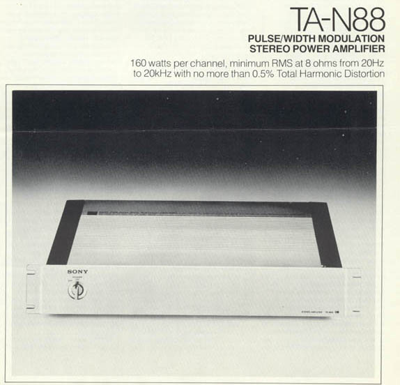

Sony had a class-D out in the early 80's. There were others, but I can't think of them just now.
Here's a pic of the Sony.
Rodd Yamas***a
