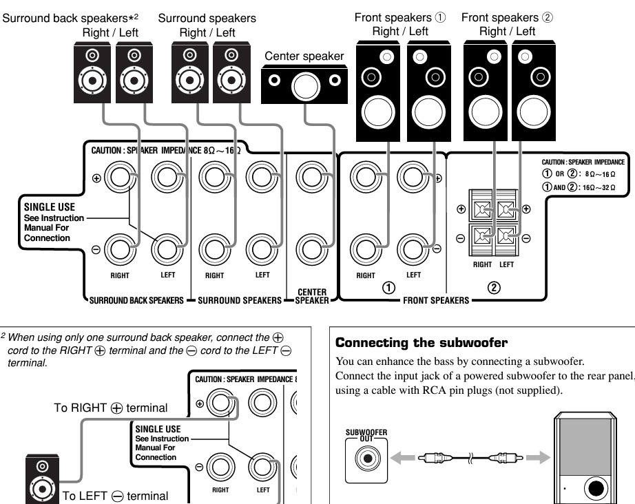

The speakers I am using are in A+B combination (4 speakers) / the unit states in the manual use only 8 or 16ohm speakers at each terminal, however both pairs of my speakers being used are 4ohms. Technically speaking I get away with using these same speakers on other receivers fine (making sure to always use a good fan to keep the heatsink cool) and there is no issue driving them hard for extended periods. I have one Sony 110w which only has Speaker A terminals and it's got a hard switch to select 4ohm or 8ohm, so I set it to 4ohm and installed the 2x 4ohm speakers totalling 2ohms and ran it for 10mins, the heatsink got so hot I panicked and installed a permanent fan. Now it runs fine 2ohm speakers testing for a solid hour at loud volume, no issues (and stays just warm now).

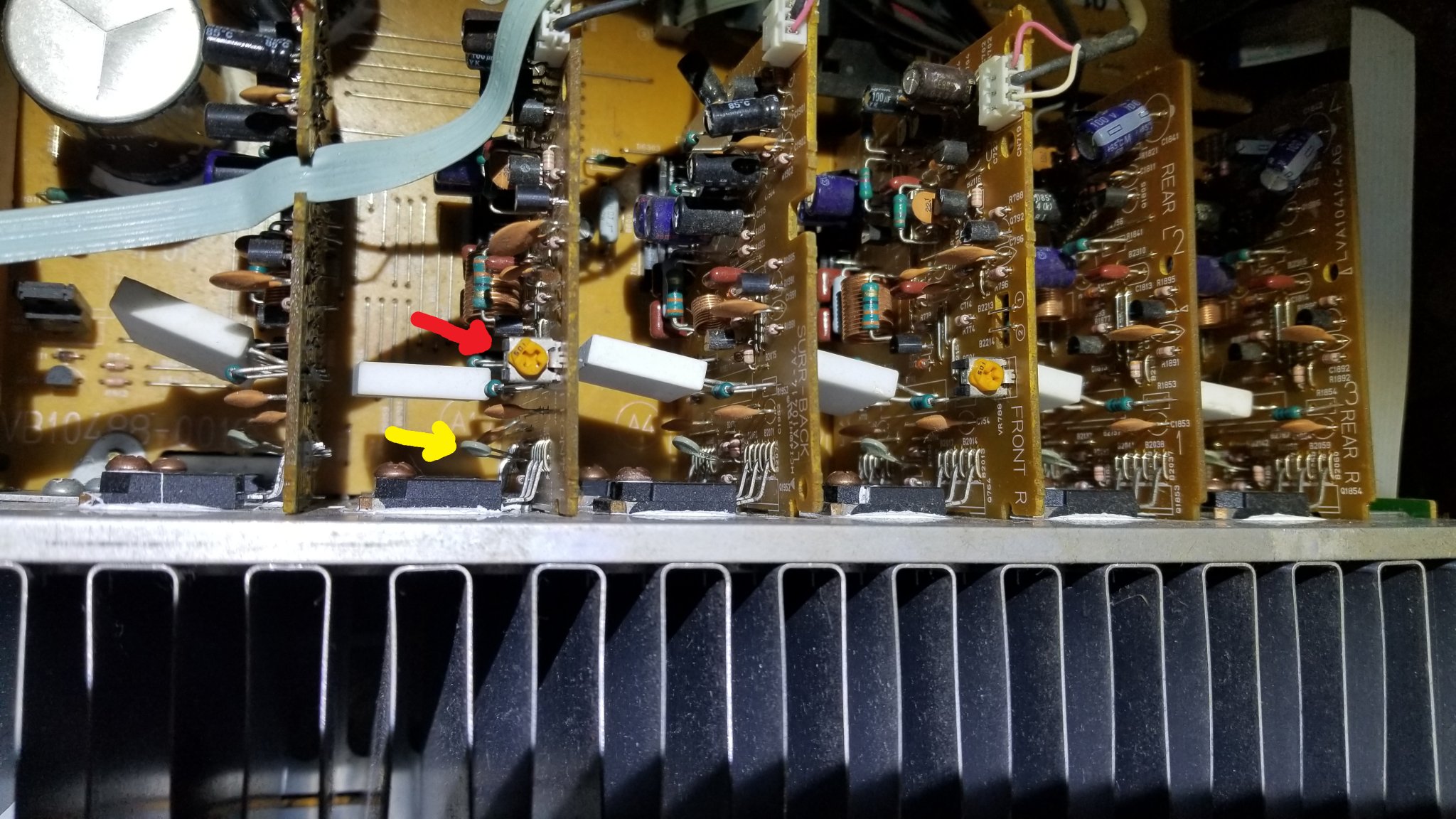

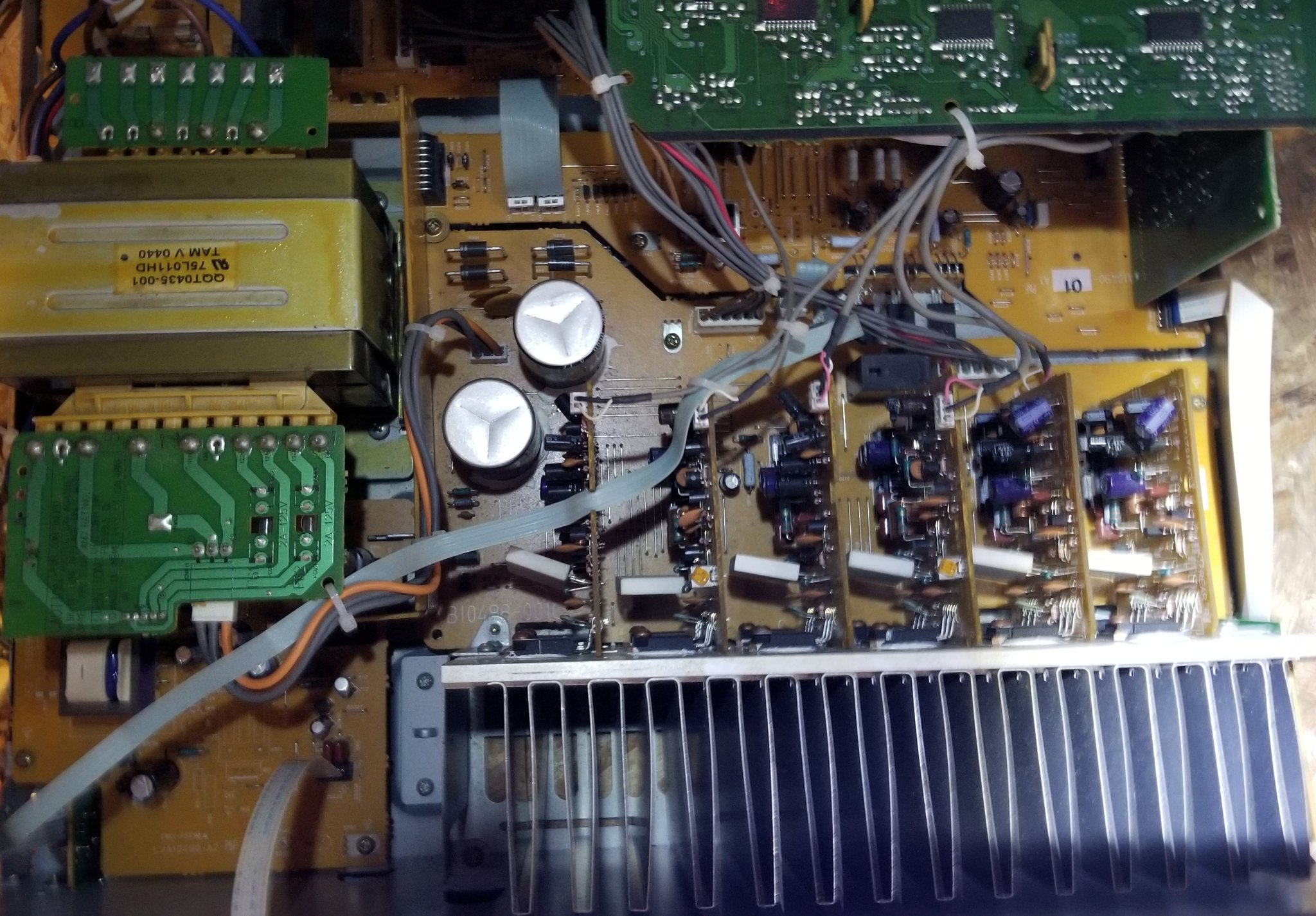

I've included some images, in the one image I have two arrows, the Red Arrow points to a trimmer that is on only found on the L / R channels amp boards. Judging from the type of wires running to these pcb's I'm assuming these pot/trimmers are a "line input levels" (for gain up or down). However I'm not sure how these circuits were designed, and more importantly what an over-current circuit looks like (and or where they would locate it) so these might also be the "cut off voltage trimmers?" I dunno hence why I am posting here.
I've also included a potential "sectioned out pcb" that looks like it might be regulating the voltage... so perhaps this is the over current circuit?
But lastly, I also marked a "yellow arrow" to what I originally thought was temperature sensors doing the cut off....(it looks an awful like a Thermistor to me) AND the PCB label for this part is literally "TH731" further indicating it's "THermal" sensor, so perhaps I can just swap these out with another value? Or put a resistor in their place? But what value... hmmm.

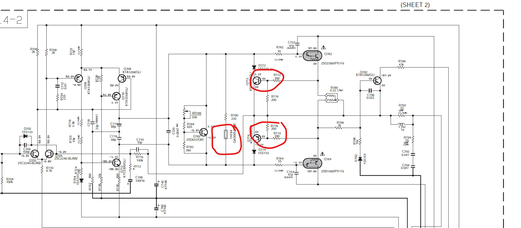

The part your yellow arrow points to is a thermistor and it is part of the bias current temperature compensation. The preset is for setting bias current. Do not alter the presets unless you know what you are doing.
Over current sensing is totally conventional and is done by monitoring volt drop across the output transistor emitter resistors. Thermistor and over current circuit highlighted.

I have just gone back to the first post in this thread.
A pair of 4 ohm speakers have been connected to an amplifier that is clearly meant to have 8 ohm or 16 ohm speakers connected to it.
It would normally get hot and fail however the amplifier in question has overload protection and is shutting down as it should.
A pair of 8 or 16 ohm speakers need to be obtained if the amplifier is going to work correctly.

As you know, that unit is only rated for 8 ohm speakers so expecting it to run a 4 ohm load at high volume is unrealisitc, regardless of how other brands or units may handle the same load.
And if you really want to find out what it can, or cannot do, you need to be able to reliably measure the output power.
For that you need a signal generator, a scope and a 2 channel 8 ohm resistive audio load.
Given the unit is about 20 years old it's also possible it's simply not performing to spec.
