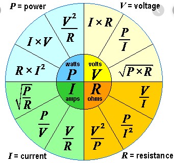

Power = Voltage x voltage divided bij nominal speaker impedance. E.g. 3V output with 8 ohm speakers would give you (3 X 3) / 8 = about 1.13 Watt.

Of the speakers? 8 OhmAnd what is their impedance?
If impedance is not listed, you can measure it with an Ohm meter.
Say you measure +/- 7 Ohm then the speaker would be 8 Ohm.
If you measure +/-3 Ohm it will be 4 Ohm.
With the formula above you want to know the max. voltage to be applied to the speaker.
That would be V² = R X P.
For 8 Ohm that would be 8 X 30 = 240.
Square root of 240 = 15.5V
Now you can calculate the same if your speakers would be 4 Ohm.
I wouldn't apply 15V to those speaker though.
I bet for normal listening levels you'll have plenty with half that voltage, wich would be 7 Watt.
The rest is headroom for peaks (and parties )
Hugo
