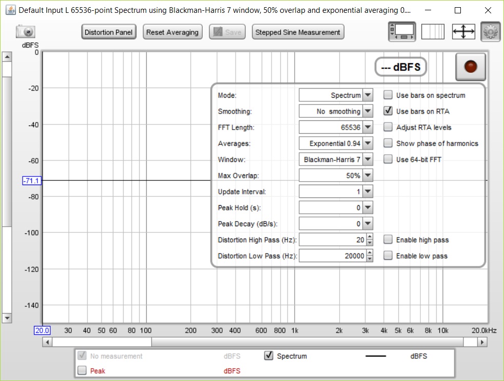

Once you install it, install software or drivers for your sound interface. I have used even the built in sound card in a PC to do this and it can work. However, those are generally very noisy and you won’t get the nice -130dB noise floor that some standalone interfaces can achieve. I personally use a Focusrite Solo (2nd gen) and 2i4 (2nd gen). They both have the same ADC’s but the 2i4 has a front end that is more flexible. I also think it has slightly better low noise characteristics. But you can use any sound card as long as it is supported by REW - and that includes any Java supported card. I haven’t found one that is not supported yet.
Next step is to connnect your interface by plugging in the USB cable, for example. Some of you might have other interfaces. The go into the setup menu and configure the sound interface. I typically the non-ASIO interface as I find that more finicky to work. Then choose your input device as your sound card and your output device as your sound card. Choose input and output amplitude to be “Master” and set to amplitude of 1.0 - this lets the full signal be generated by the sine wave generator and the full signal be captured by the ADC.
On the input settings choose the channel where you will connect your amp’s load resistor. Channel 1 is typically the “Left” channel and channel 2 is “Right”.
At this point you can see what the inherent self noise of your sound interface is without anything connected. Click on the “RTA” button along the top. In this dialog, click on the gear to adjust the settings. I use something like this:
759469d1559065630-diyaudio-watt-m2x-rew-rta-setup-jpg
You can try other settings. Making the averages smaller like 0.88 exponential and choosing 32k points will give you almost real-time updates to the FFT. You need to click on the span button to set your range of measurement from say 20Hz to 20kHz. On the vertical scale button on upper left click on dBFS. Then click on the red button to acquire your FFT spectrum.
You will see a relatively flat spectrum (hopefully) but this will tell you what the noise floor of your setup is. A cheap built in sound card on my pc only gets -110dB. The Focusrite get -130dB. There are ways to achieve better noise floor and much is discussed in threads elsewhere. For many of our SS amps around here the typical noisefloor of the Focusrite is fine as distortion is typically no lower than -100dB abd typically -80dB or so.

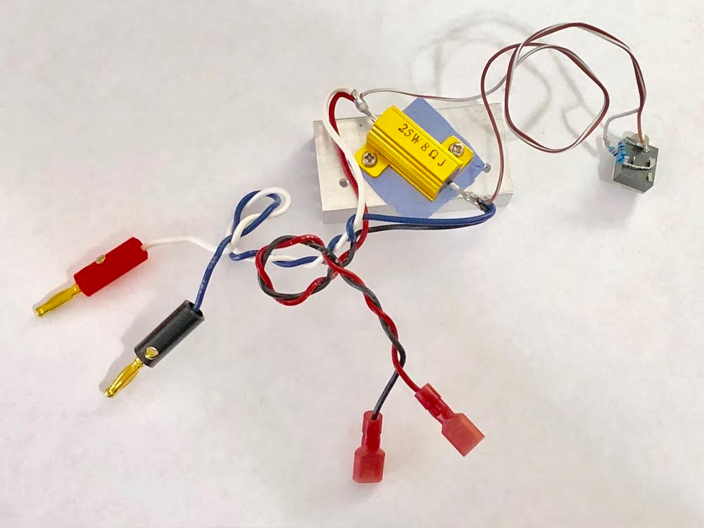

This is all fine and good but how do we measure distortion in our amps? Well we first need to make a dummy load resistor to simulate your speaker load. You need a power resistor with the same impedance as your amp that you are testing. Typically 8ohms or 4ohms. It also needs to handle the amp’s power output. A good one is a metal shelled 25w resistor mounted to a heat sink.
Here is an example of one with the wires you will need to make to connect it to a sound interface:

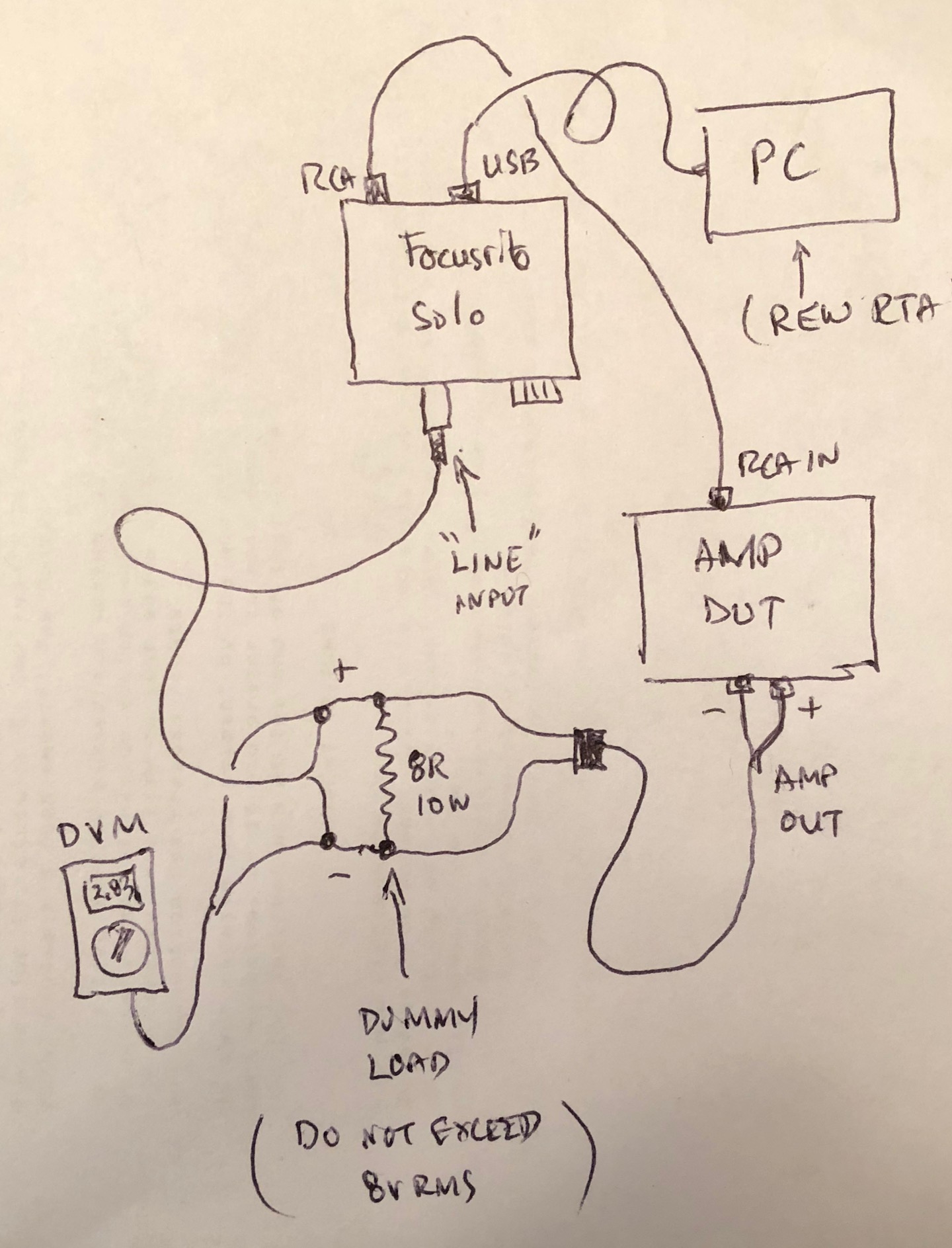

Here is a sketch of how to connect your load resistor to the sound interface and the PC:
759761d1559165648-howto-distortion-measurements-rew-a6089679-b353-4e2b-abd2-b248adb1a49a-jpeg
For measurements of amp power up to 1w (8Vpp) it’s ok to connect the dummy load to your sound card directly. However, if your amp ever had a burp and hits the interface input preamp with too much voltage it can fry the input stage. I would recommend adding a ~10:1 voltage divider using a 20k and 2k resistor and taking the middle node attenuated output as the signal to your sound interface.
Depending on your sound interface, they may be good for 20v max input so that would give you pretty good protection. Never put full 25wrms (40Vpp) into your sound interface unless you want to fry it.

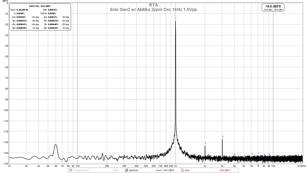

Update June 3, 2019: Here is a loopback using Focusrite Solo gen2 and Akitika 2ppm 1kHz oscillator at 1.0Vpp into 10k:
859503d1594364639-howto-distortion-measurements-rew-akitika-2ppm-loopback-solo-jpg

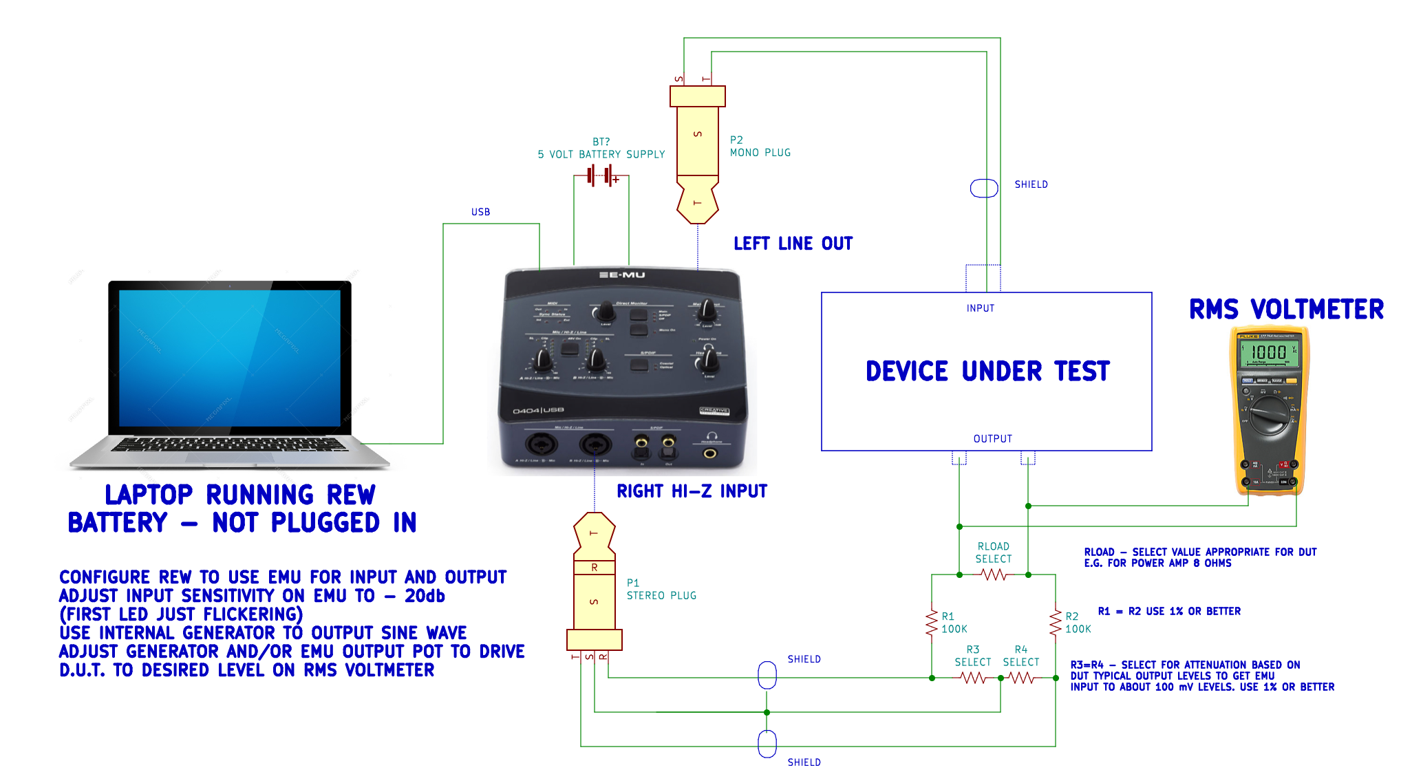

Update Sept 24, 2020: member Wtnh made a very nice and useful schematic and connection diagram for us to use. Although he used an EMU sound interface, a lot of it applies to other sound interfaces as well (like Focusrite, or any other with combo XLR/TRS balanced inputs):
877780d1600788493-howto-distortion-measurements-rew-emu-setup-png

A pic of this wiring interface actually hooked up would clear things up a little for me. Looking at back of Focusrite, I see the USB jack, which would connect to computer USB, simple enough.
Then a standard RCA interconnect goes from one of the two focusrite's RCA to one of the two RCA inputs on the amp/DUT.
That leaves the output on the amp/DUT, and -, the multimeter and the Focusrite line input.
Remaining wires from the interface wiring are 2 banana jacks, and two insulated spade lug connectors......unclear how the remaining connectors are fitted.
Also, what is the small black square thing that appears to hold 2 resistors, which I assume are the 20k and 2k resistors that form the voltage divider? Where do the two spade lugs and two banana plugs go? Sure would clear it up to see a pic of it hooked up, if possible.
Maybe one banana plug in Multimeter and one in focusrite's input? ( cant tell what kind of plug it is from the pic) Two spade lugs attached to matching spades with connectors to the amp/DUT outputs?

Russellc, sure - I will show this all hooked up. The funny little black connector is a 3.5mm female TRS jack. That let’s me use a 3.5mm male to RCA to go to Focusrite input via a RCA to 1/4 in guitar plug.
The banana and female spade let me connect to the amp outputs. Banana for back panel on amp and spade for directbto the PCB amp outputs - useful when amp is on bench and not even installed on a chassis (most of the time my amps have no chassis).

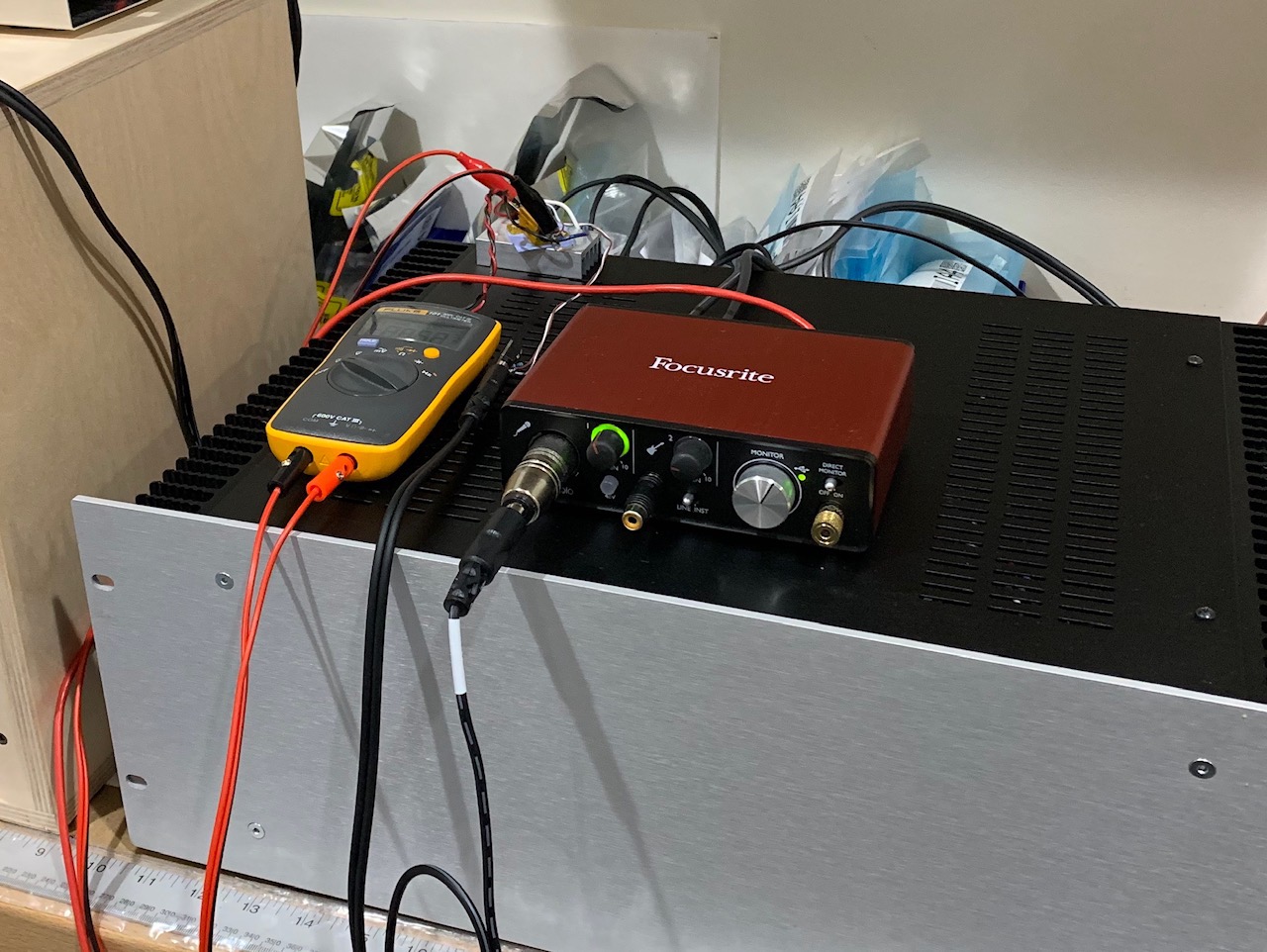

Here is a photo of a typical measurement setup. The dummy resistor is connected to the amp outputs via the banana plugs. The dummy load is connected to a voltage divider which is connected to the Focusrite input via a 3.5mm to RCA cable and RCA to XLR adapter. The DVM (yellow Fluke 101) used for measuring the AC volts is connected directly across the dummy resistor with alligator clips. The output RCA of the Focusrite is connected to the amp RCA in.

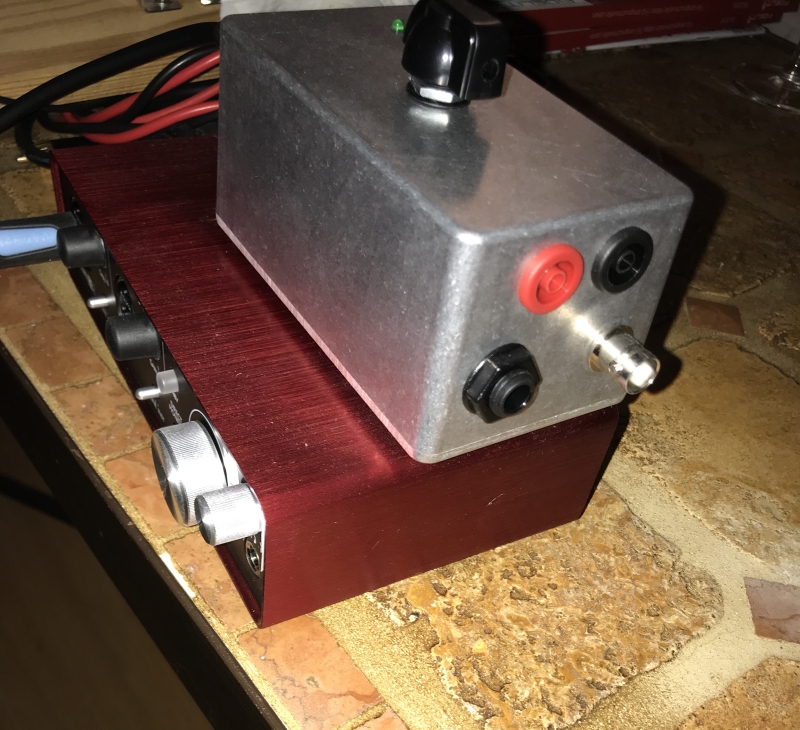

Joined 2016
Thank you for pointing me to REW as distortion analyzer software, xrk971 !
Because I already had the Focusrite 2i2 and a self-built attenuator box (-6 dB to -30 dB in 6 dB steps), and making use of the opportunity that today is a holiday in our part of Germany, I could do some quick measurements of my SissySIT.

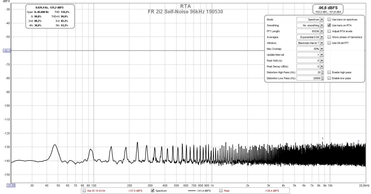

I find REW easier to use than ARTA, which I have used so far. For me (WIN7) the ASIO drivers worked better than the Java drivers - might be because I had used ARTA before and drivers were still loaded at some Windows interface point or another ...

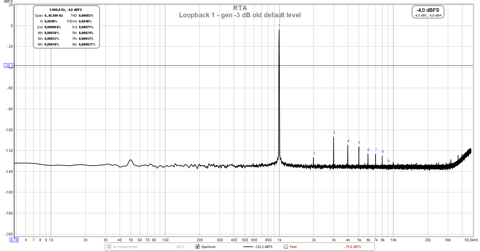

Here is the self-noise of the Focusrite 2i2:
attachment.php
And here the loop-back with the level control of the Focusrite optimized for lowest distortion - that give near to the lowest noise as well. Digital output level is - 3dBFS, analog output level is 0.707 V. These settings I have used for all my distortion measurements so far:
attachment.php
Note also the small 50 Hz hump (European mains frequency). These measurements were done with my laptop and the Focusrite on the sofa, totally battery-powered, no electrical outlet nearby, and no significant current draw in the whole room.:rolleyes: I believe some of the 50 Hz noise I will show on some preamp measurements later is probably pick-up from other equipment nearby or the mains cables in the wall.
Here is the switchable attenuator I built, also using green protection LEDs against overvoltage:
attachment.php
The design of the attenuator I picked up from Dan Joffe. He started it all in this thread:
https://www.diyaudio.com/forums/equ...ment-soundcard-arta-software.html#post5183956
The 1 kHz oscillator (post #12 in the thread above) had already been mentioned in this thread at #9. On the Akitika website, towards the bottom of the page with the 1 kHz oscillator, is a link to a document describing the attenuator. That's what I referred to to build it. ;)
1 kHz Oscillator
All the best, Claas
