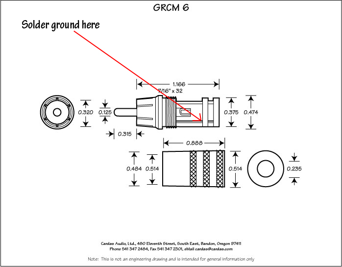

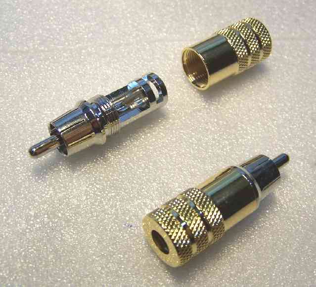

please can you tell me where and how to solder the ground shield and one of the internal wire of a balanced shielded interconnect cable to the ground connection of a Cardas RCA male jack (see attached picture)?

my problem is that I do not know "where" to solder the ground wire on the RCA jack. I tried to solder with the wire passing through the fissure present on the jack, but then I cannot screw the RCA cap (I apologize for my terrible English).

Ok, I understand. The picture is sort of from the wrong view, but it looks like the shell/shield is the cylindrical part with the cut-out. Solder the shield and one wire to it and the other (signal) wire to the center pin (I can't see it in pic, but it's there somewhere).
On the amp end, just solder the one ground wire to the same shield ring and cut the cable shield back so it doesn't contact the metal. A bit of heat-shrink over the cut end of the shield would ensure that doesn't come in contact with the connector shell.

Looks more like the shield is supposed to be screwed together while assembling
Theres an open slit at top
Maybe the shield goes in there

thank you for your suggestions. I had no problems in the past with cheap RCA jacks (it was very intuitive). I verified on the net that most of the "expensive" connectors are shaped like the Cardas RCA I have, with a slot that I also assume is the place where the ground should be soldered. But I found very difficult to allow for the screwing of the connector cap.

just to tell you that a more careful read of the Cardas web site already gives the official answer. Quoting from the Cardas web site:
Q.) Greetings! I just bought 2 meters of Crosslink II interconnect cable and 2 pairs of AGMO RCAs. I just want to inquire how is the proper way of connecting the RCAs to the cable? - Thanks, Ran
A.) Ran, First you must tin the ends of the two Litz conductors. This is best done with a solder pot, but it can work with a very hot solder iron and some patience. Once the wires are tinned on both ends you solder the hot wire to the center pin at each end, then the ground wire to each RCA body at both ends. Last, you solder the shield to the body of the RCA at the source end only.
Some times it's easier to just wrap the shield and the ground wire together at the source end. Cardas RCA plugs tend to need more heat for the solder to flow. The best place to solder the ground is directly under or on the side of the bridge. - Brian

Well, that one you pictured solders like a PL-259 RF connector... you trim and tin the centre conductor and shield, insert, then solder through the slot.
