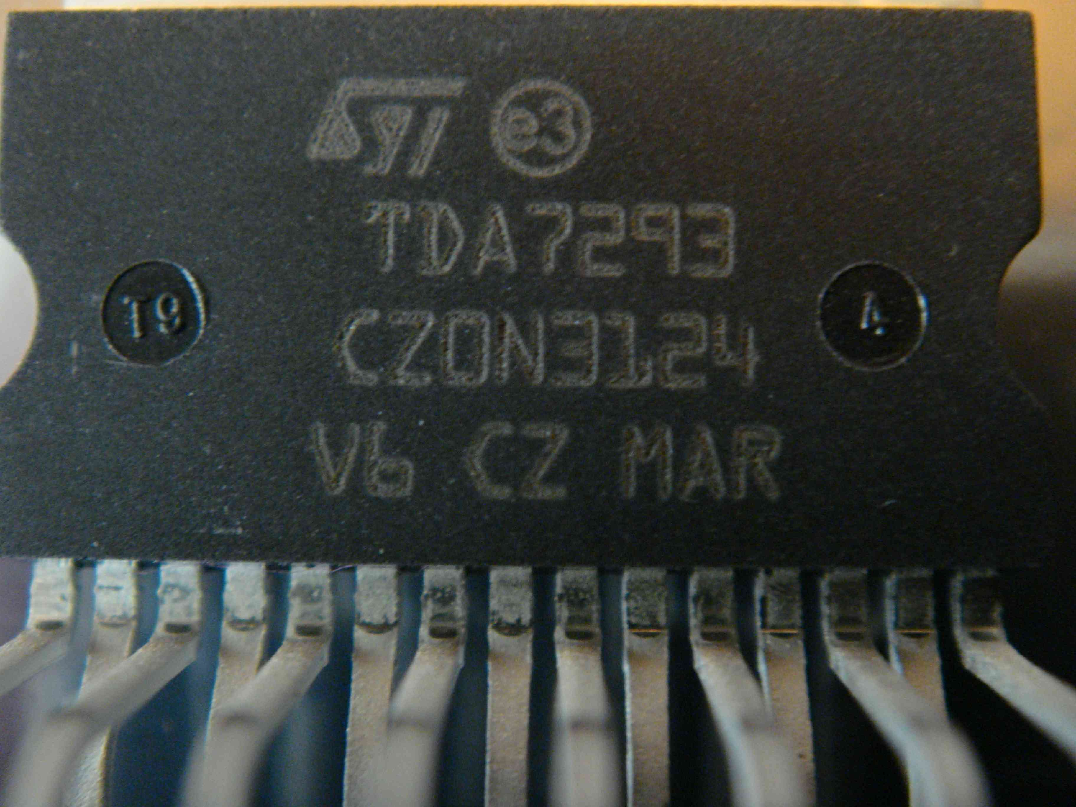

Visual inspection of the suspected device often provides indication of counterfeited devices. Genuine STM device markings are laser engraved while a fake is likely to be printed. STM like most manufacturers nowadays laser engrave the devices in order to combat the counterfeiters. The laser markings often use unique or very distinctive fonts.

Attached is a picture of the genuine device to help readers see the laser engraved IC markings.

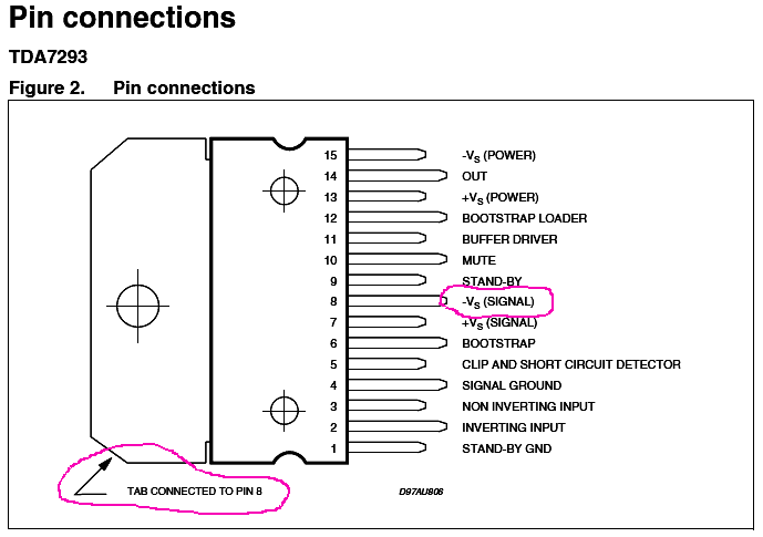

I check a tda7293 for shortcircuit with meter on legs 8 (V-) and metal plate of the IC. And wtf it rings so the metal of the ic has -V and not the ground or its a fake ic?
1) The "tab" is *often* connected to the *most negative* part of the chip. (This is from how the NPN layers are stacked in chip-making.)
1a) This also means you usually can not bolt a power chip to the chassis or chassis-mount heatsink without some insulator.
2) The datasheet clearly shows that "Tab connected to pin 8".
3) "rings"? You mean the Continuity tester? That is for trailer-light mechanics. It does not know a short from a deliberately low resistance. Electronics people go by the *numbers*, not an arbitrary yes/no beep.
