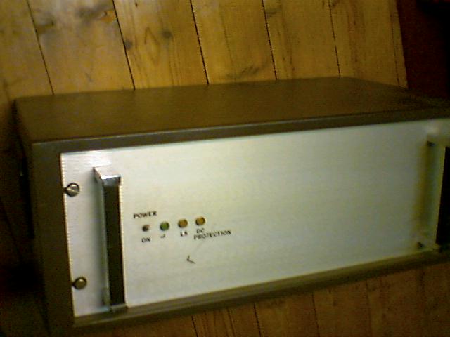

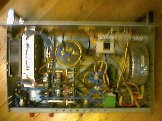

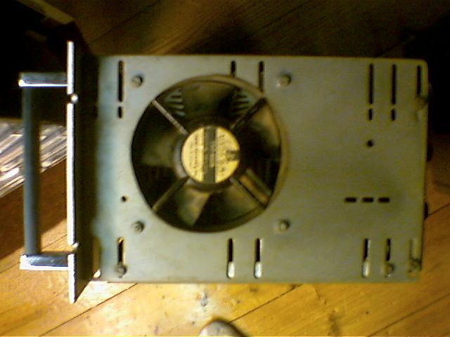

Went up in the attic and made some pics. It's actually the third amp i've build (and the last so far). A picture from the front with a 9v battery for reference. The case is strong, industrial stuff. You can not only dance on the music, but also dance ON the amp 😀 😎

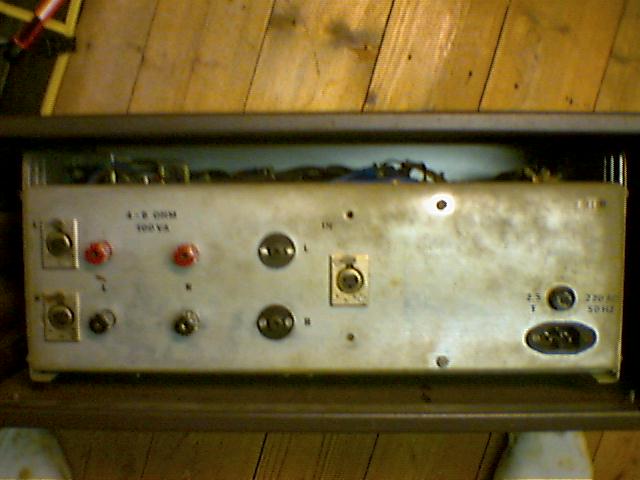

the internals, left to right:
papst fan with the coolingtunnel, underneith it the speaker relay. two 20000uF caps with the pcb's below, two amp pcbs and the dc
protection/delay circuit (also from elektor with the counter counting back from 9 to 0. But i did not implement the led display).
on the right a 500VA ilp transformer and underneith the 'magnet-switch' for mains. you did not think i got away with the small power switch, did you:smash: :clown:
