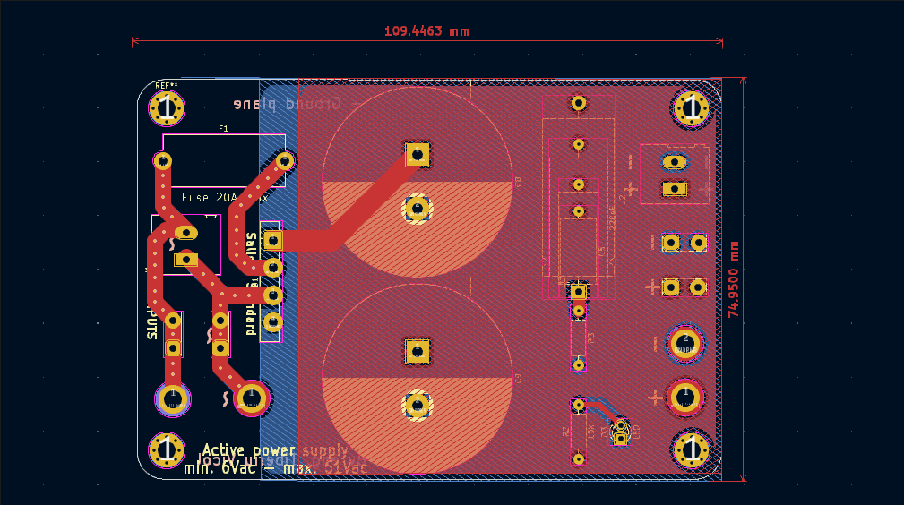

Here is another project.
Two large capacitors can be mounted after Saligny Standard rectifier, so you may add RC or LC filter after this.
Tibi

I have seen the HC Saligny, but even if it's a power amp, I draw only 2A per board.
Thank you for the shorter version, but I prefer something even shorter without fuses, LEDs, caps... as they are already in place.
The Saligny Standard is meant to replace PCB mounted linear bridges with zero effort. I want to do the very same but for my chassis mounted bridges.
Here are KiCad source files for Saligny Adaptor.
You may modify the layout as you wish, but if you use wires longer than 10cm, from this board to your capacitor bank, please keep a minimum 220nF MKP/FKP capacitor on the Saligny Adaptor board.
For continuous current higher than 10A, do not use block connectors, instead is better to solder in/out wires.
Tibi
  • Saligny Adaptor.zip

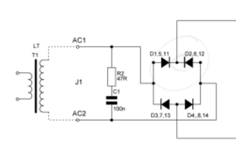

many people recommend me to use c1 and r2 ( like in the photo below) right after the transformer and before the bridge, no matter if the diode bridge or mosfet bridge.
Tibi, what do you think ?
thanks
