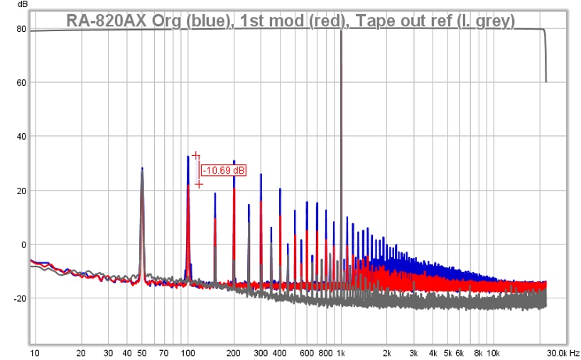

Hi it is me again I have found some graphs of THD+noise in the thread but about the ra971 model
Looking at the various service manuals it is possible to see how the topology has been maintaned somewhat similar at least for the integrated amps
There must be a reason
They have been very conservative considering that the first amp goes back to 50 years ago ?
I do not want to sound trivial but also noise should be addressed For instance i have seen from the lab report some power supply noise clearly passing through
I wonder what an upgrade of the power supply could bring to the table My feeling is that the capacitance in the power supply is too small
uFs re never enough ...
Almost always an increase of uF in the primary power supply caps quality and quantity brings the noise down in a measurable way
The evident peaks before the 1kHz test signal are clearly coming from the power supply and are not suppressed by the amp circuit (low PSRR?)
Imho is impressive what a very low noise amp can do to the musical experience
When the power is not very high i would even consider regulated voltage rails I know this is an added complexity but noise is a really bad beast
The less the noise the better
Could you please direct me to any post containing lab measurements ?
I'm a bit like Saint Thomas. I have to see to believe. And then when I've seen I become a fervent believer
I also propose to make a link in the original post to those pages for those skeptics
I am sure that showing the improvements will bring more people to this very excellent thread
Thank you sincerely and have a nice day

Hi Gino,
It is all too easy to get concerned (read: panic) about things and start changing stuff - when the problem actually lies somewhere else.
I have more than once torn my hair out (and I don't have that much left) over some inexplicable measurement signal (or lack thereof) - only to find a broken test lead, wrong instrument setting or noisy nearby SMPS device to be the problem.
And I, of all people should really know better - my very first commercial project as a newly minted R&D engineer involved an expensive super low noise metal can opamp - which I couldn't get to do anything. Nada. Whatever I tried and checked. Oh no - had I somehow stupidly already blown this $$$ opamp?
So this young engineer of course started doubting his entire education and was ready to hand back the diploma - when as a last resort I tried to pop in a discarded old uA741 that someone had left on the bench. And it worked!
I called the supplier who admitted that B&O had just returned a shipment of the expensive opamp. They had simply cut the can open and found that the manufacturer had 'forgotten' the chip-to-pin 6 bonding wire.
Good advice: Have a regular quality control (double) check of the equipment on the bench before starting a project.
(I probably should start to listen to that.)
Anyway, back to your questions.
1. Yes, I have tried to measure THD+N, my problem is that my Xonar7 measurement setup seems to be super sensitive to hum fields from any mains connection.
I think that I covered that in earlier posts on this thread, but I get 50Hz RTA peaks even when both the amp and the mains wall outlet switch are off. (!)
So neither the power supply or other circuits in the amp are causing this RTA signal.
Pull the plug out of the wall and it goes away, but there is of course not much music coming out of the amp.
You would think that my Fluke or Keithley DMM could measure this 50Hz ac RTA signal, but there is nothing. And definitely no audible hum.
So I have pragmatically decided to live with the RTA trace hum field artifacts for the time being.
Yes, to see is to believe - but you shouldn't believe all you see.

I am quite sure that the 50Hz does not come through the usb. I put in an usb isolator, tried to run it from a laptop on battery power, etc.
And as I said, the hum peak disappears when I pull the mains plug from the wall.
It is most probably an electromagnetic field pickup from the amp mains side. As suggested by sgrossklass, the remedy could be to put an instrumentation or differential opamp before the Xonar7, making its input balanced.
Done right, eg. INA217 can give an extraordinary high CMRR that will effectively cancel any common mode signals on the inputs. I have actually made a protoboard for this, but haven't had the time to try it out yet. I will get round to it someday....
