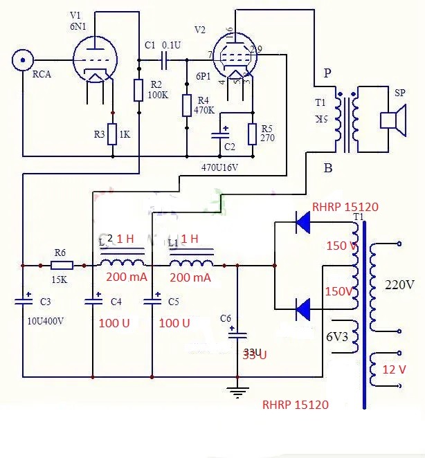

For the choke we know everything -as we don't know the DCR (resistance) of the chokes, power transformer, etc
Triad Magnetics C-24X
Inductor, Filter, Ind 1H, Tol -20%, +50%, Cur 240mA, Leads, DCR 50 Ohms
for the trafo I will measure and inform additionallyCheers
Sorry, it is 2x250 with a cenetr tapWith a center-tapped winding, it will be better to use the full winding with 2 diodes
Thanks, I will try this and will share the changed shema for approvalWhat I would do is 33uF as input capacitor, then 1H, 100uF, then 1H, 100uF.
If you replace the 5H one with a 1H one, you'll completely upset the response of the filter the inductor is used in.A 1H is 5 times as small inductance as 5H.

Do you think a 5 x smaller value has no effect on the equipment? Then why not go to 0.5H, or 0.1H, or zero H and throw out the inductor??
