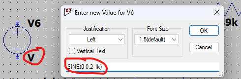

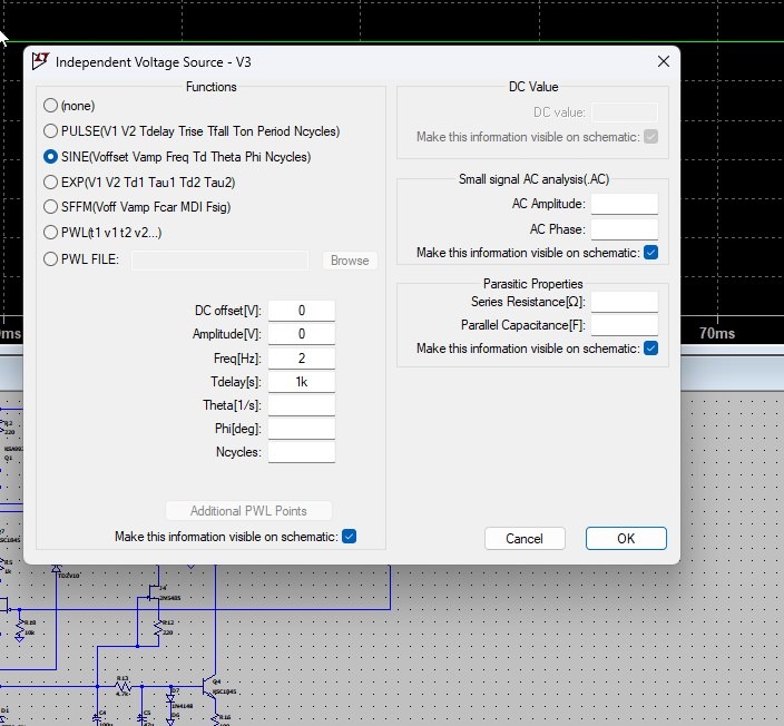

Hi all wish you all the best for the new year as a start.
I have installed ltspice 17.1.15 and find a bug.
When I try to set 0.2 volts 1Khz I get it as on picture. I can not get it right, also not when edit the tekst itselfs.
only delete and set it that valeu works, one time.
regards
