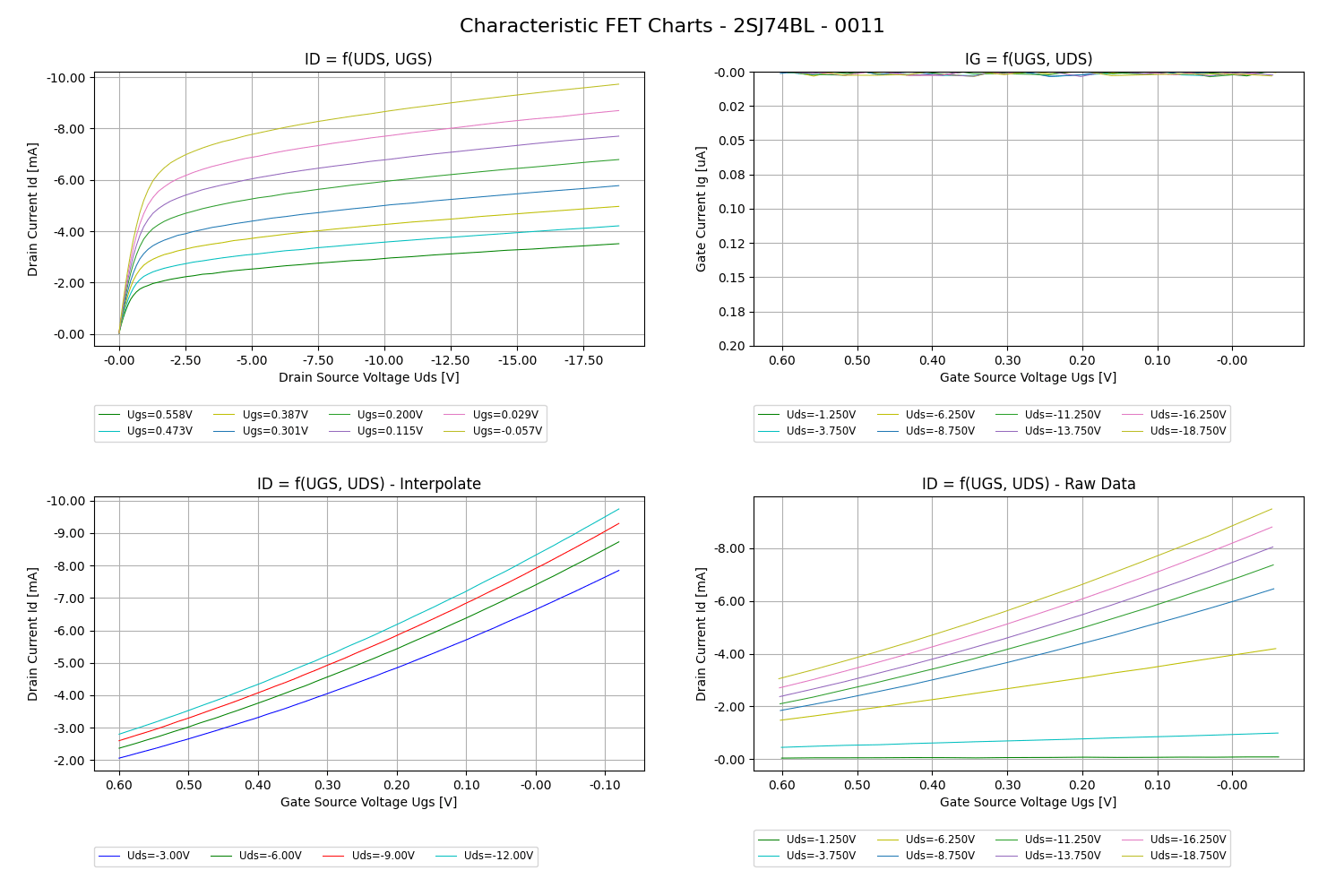

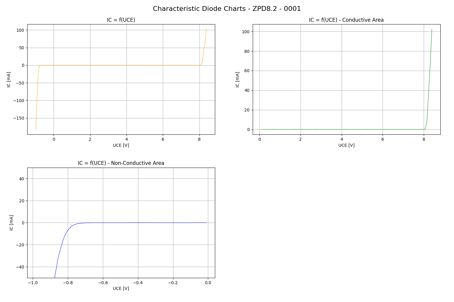

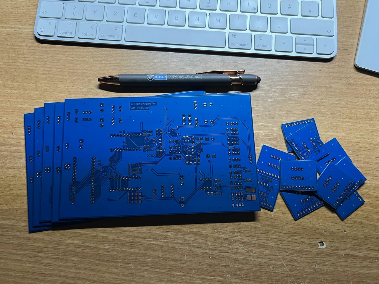

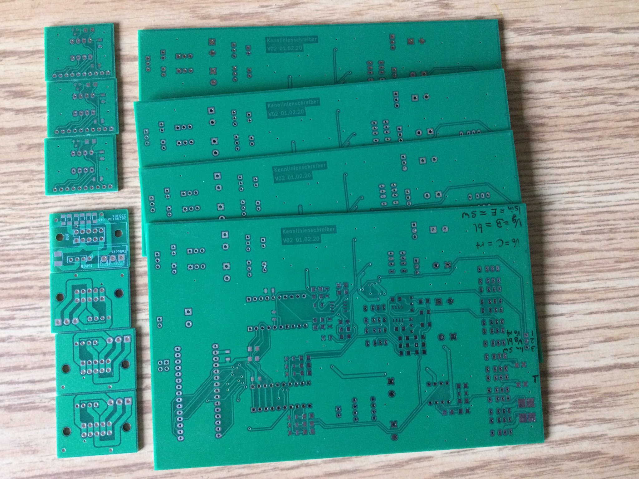

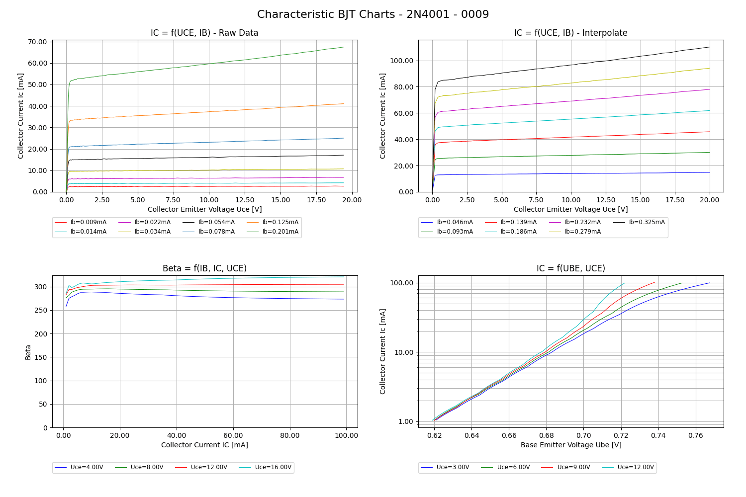

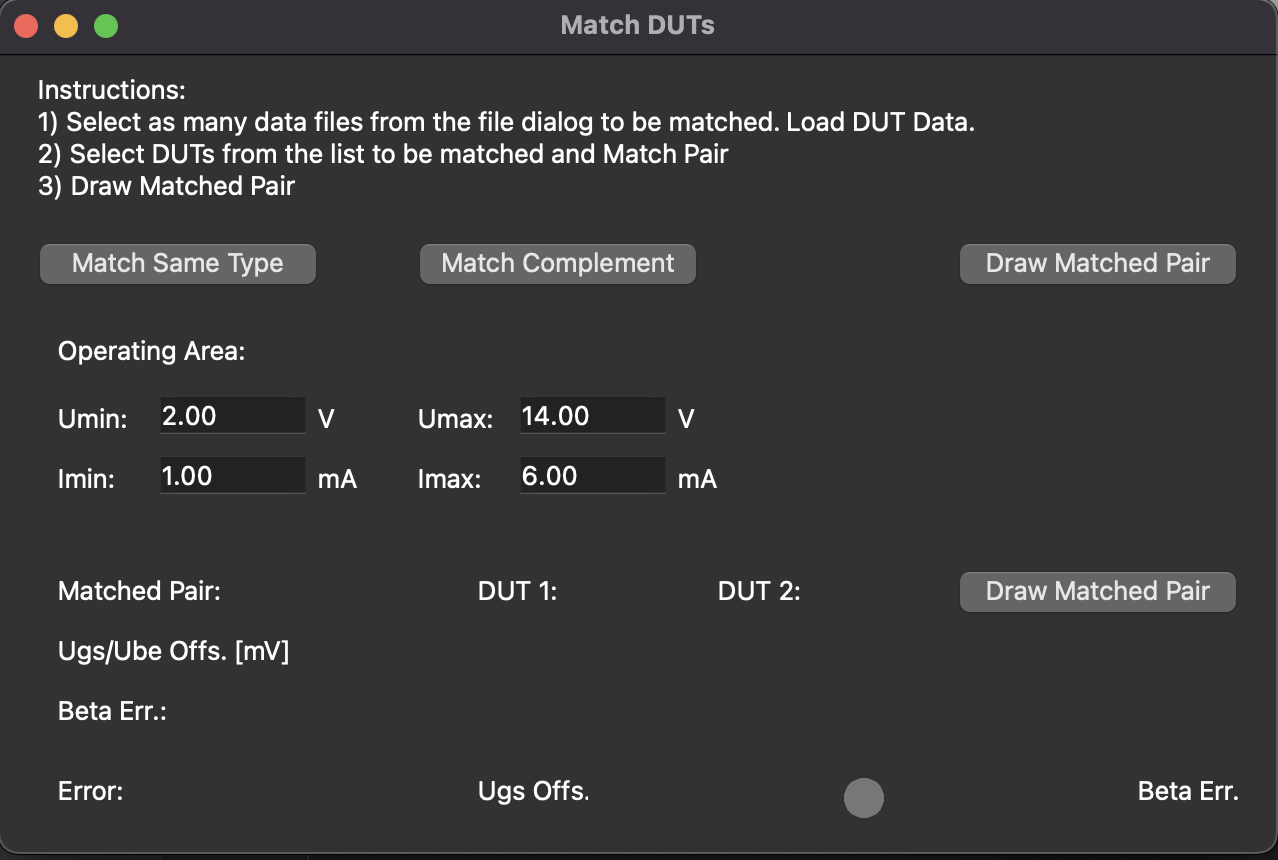

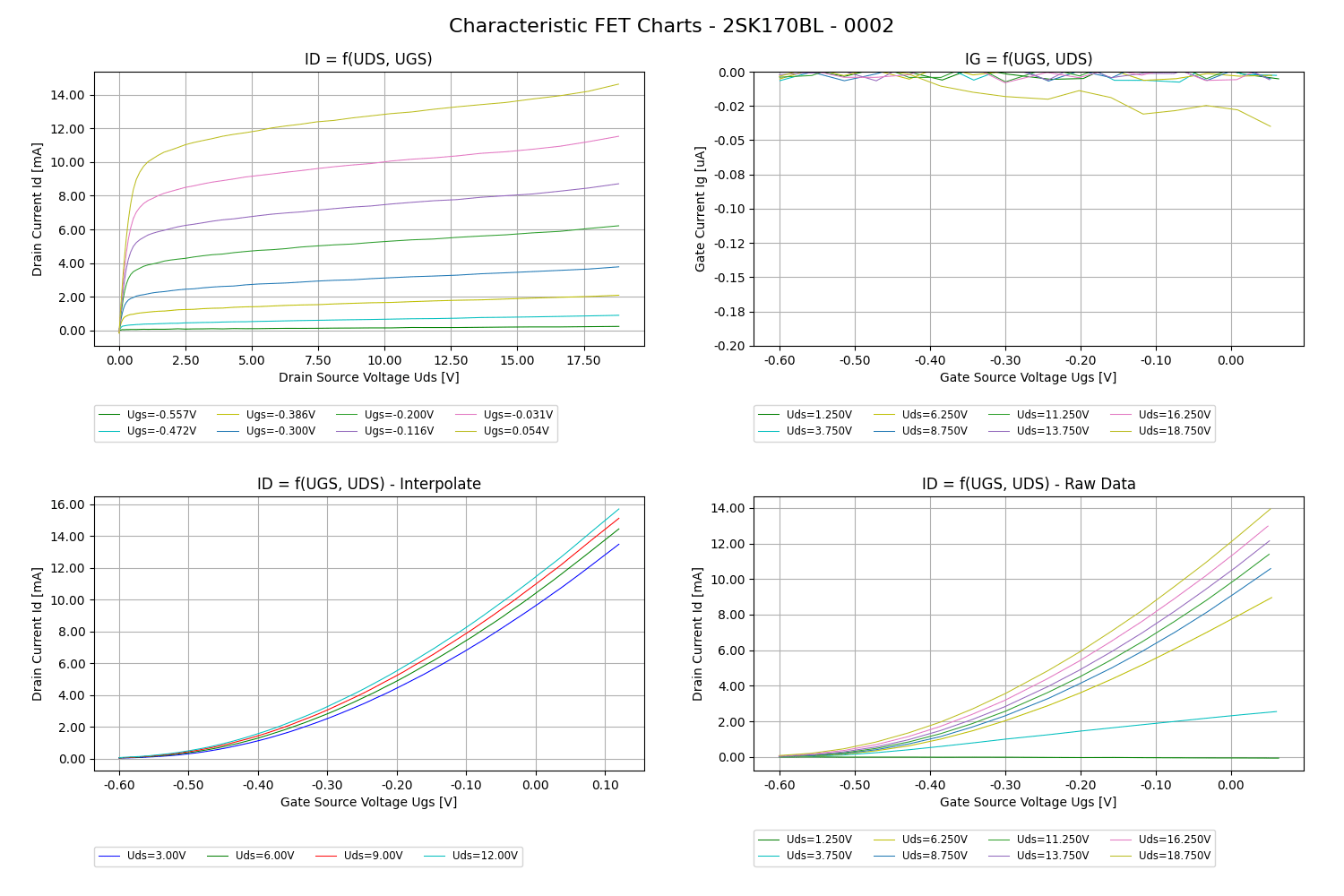

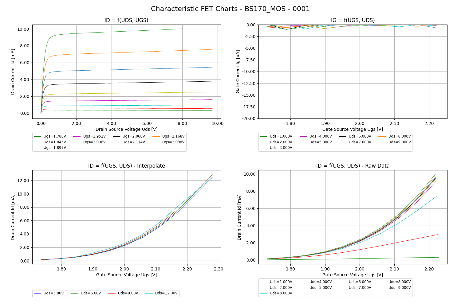

Well, I took the project from Uwe and completely revamped the client software by writing a Python GUI -which btw. runs on every platform (successfully tested on MacOS and Windows). It’s mostly for small signal transistors and it does what it is supposed to do. The software is GNU public incl. all source code. The heart is an Arduino Nano. Firmware source is also available… Drop me a PM if you are interested. In the meantime you can grab the hard- and software plans here. Be warned, only windows and a bit buggy. Otherwise Uwe did an awesome work!
http://diy.ucborgmann.de/index.php/en/audio-messtechnik-2/characteristic-curve-recorder
Some curves from my GUI attached. It also has a rudimentary matching function (incl. complementary pairs).

I see TubeKiddo!
First glance of schematics, it seems to me a 'refined' design. For instance, using a 3uV OpAmp to 'fabricate' a kind of isolated digital ground apart from analog one.
So, you have contributed in the design programming the python code you showed me at the pics. Nice GUI, BTW!!!

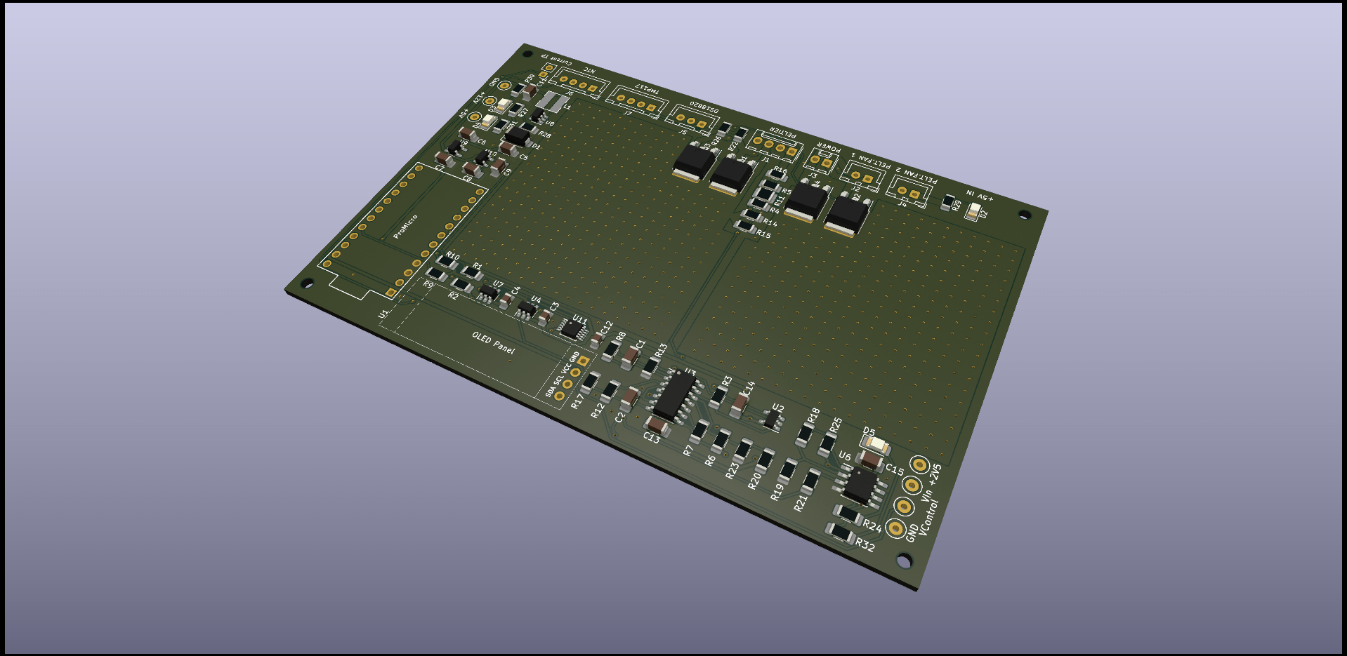

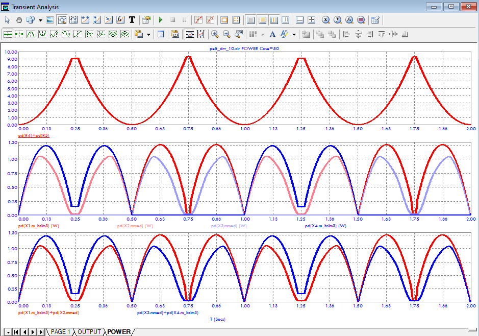

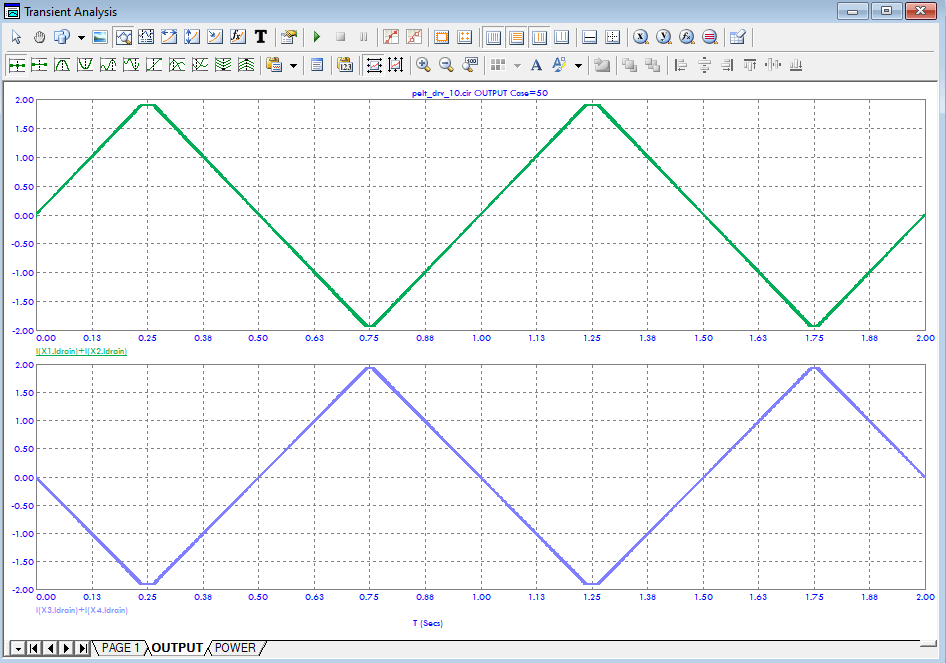

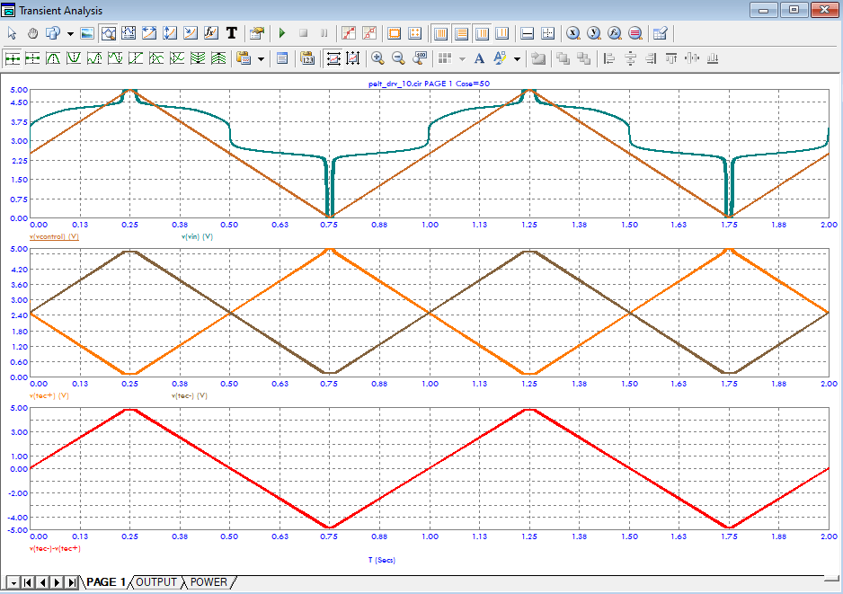

Attached, it is the PCB design based in a double push-pull stages, 16 bits AD, 12 bits DA, precision current generator (For tracing NTCs, this is the original purpose) and 5V 2A (Reversible and continuous) hot-cold peltier stage.
Also, some SPICE curves showing linearity from -5V to 5V Peltier feeding. Power supply is only +5V due to the Bridge Tied Load final stage without zero cross distorsion.
