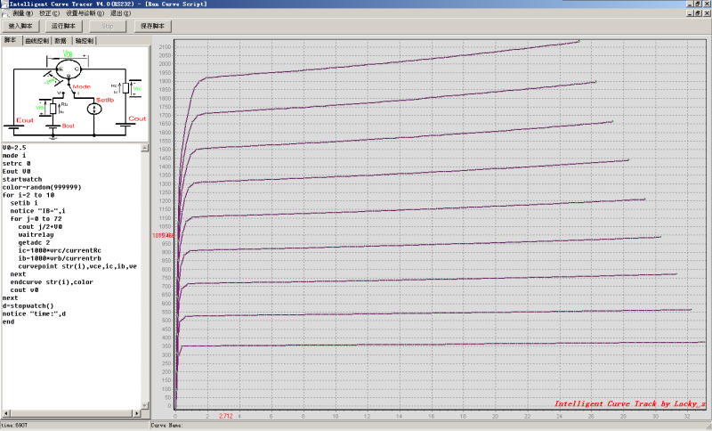

It support script control,
Example use script to measure a cluster of Vce-Ic.
attachment.php
The script is
V0=2.5
mode i
setrc 0
Eout V0
startwatch
color=random(999999)
for i=2 to 10
setib i
notice "IB=",i
for j=0 to 72
cout j/2+V0
waitrelay
getadc 2
ic=1000*vrc/currentRc
ib=1000*vrb/currentrb
curvepoint str(i),vce,ic,ib,ve
next
endcurve str(i),color
cout v0
next
d=stopwatch()
notice "time:",d
end
Ib from 2mA to 10mA,9 curve ,and spend time 6.9s

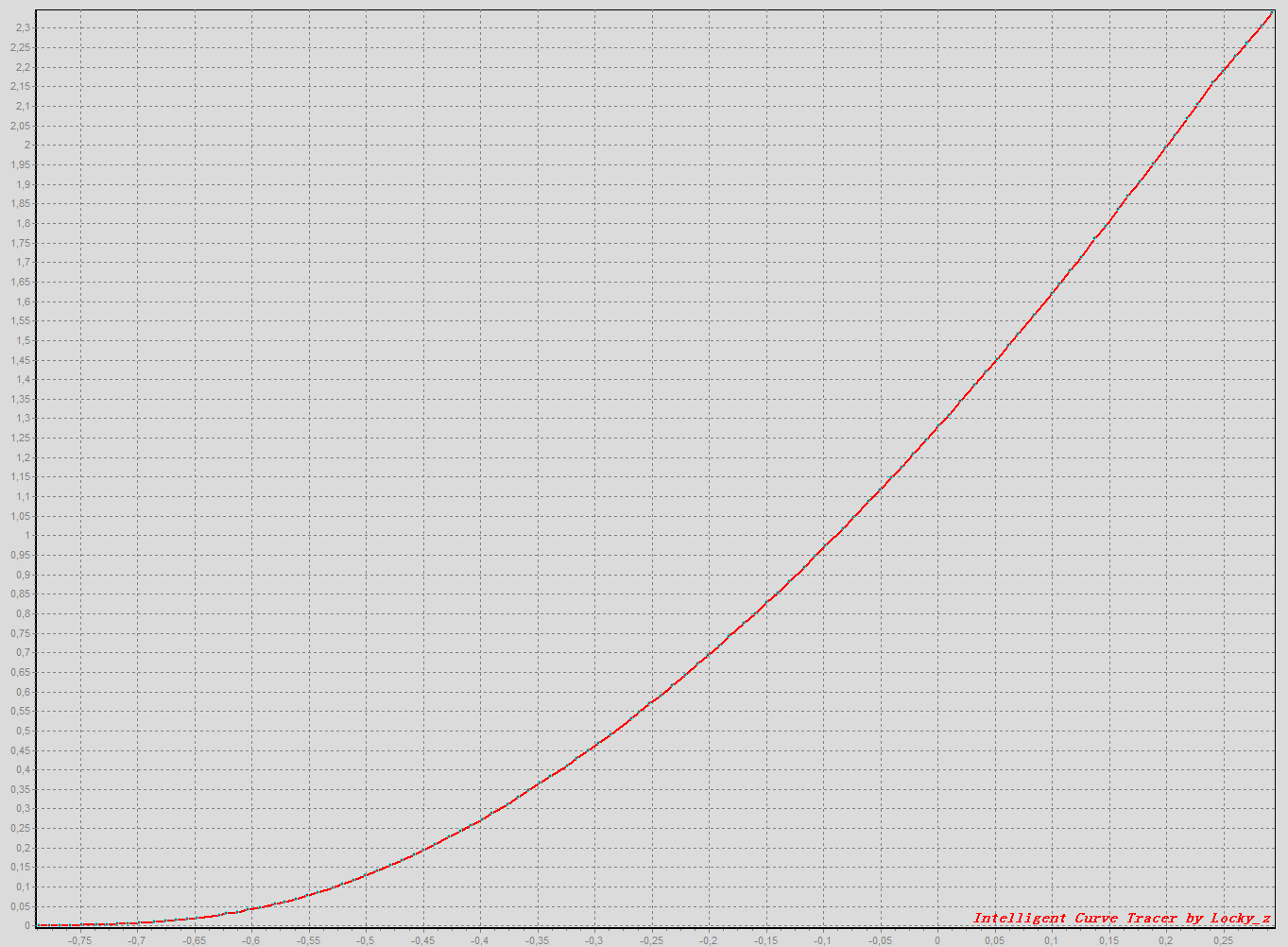

1. I try measurement npn, pnp and n-fet with varios tamplates. And always the same result - one point.
2. DUT pins woks, type of elements is defined, but the measurements are not valid, for example, the drain current for 2SK170 is 663mA when the maximum possible is 16mA, and measured Hfe for 2SC1815GR is 118, when it is in the datasheet 200-400.

May be the decimal point in ads7871_v3s.ini file caused,
In some non-English windows, the decimal point is ',' instead of '.'.
You select menu 'Options->config'
Check what is the ‘B/C/E Channel PowerAmp Gain’ display? They all are 4.11.
If not 4.11, it mean your windows system read '.' not as the decimal.
Use notepad to open the ads7871_v3s.ini, and replace all the '.' as ','
In INI file on CD that you put in the package, all the gains values are 2.
First, you write that the separator should be ".", And then say to replace all "." to ","... I enter a value through a point, but after opening it changes to a comma.
Ok, so it works! I ran the new version without the old ini file. :)

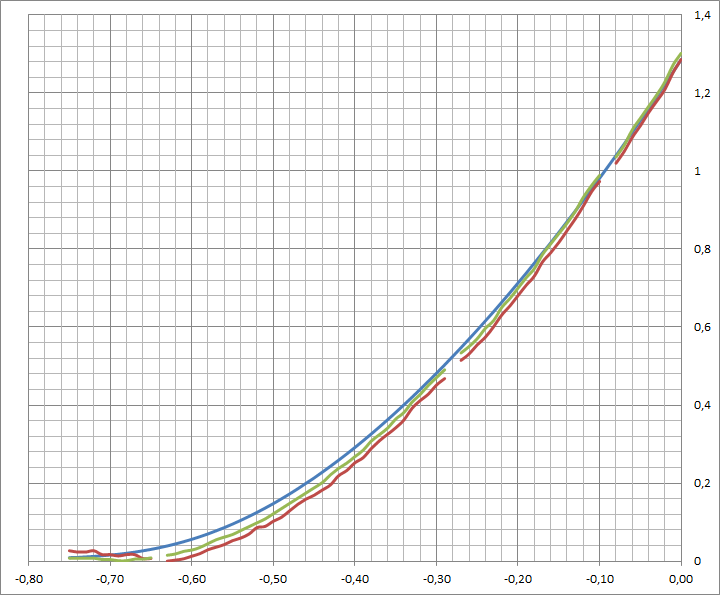

A year ago, I was working with I/O board manufactured by National Instruments and measured some Soviet FETs. To do this, I was written in LabVIEW similar curve tracer. Unfortunately, your algorithm is in the manual in Chinese, so I can not compare it with mine. But I can compare the results.
Blue is measured with NI (how much is average, I do not remember)
Red - with tracer with averaging 10 times
Green - with checkbox "Calibration" and averaging 66 times
JFET was n-channel 2P303A

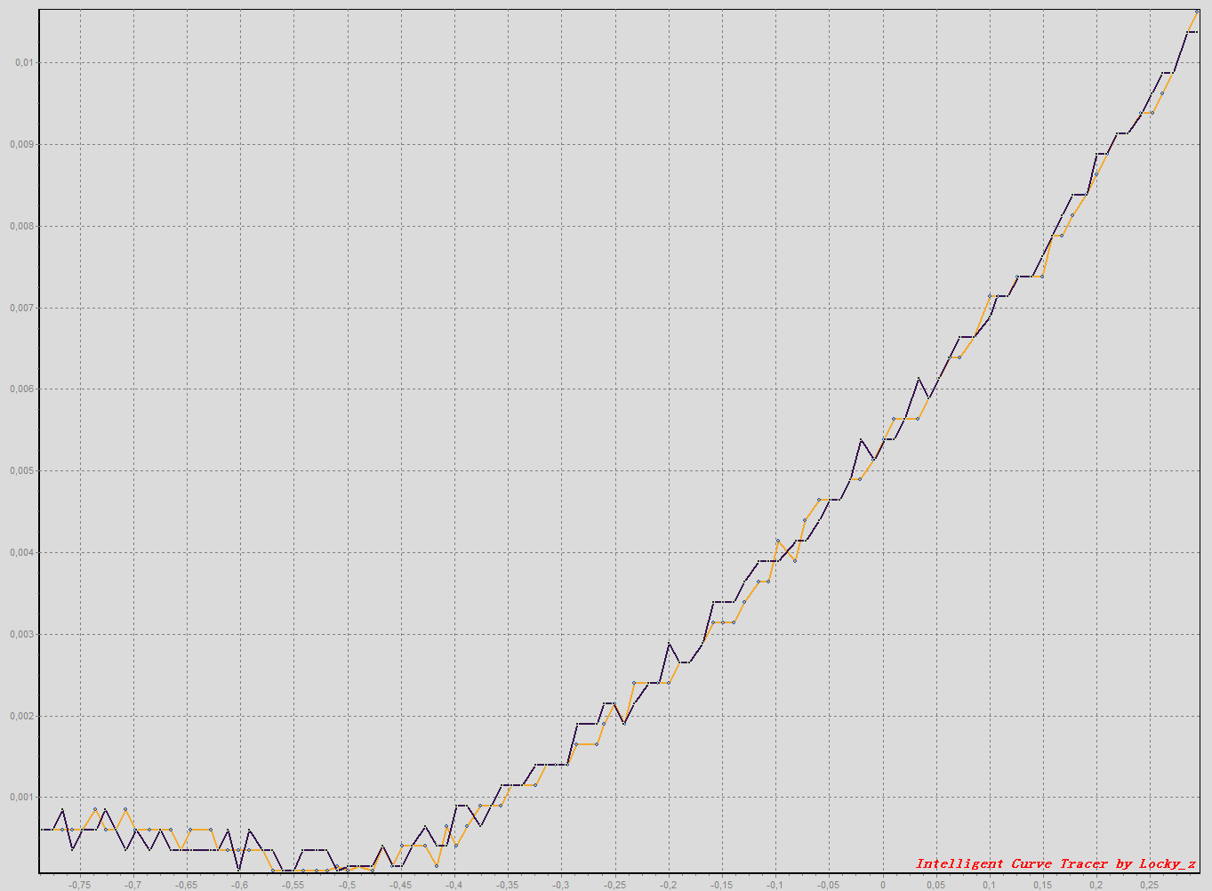

I think that the curve tracer is noisy and suitable only for qualitative screening and selection. To measure the quality of a semiconductor, such as the homogeneity of the slope, this unit in this version is not suitable. Need to work on the noise level. Or am I doing something wrong?
And where are points with the gate voltage -0.09, -0.28 and -0.64V?
My instrument is difficult to distinguish within 2~5mV voltage.
So the Vgs-Id/Vbe-ic curve that Vgs/Vbe less 1V is limited accuracy.
For your J-FET measure , you use RC=1K or 12K?
Because your Id is less 1.5mA, If you select RC=1K,
On Id=0.2mA position,The Vrc(Voltage drop of RC) only 0.2V,If the resolution of my curve is 5mV, On this position, Means that the Id error will reach 5/200=2.5%,
If you select RC=12K, then on Id=0.2mA position,The Vrc(Voltage drop of RC) is 2.4V, Means that the Id error only 5/2400=0.2%.
Select big value RC, can get more precision, but you must remember, The Vds(Vce) + Vrc must less 36V. Because 36V is the power supply limite.
