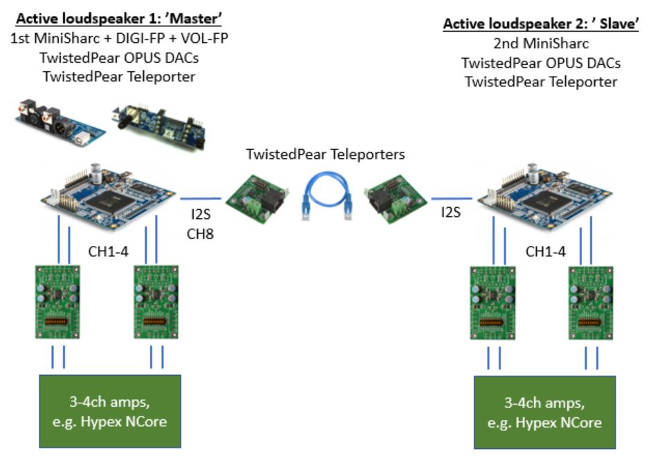

I'm currently designing an active 3-way stereo loudspeaker pair with a MiniDSP MiniSHARC, Teleporters and Opus DACs.
Anyone have experienced with connecting the MiniSHARC I2S output lines to a Teleporter and passing them on to an another MiniSHARC? See the proposed connection scheme in the attached image. The MiniDSP devteam asked to verify that the Teleporter can work in I2S Slave mode with the MiniSHARC. Should it work like this?

No this device doesn't do any SE to Bal conversion, it does buffer, isolate using differential pairs, transmit. No common ground unless you want it via closing jumper J2 AND using a shielded cable.
Not sure that's quite right. These take digital clock and data signals that all share a common ground and convert them into up to four differential balanced low voltage digital pairs over eight wires in twisted pairs for robust transmission over up to several hundred feet. The receiving end unbalances and buffers the four signals providing a new common ground replica of the original signals. So connections both into and out of each are single ended digital clock or data, but the transmission is in fact balanced. Sort of the whole point of the things.

I've never really bought into the I2S line length thing, except for keeping them short to prevent noise.
Timing-wise, it is not really an issue... electrons move pretty fast. Traversing transistors (logic gates, etc) can be an issue with timing, but for wiring, I would keep them as short as you can and away from power/gnd leads and be happy.
I am buffering eight channels of I2S with four Teleporters. It would be very convenient to stack them and buss the clocks, power and grounds. Of course this would create a different length signal path to each Teleporter...or should I star equal length wires from the multichannel XMOS to each Teleporter?
Thoughts?
I have done such a buss arrangement and it worked fine. As Brian said, the main issue with I2S is wire length (short as poss) and positioning away from interference.
BTW you only need 6 lines for 8 channel so you only need 1.5 Teleporters each end to do this - unless you are feeding multiple DACs that can't be positioned closely of course. I attempted the latter but ran into problems with interference when lights/washing machine/dryer etc were switched on/off (even with shielded cabling). I eventually gave up and use AVB over Ethernet instead (which is far more flexible - you can run it over an existing network). Unfortunately AVB never took off as it requires special Ethernet switching to prioritise real-time traffic, but I still think its the best DIY solution out there for transmitting high quality audio any distance (Dante is expensive, proprietary, and DIY modules aren't reasdily available)
