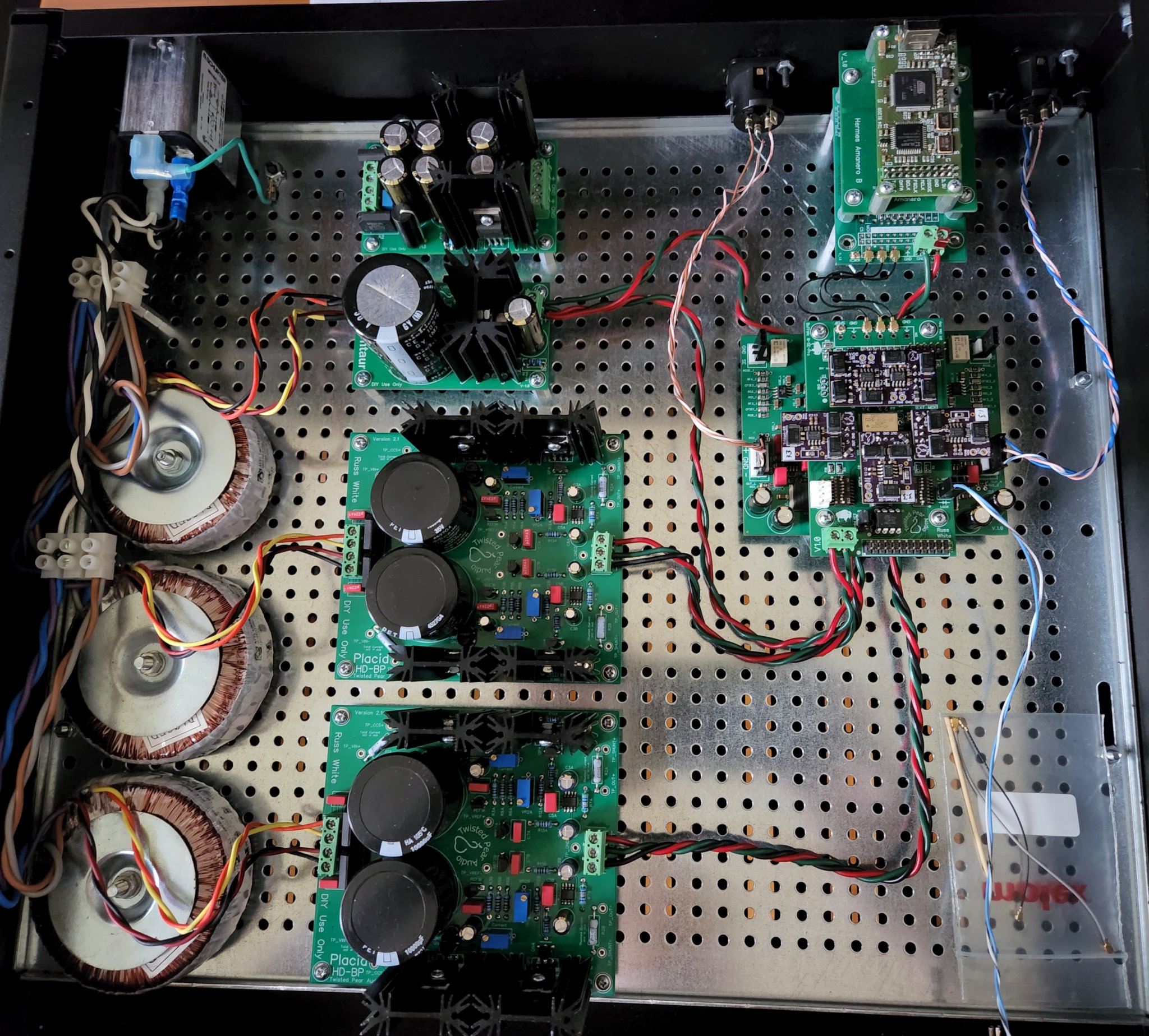

Greetings folks. I can't get my BIII SE Pro 9038/Mercury to run in synch mode. Not even a flicker on the lock LED. Works and sounds great in asynch, just want to try synch. (My prior 9018 setup sounded better to me in synch). Now it's kind of a challenge put to me....lol Current config pictured.
Prior, the LCDPS powered the Hermes-Cronus boards, Amanero (TP firmware) powered via USB cable from source and the 9V 30VA transformer secondaries were split to Centaur and LCDPS. Now both secondaries are connected to the Centaur which powers BIII SE and Hermes-Cronus, set at 5v.
PCM to DAC, no DSD.
I tried two different 3" Ufl to connect Cronus to BIII XO. XO regulator removed. Cronus divider set to 1/2. 45.1584/49.152MHz Clocks.
I tried a switch between DAC and Centaur power, powered Hermes Cronus then switched DAC board on. Tried different DPLL settings doing this, powering DAC down, pull USB cable and restarting after dip switches reset.
OS enabled, tried disabled. PCM format I2S, 32 bit, automute enabled, IIR 47.44K, various DPLL settings (I am aware 5 is the low bit), all off (0000), all on (1111, 0001), etc.
Any other suggestions? Thx...

I went through this same thing a few months ago. After much frustration I finally got Sync mode working with stock firmware. I have DPLL set wide open, that is (1111). Try different clock divider settings and make sure the DAC is fully warmed up.

I pulled the Amanero Hermes Cronus. I'll purchase new XO's for it and look the boards over and try synch again.
I have a discontinued Sonore Audiobyte USB interface in there now. It was/is a highly rated USB interface. And it works in synch mode with my BIII SE Pro 9038.
Roon recognizes the Audiobyte as an unrecognized I2S device though. That means no native DSD option is offered in Roon. We can change firmware in Amanero so Roon recognizes it as a native DSD capable device, but there is no firmware support for the Audiobyte to do that.
