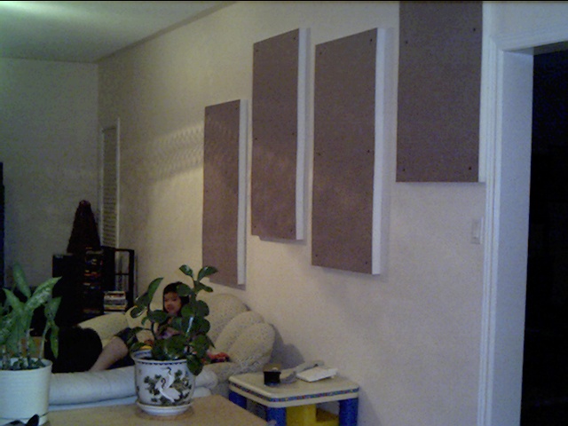

I am using 9 of these foam panels measure 24"X48" each, placed 4 as in the picture, 2 in the front wall above the TV screen, and 3 on the other side wall.
Got into big trouble with the wife, but she accepted the fact that when I told her she sound better in the room when yelling at me.😀

Brian,
These panels come as is. I like this one is because it has a fine carpet like surface and different colour to chose from (mine is rose pink) others are just gray or brown.
It has been more than two years now, once I dig out the paper work I'll post it, I found it on the web. I remember it came in 2 boxes, 6 pieces for each box, I imported it from the State, it end up costing me just around $110cdn each including shipping.

FOAM
Brian,
Lost the invoice, but found the site, the ones that I am suing is the 2 inches thickness and pink rose since my walls are painted in dusty rose.
Here is the link to the ones that I ordered.
http://www.illbruck-sonex.com/pdf/p_sonextextile_panels.pdf
It was cheaper to buy it from Illbruck than Sonex, eventhough it is Sonex product.😕
Happy shopping,
Chris😉
Notice the corner in the picture posted above there is a 50" tall shape like a christmas tree corner treatment to absorb bass. It really is just a wire mesh for tomato plants, cover with a neated blanket of wool by my wife of course and inside the mesh are all my old clothes like soft sweaters, jumpers, T-shirts stuffed full from the ground all the way up to the top...It is a cheap alternative than a tube trap. I have one in each corner. Before I put this up in the room I always complain there was not enough bass and it was very soft if any, normally corners enhance bass, but for my room the corners seems to cancel the bass badly. Now is much better defined.
For you folks want to deal with DIY foams please consider their fire rating, some can be deadly or easily caught fire and release deadly smoke. Do not just use any foam... check please..
