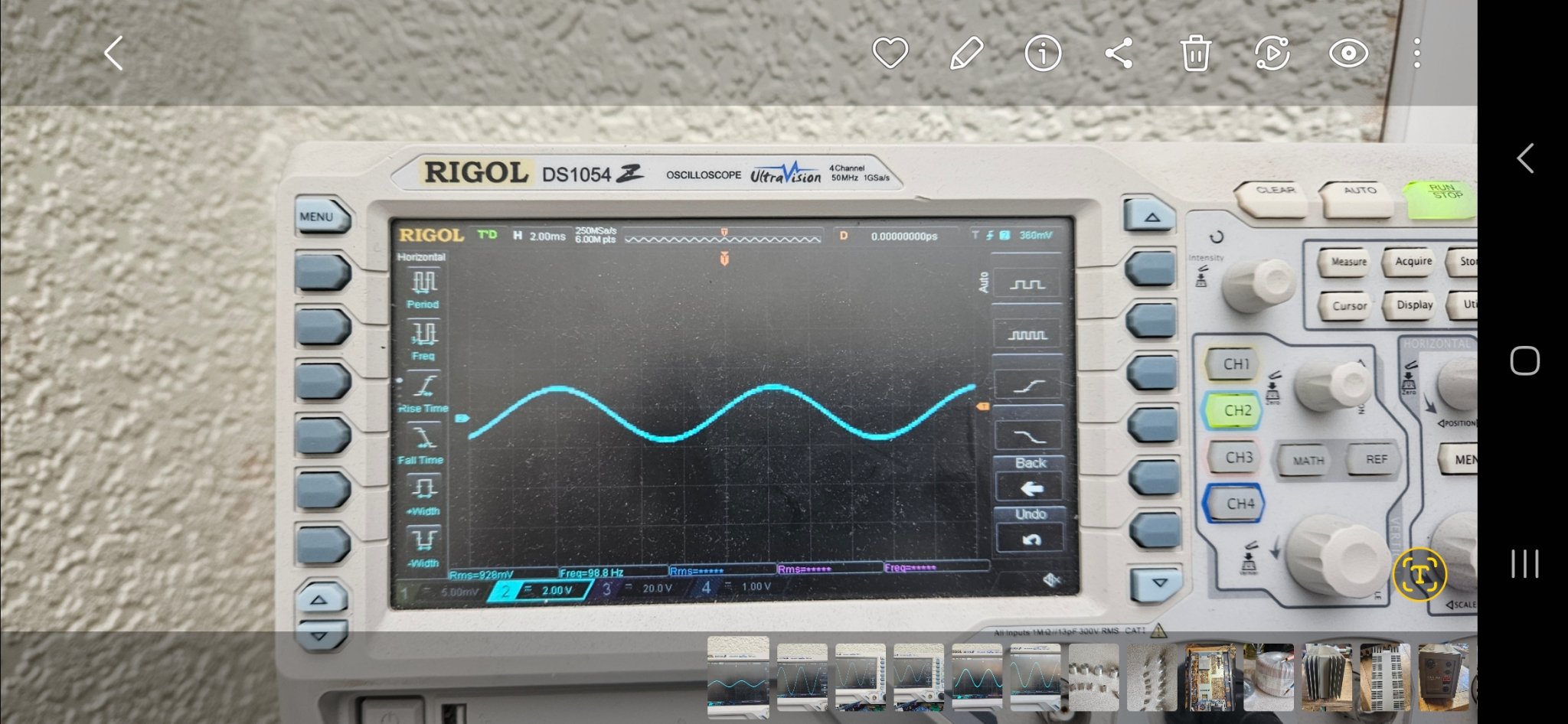

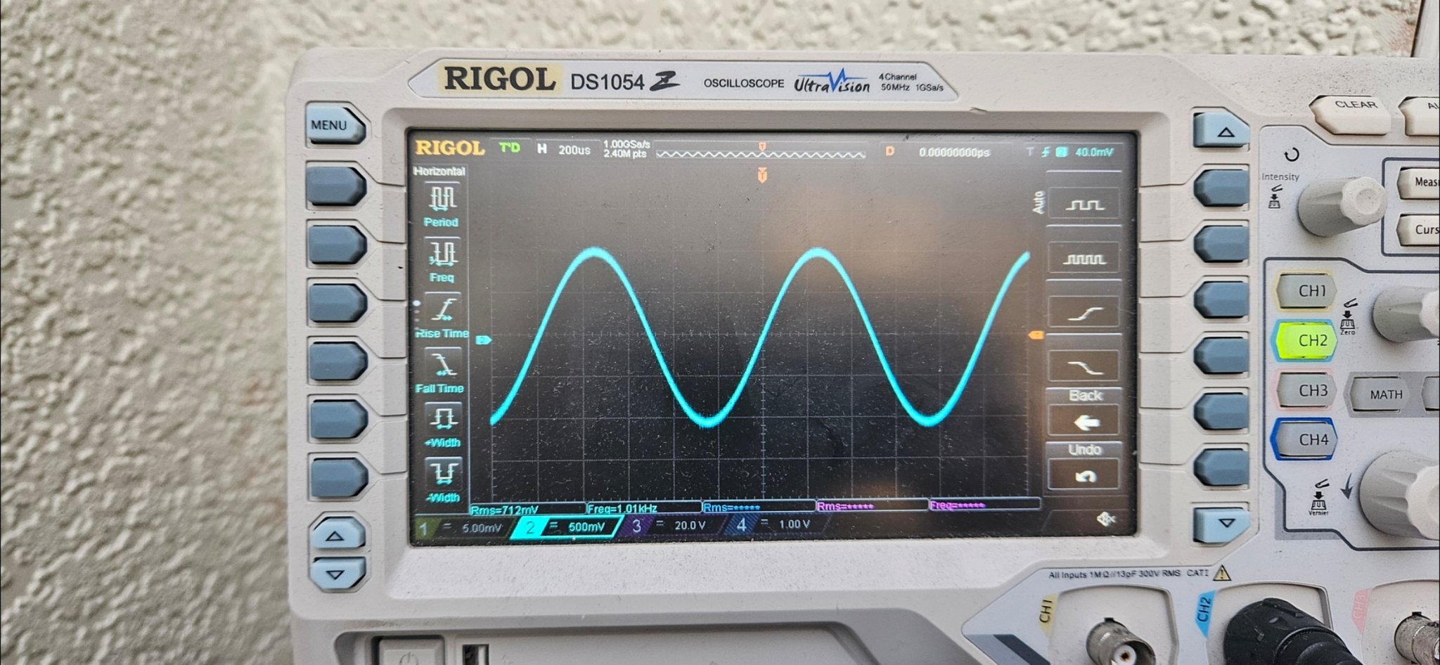

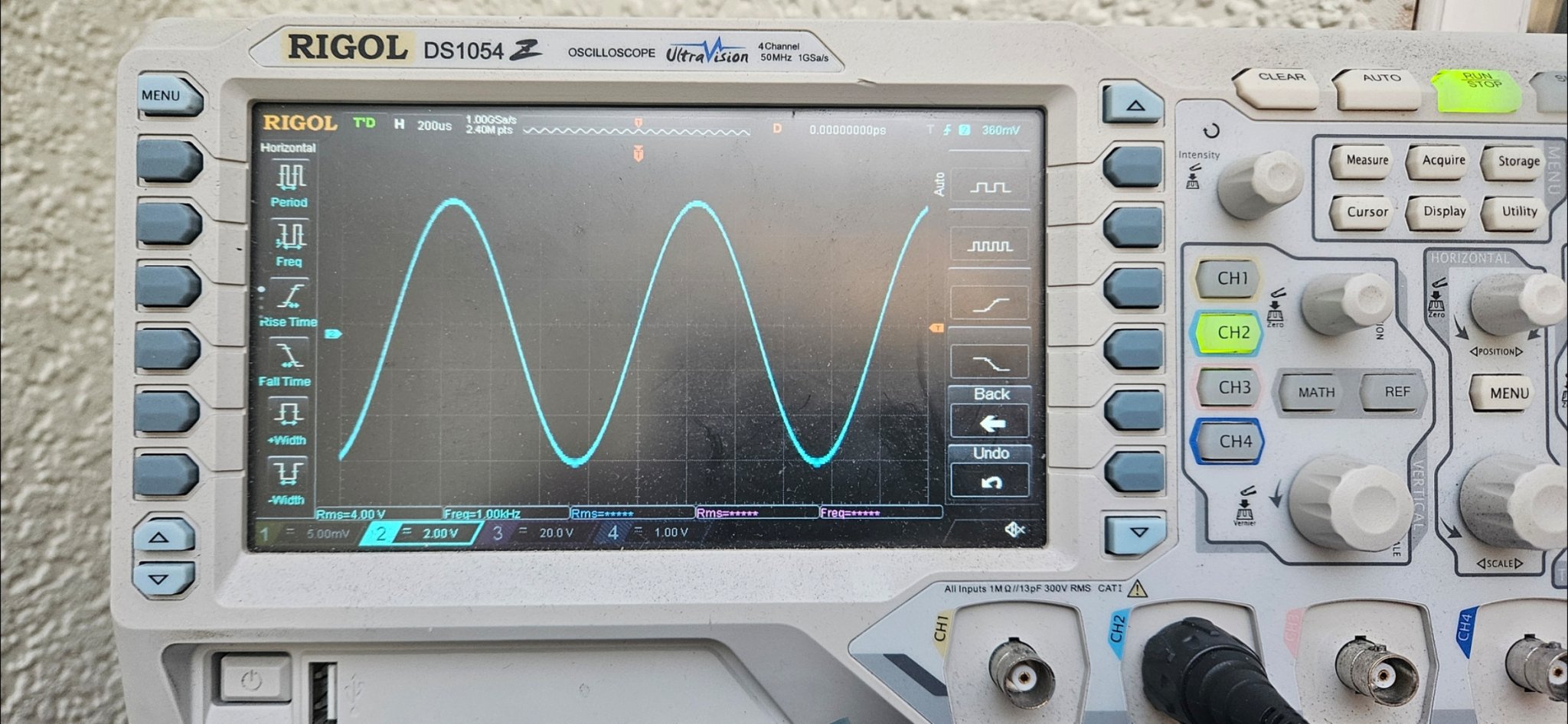

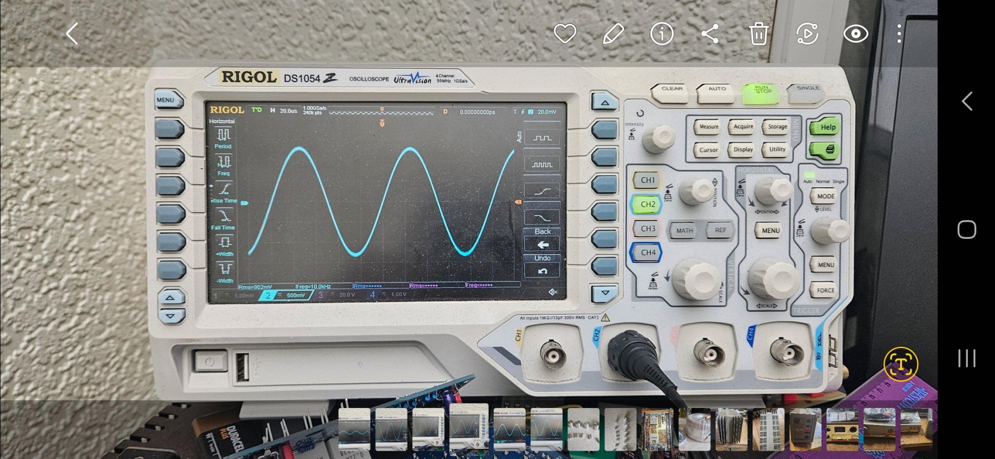

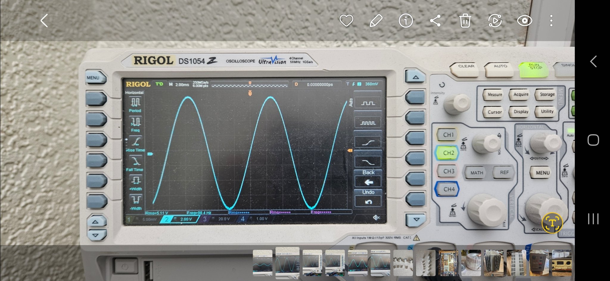

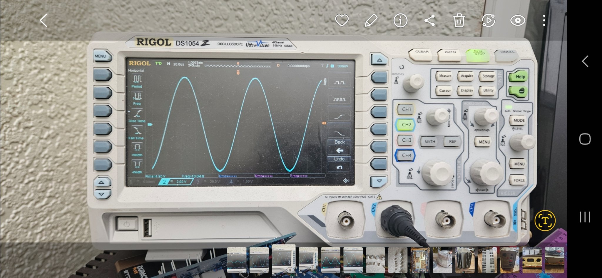

I found a broken solder joint on C1 fixed that and voltages are as follows, A denotes other channel, amp was on a dim bulb limiter incase of slip ups
C1 / C1A - 21.6vdc
Tr1 / Tr1A Base - 21.6vdc
Tr1 / Tr1A Emitter - 22vdc
Tr6 / Tr7 - Emitters - 27.5vdc
Tr6a / Tr7a Emitters - 27.7vdc
One channel output still much lower than the other 4v AC vs 0.5v AC measured at speaker terminals
The noted DC voltages may be slightly low, but not by much.
I'm not sure what you're telling me. Is the 0.5v AC indicating low audio gain? Please clarify what your measuring and how.
If the signal gain is low, inspect the R9 and C5 path for possible failed parts or faulty soldering or PCB traces. R9 and R10 set the signal gain at about 1+R10/R9. i.e. about 38 V/V or about 31.6dB. Of course, failed C1 or C18 could also give low output.
If I understand, the problem remains in the PA and is unchanged.
Try the following, using x10 probes: Note AC amplitude at generator output, and compare at C2, base TR1, emitter TR1. There should be very little change in AC amplitude at any of these three points. Measure directly on the R9 resistor lead that connects to C5: you should see same DC voltage as emitter of TR1, but there should be no AC signal present since it should be shorted to ground through C5.
Assuming results are as described and that there is clean sine wave with correct bias (about 28.5VDC) at the amp output, the problem would appear to be defective resistance value at R9 or R10.
Good luck.
