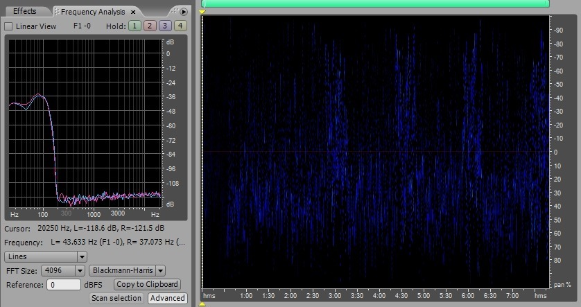

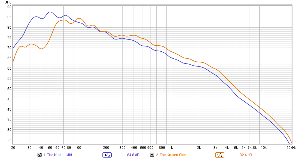

Here is what I see. This is not the whole track, it's about 2 minutes out of the middle. It's very high in stereo content, but we can see that it's summed to mono under 60Hz. Maybe they were expecting an LFE channel.Analyze "The Kraken" by Hans Zimmer.

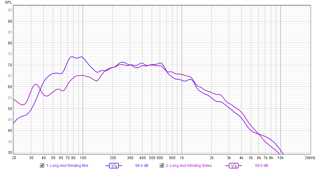

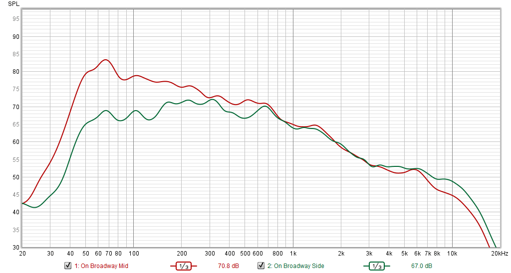

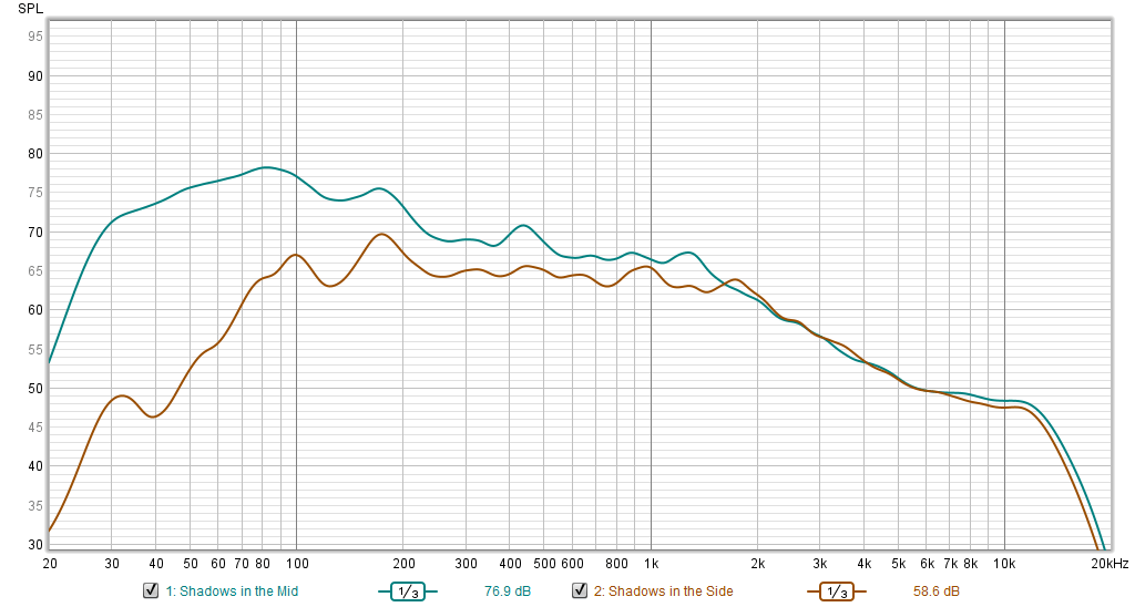

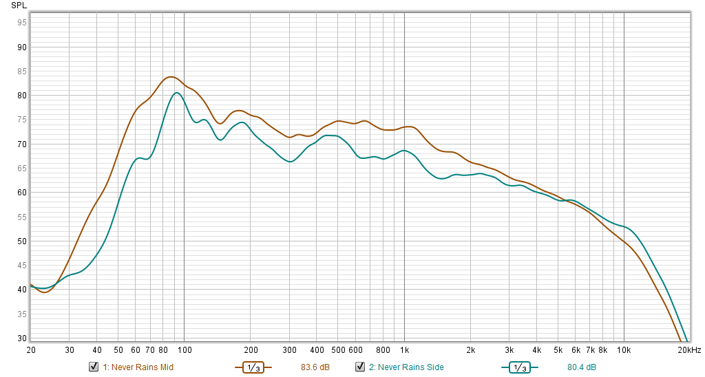

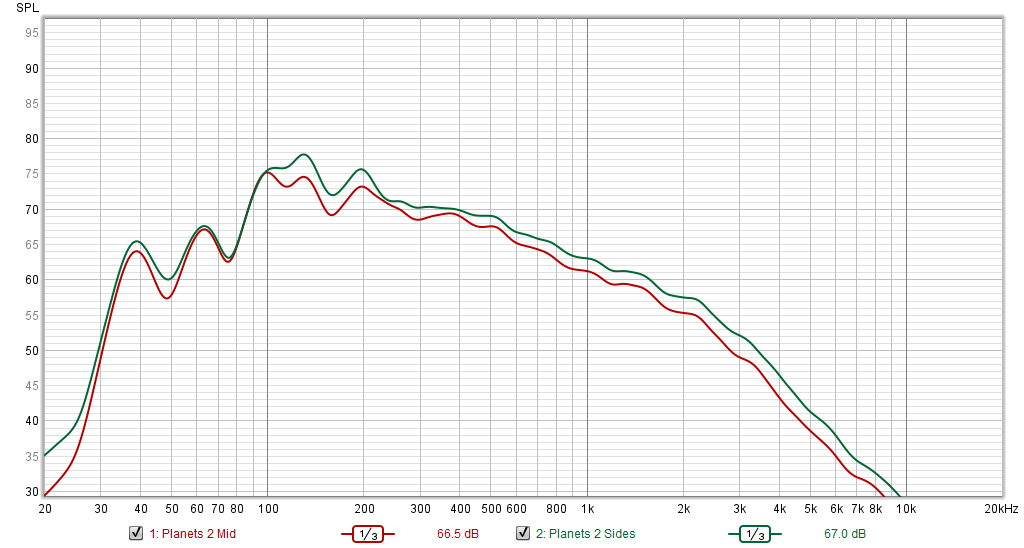

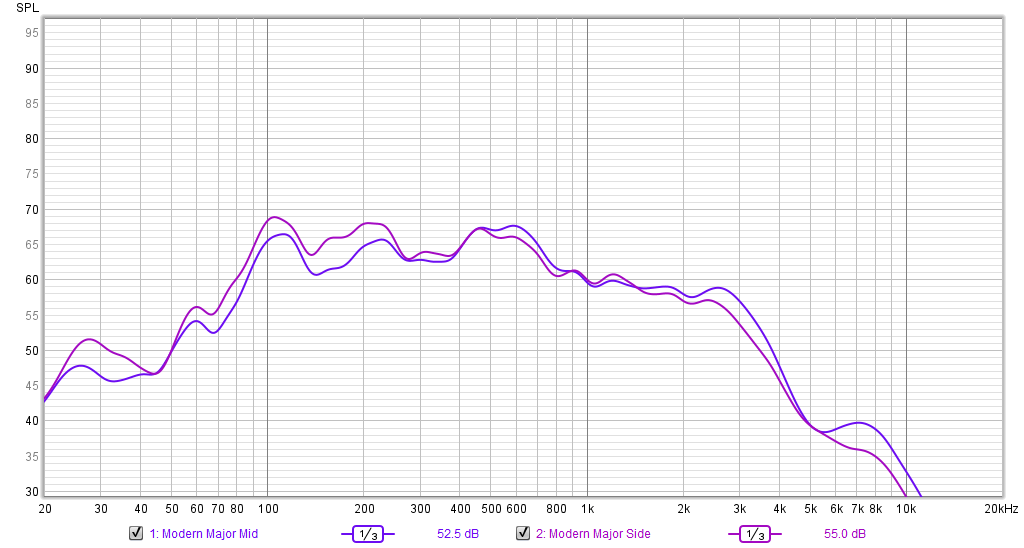

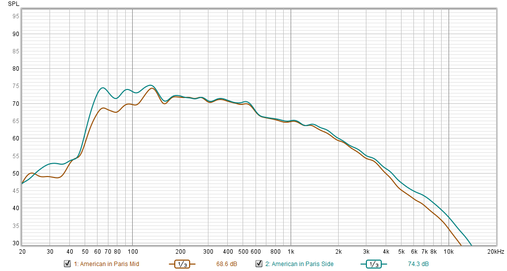

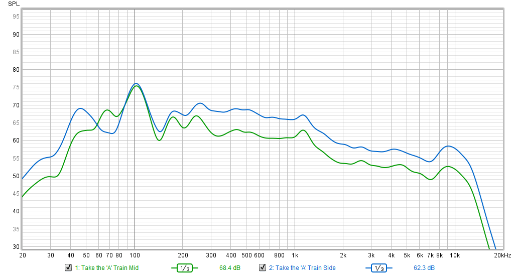

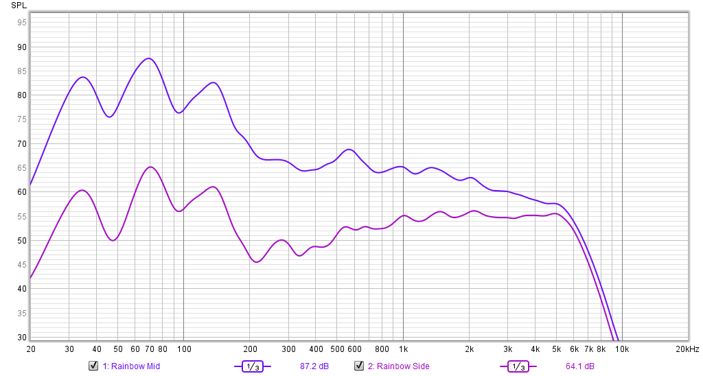

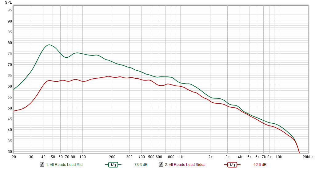

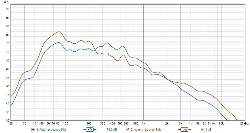

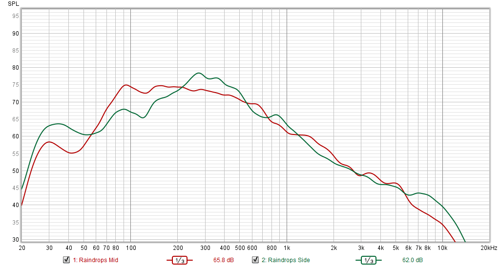

Just to annoy you all, here are a few more. I'll let you decipher them and decide how stereophonic they are above and below 100Hz
Remember, the MID channel is the mono component of the track, the SIDE channel is the difference between the tracks (stereo)
I don’t have a lot of vinyl rips to test this, but have found that some mix the bass to mono, others don’t. I haven’t yet been able to predict which do or don’t.
If you have any, try a Sheffield labs (or M&K) direct to disc LP.
I need to make myself more familiar with this method.I'll let you decipher them and decide how stereophonic they are above and below 100Hz
Yes, we need a large number of rips and across many genres. And I need a way to make those plots in Batch mode, they are tedious.Unfortunately, we both don't have enough material, so we need a volunteer.
Getting them into Mid-Side is easy, but the plots are not. Maybe a Matlab or Python guru could help

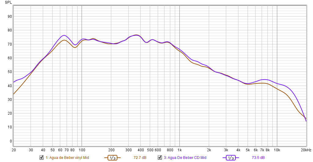

Here is something fun. Sergio Mendes Agua de Beber from CD and from vinyl. First we see the mono (Mid) signal showing Vinyl vs CD. They have a similar FR, the CD has a bit more bass and top end.

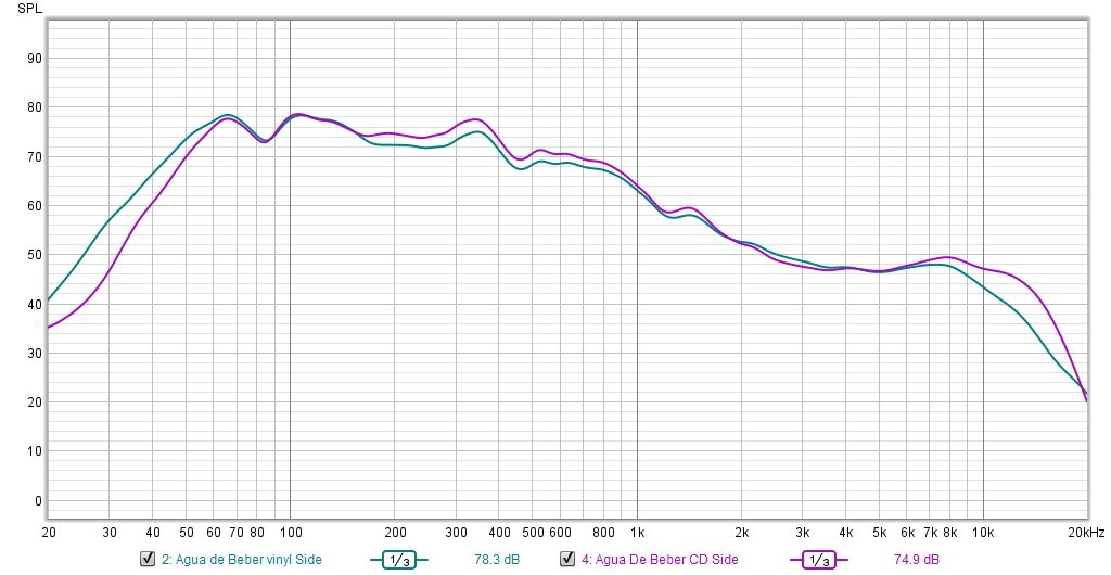

Here is the stereo difference signal (Side). Again, very similar FR between the two and we certainly see that <100Hz is not mono on the vinyl nor on the CD.
Hugo has found they same, that stereo is strong in the bass on this track. He has used different software and methods and will post here.Below is "Us and Them" from DSOTM. You can see that the stereo effect is very strong across the spectrum.
