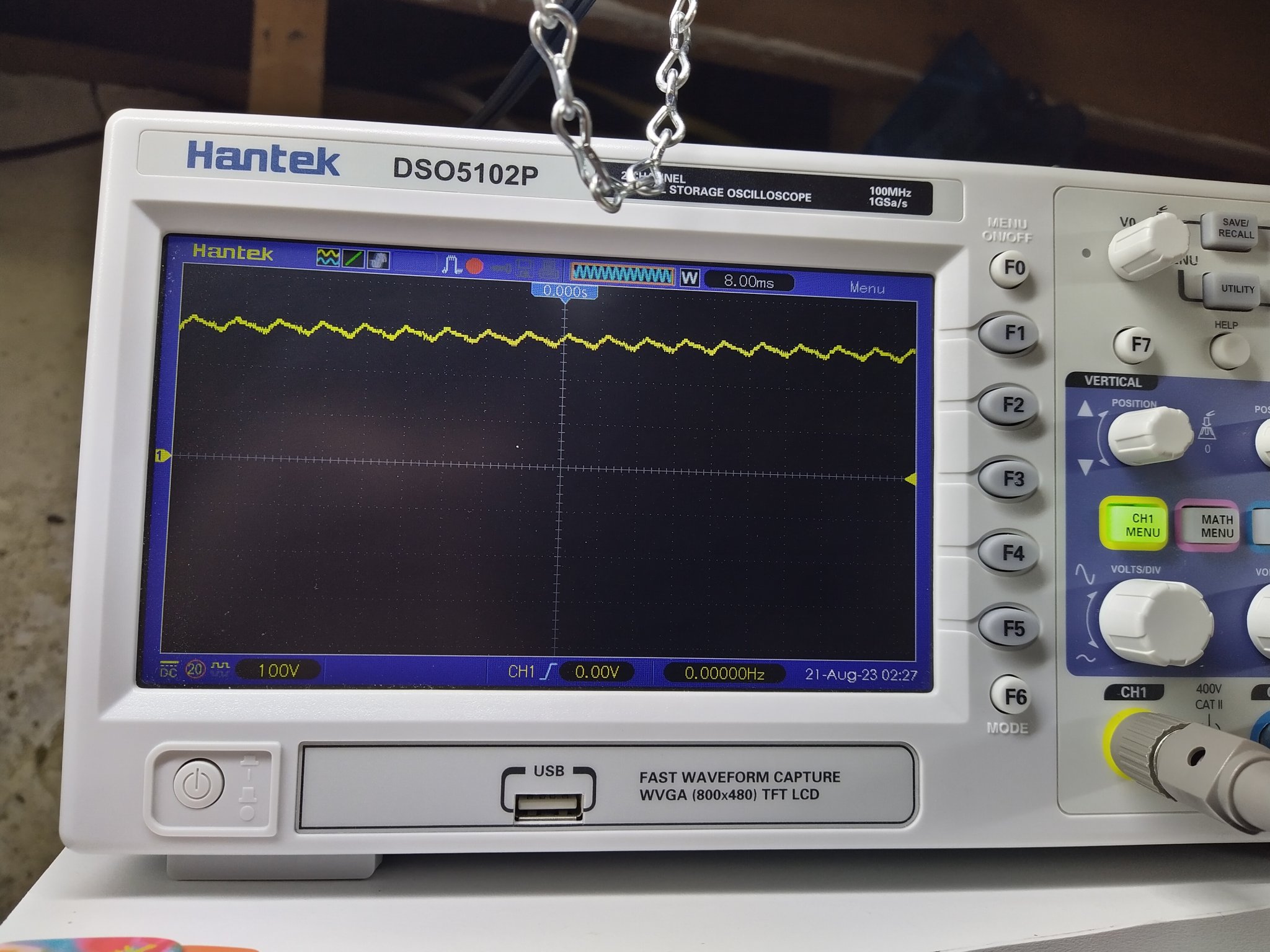

Anyways, I have a little bit of hum on the speaker, and according to my scope it is 120Hz.

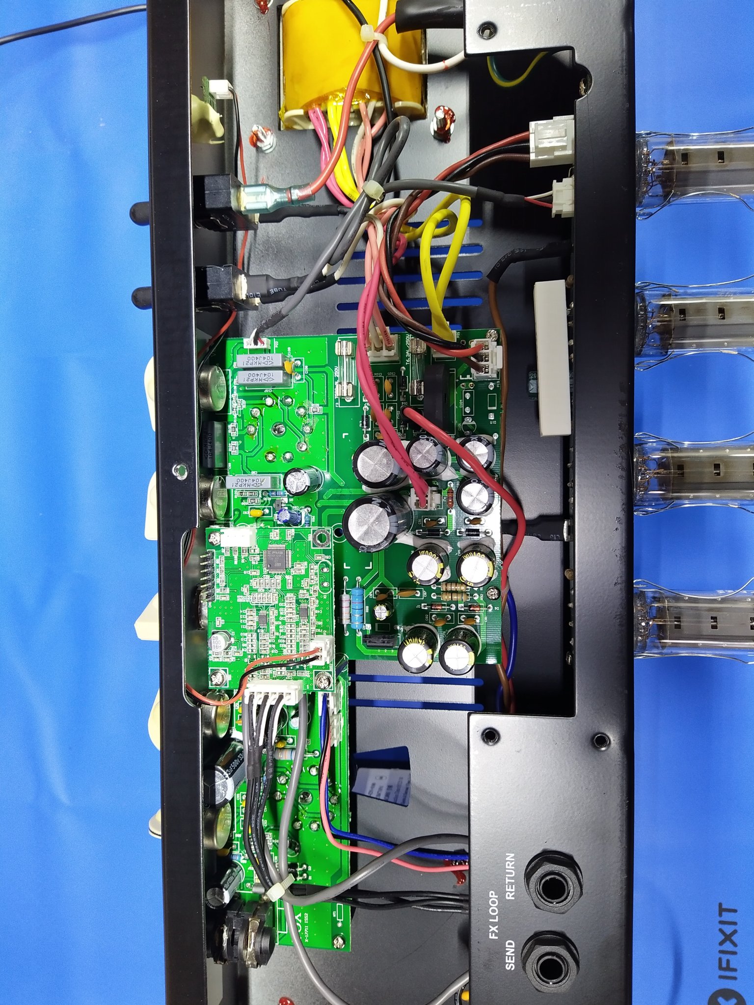

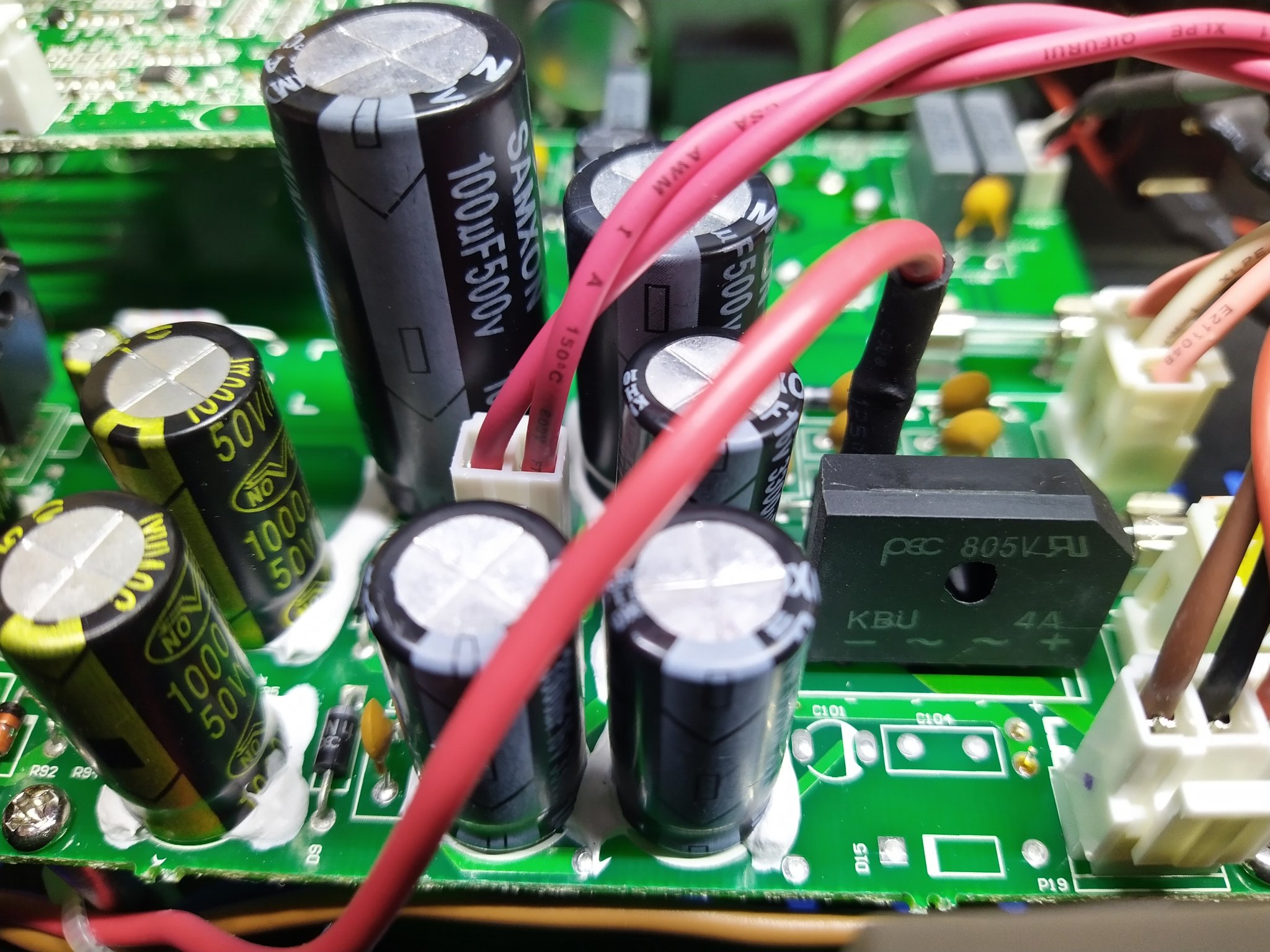

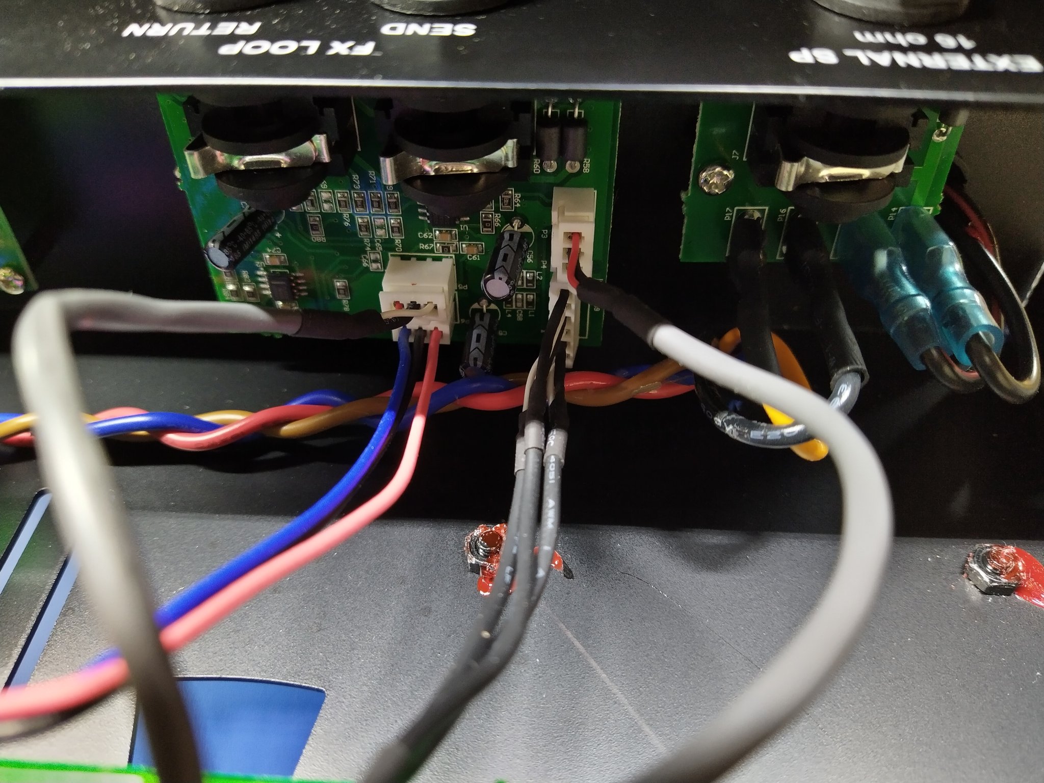

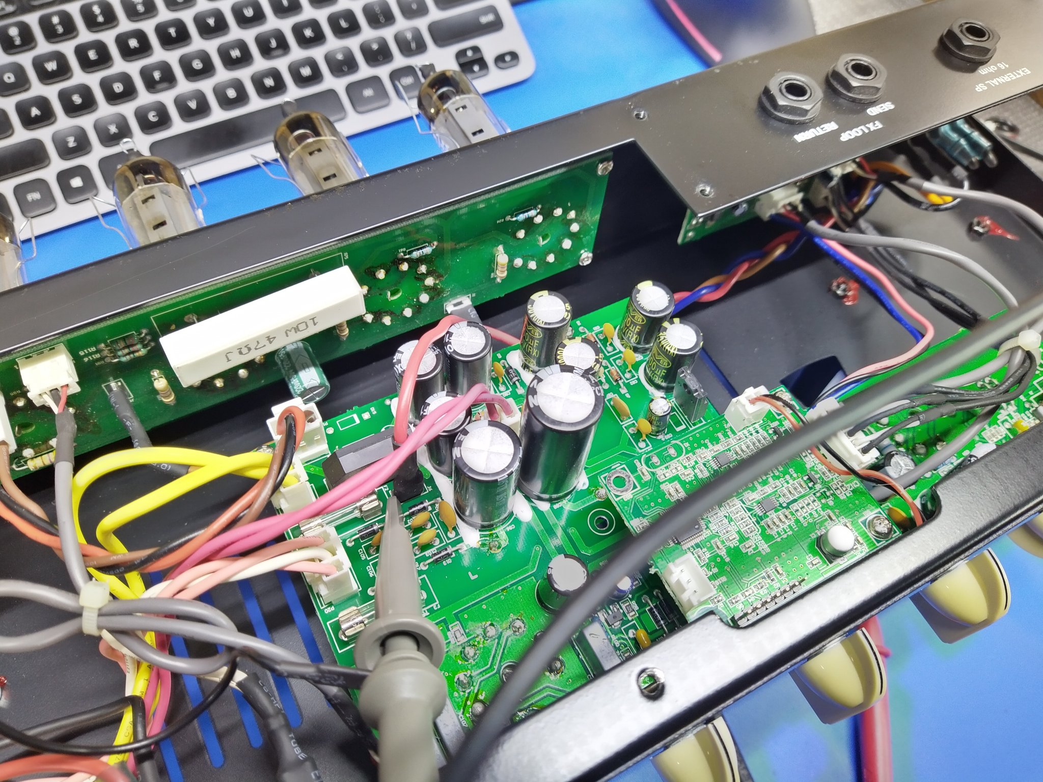

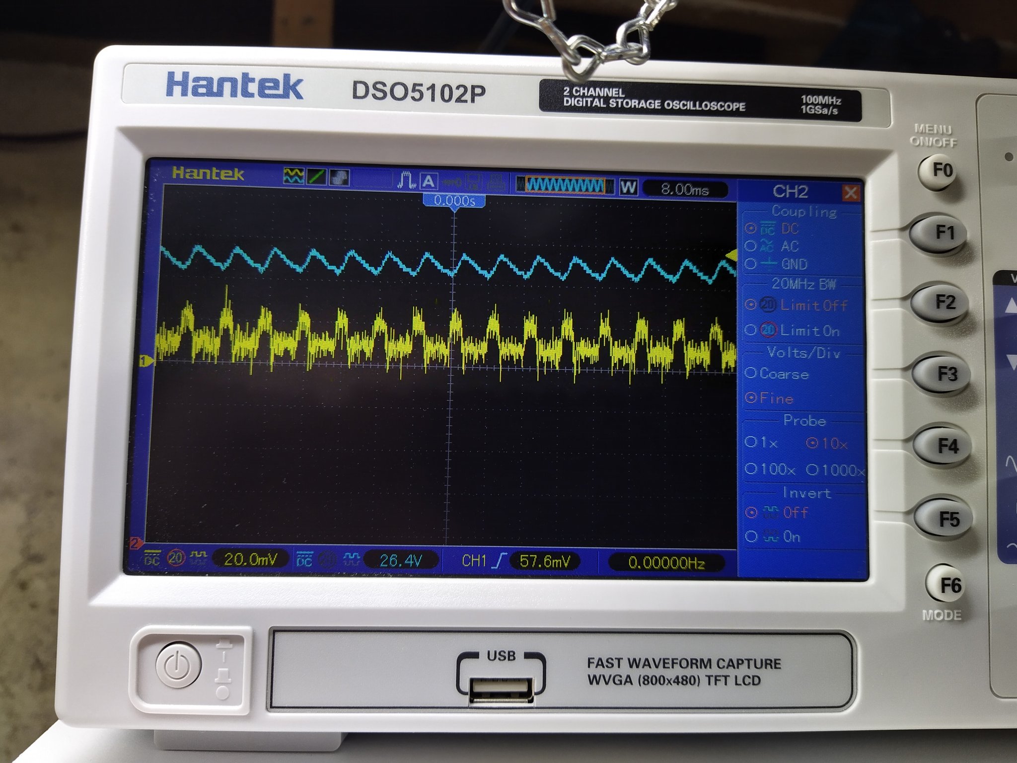

Some pre disassemble photos of the AC30S1.

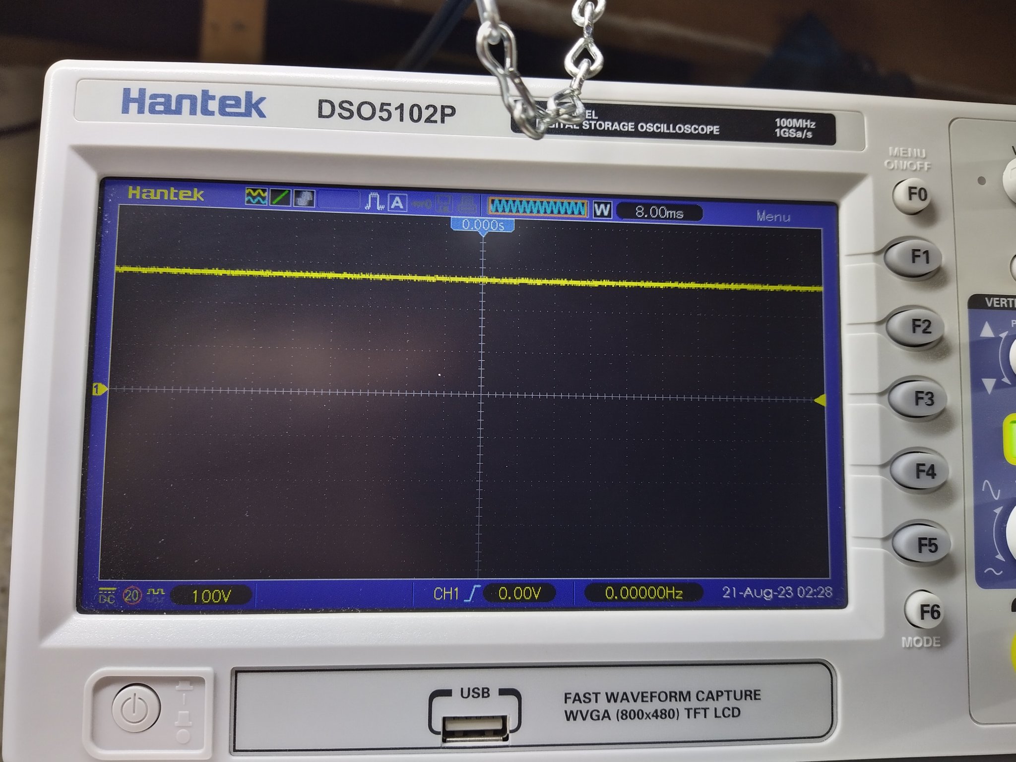

The scope pictures include the B+ at the output to the output transformer. And the second scope picture is measured at pin 9 of the first EL84 power tube.
That's some zig zaggy dc being sent to the output transformer.

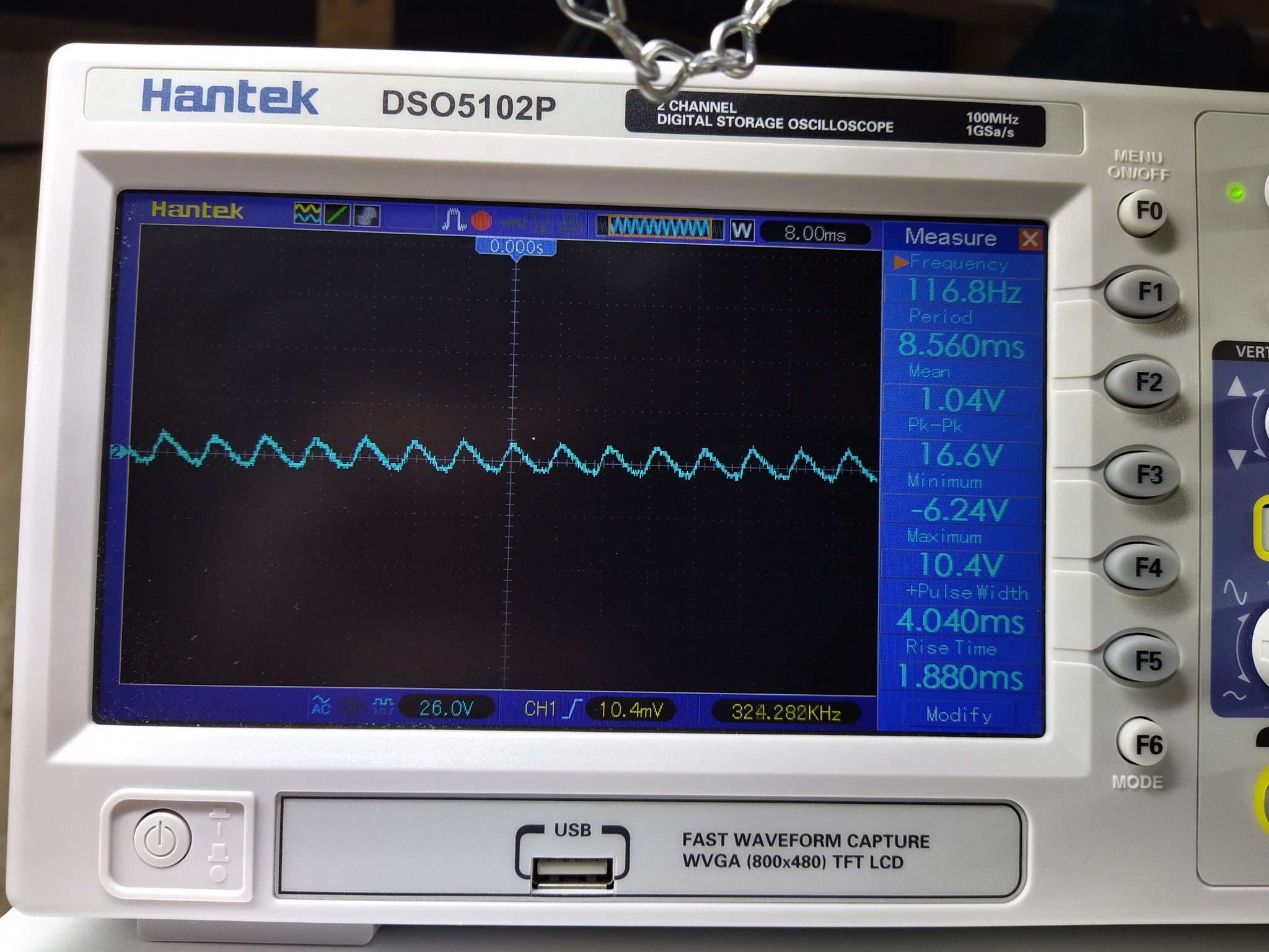

Pic 4 looks like 120Hz power supply ripple.
To better view the ripple set your scope to AC coupling.
What is the time base setting?
Also use the scope's frequency measuring function.

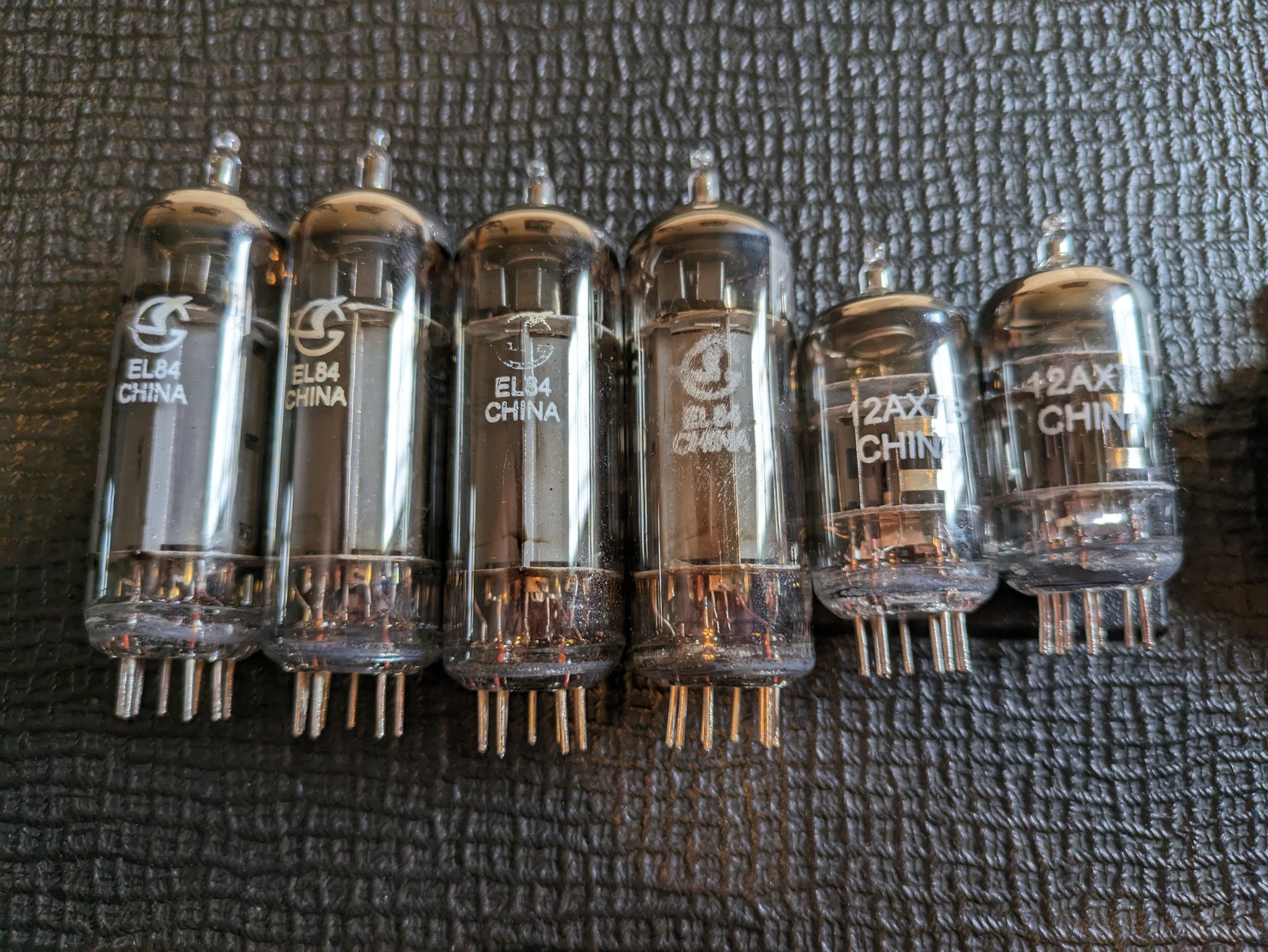

Are your power tubes fresh and well matched?
Also find and post the appropriate schematic here, so we know what we're talking about.

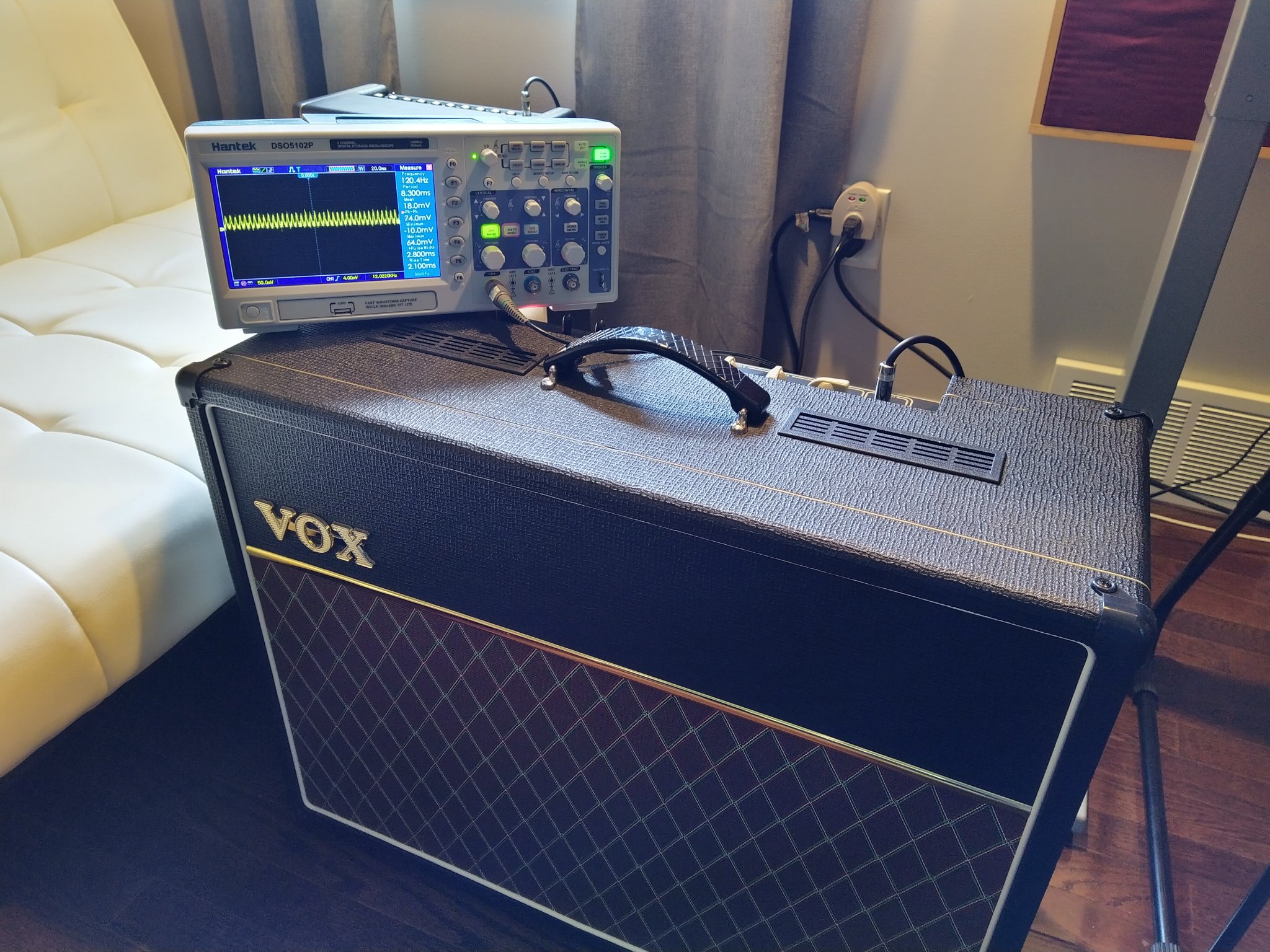

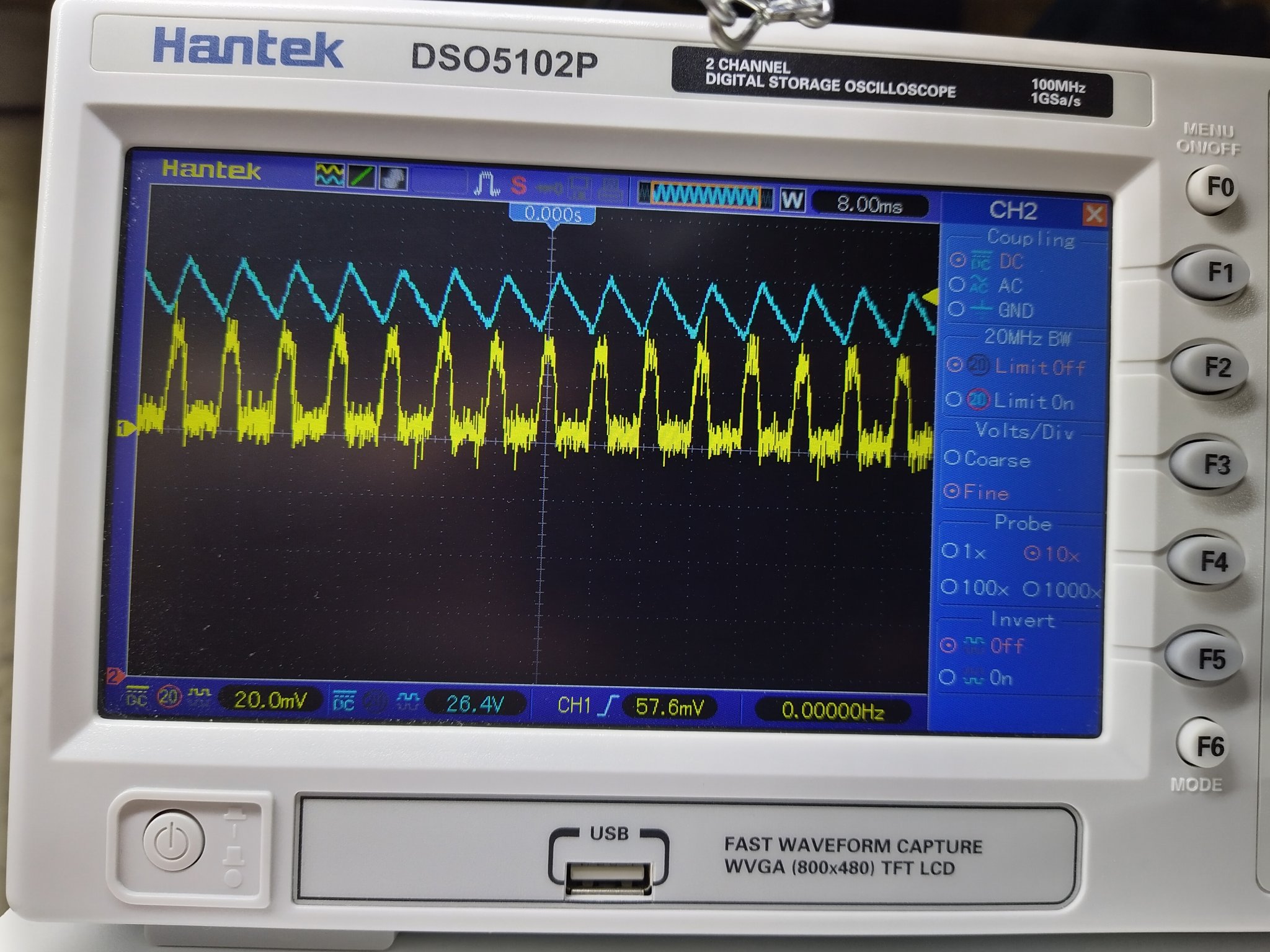

Ok. Before and after shots.
I temporarily added an extra 39uF between the output transformer B+ line and the star ground on the chassis.
The blue is the b+.
The yellow is the output at the speaker.
Seems like the dirty power is related.
The blue is the b+.

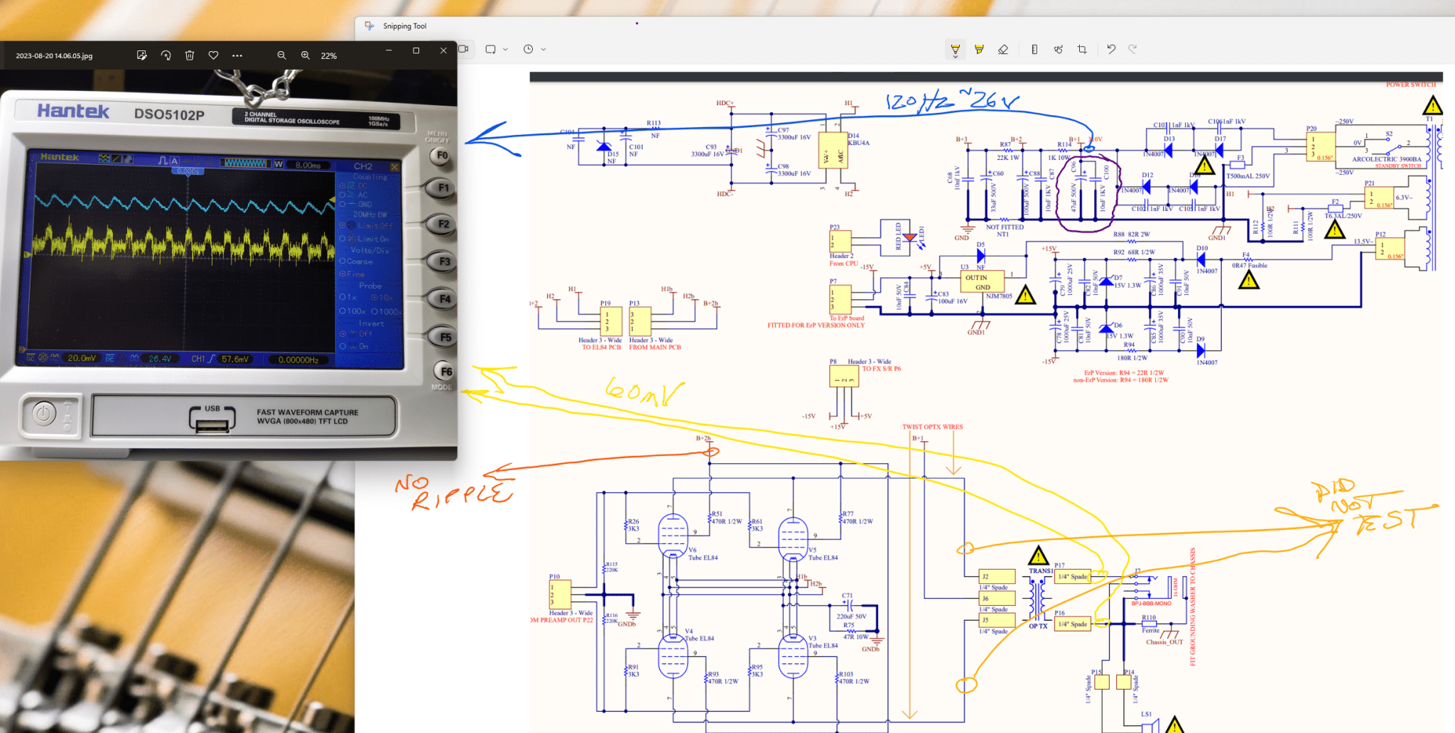

@Rikaro I can't find a schematic for this specific model. Vox AC30S1. Thanks for the tip about AC coupling. Never knew what that setting was for.

AC coupling adds a coupling cap before the channel input, blocking DCV.
This allows you to only view the AC content as well as center it and freely vary the amplitude by changing the channel sensitivity.
Time base setting is a (m)s/div value which is adjusted via the "Horizontal" knob.
It allows to read the signal frequency from the trace.
Consult the scope manual to display it.
Your result with added filter capacitance may indicate that some original cap has partly lost capacitance.
Not sure what you mean with "check the signal output before the transformer".
I generally do not recommend to scope power tube plates (pin7) or the OT primary.
Voltages there can exceed the voltage ratings of scope/probes.
Also sometimes causes oscillation.
It is normal to have a 120Hz ripple of a few volts a B+1 and maybe ~1V at B+2 (you can measure ripple voltage on the power supply with a good DMM).
Don't make filter caps much larger than original as this would change the amp's dynamics.
My scope and probe leads are rated 600v. Voltage in this amp is half that, should I be worried?
At B+ 1,(blue) I have scope set to ~26 volt/division. (below, and post # 8)
Across the speaker (yellow), there is roughly 60 mV ripple at 120Hz. (See post 4)
Measuring the B+ 2, (red) shows no ripple, just clean DC.
I didn't check the signal output (orange) from the power amp board. If there is no ripple there, I can narrow in on the 2 caps circled in (purple, c96, c100).
Looked up your scope's manual. Says channel input must be below 300V DC or AC RMS. Peak voltage up to 450V max.My scope and probe leads are rated 600v. Voltage in this amp is half that, should I be worried?
http://www.hantek.com/Product/5000P/DSO5000P_Manual.pdf
A 1x or 10x probe does not attenuate DCV in AC coupling.
At power tube plates, peak voltage will be around 600V at full output and even more if the amp is oscillating.
Sorry, I don't understand how to interpret your scope's readouts (much different from my Siglent scope).
Seems you're still using DC coupling.
If B+2 is clean, the ripple will only affect the power stage.
As said earlier, first make sure power tubes are matched.
The EL84s in an AC30 run very hot and don't last long (maybe 2 years depending on operating hours).
These designs are ancient - there is always some hum. Not sure if original Vox tubes are noname China ... don't think so, but I didn't open my AC30 top, so not sure.

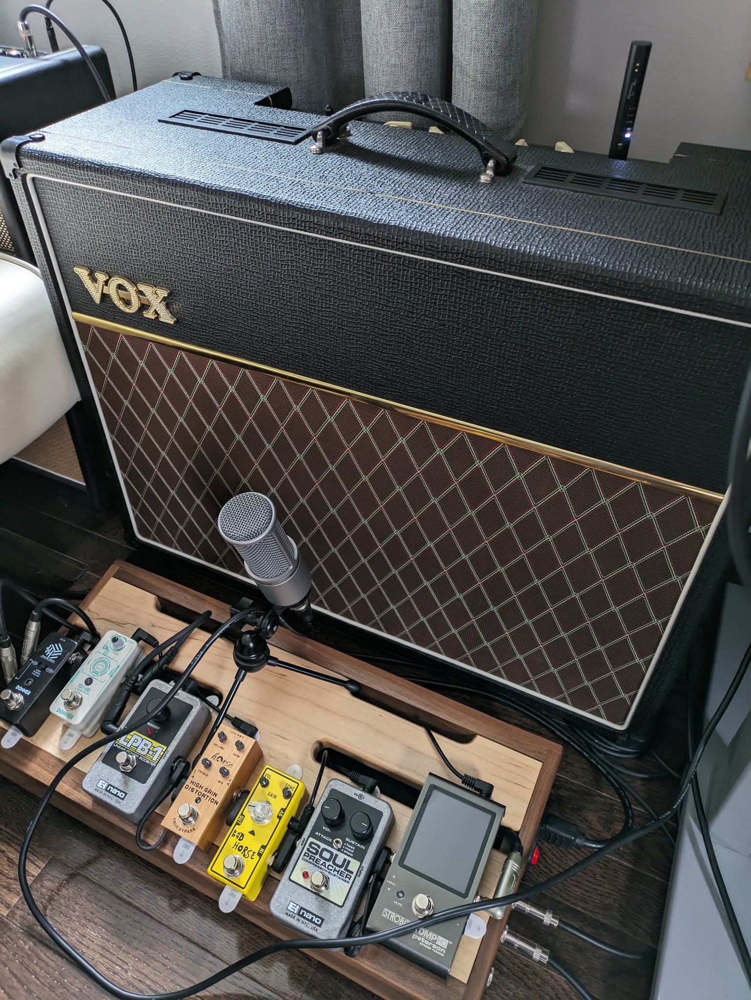

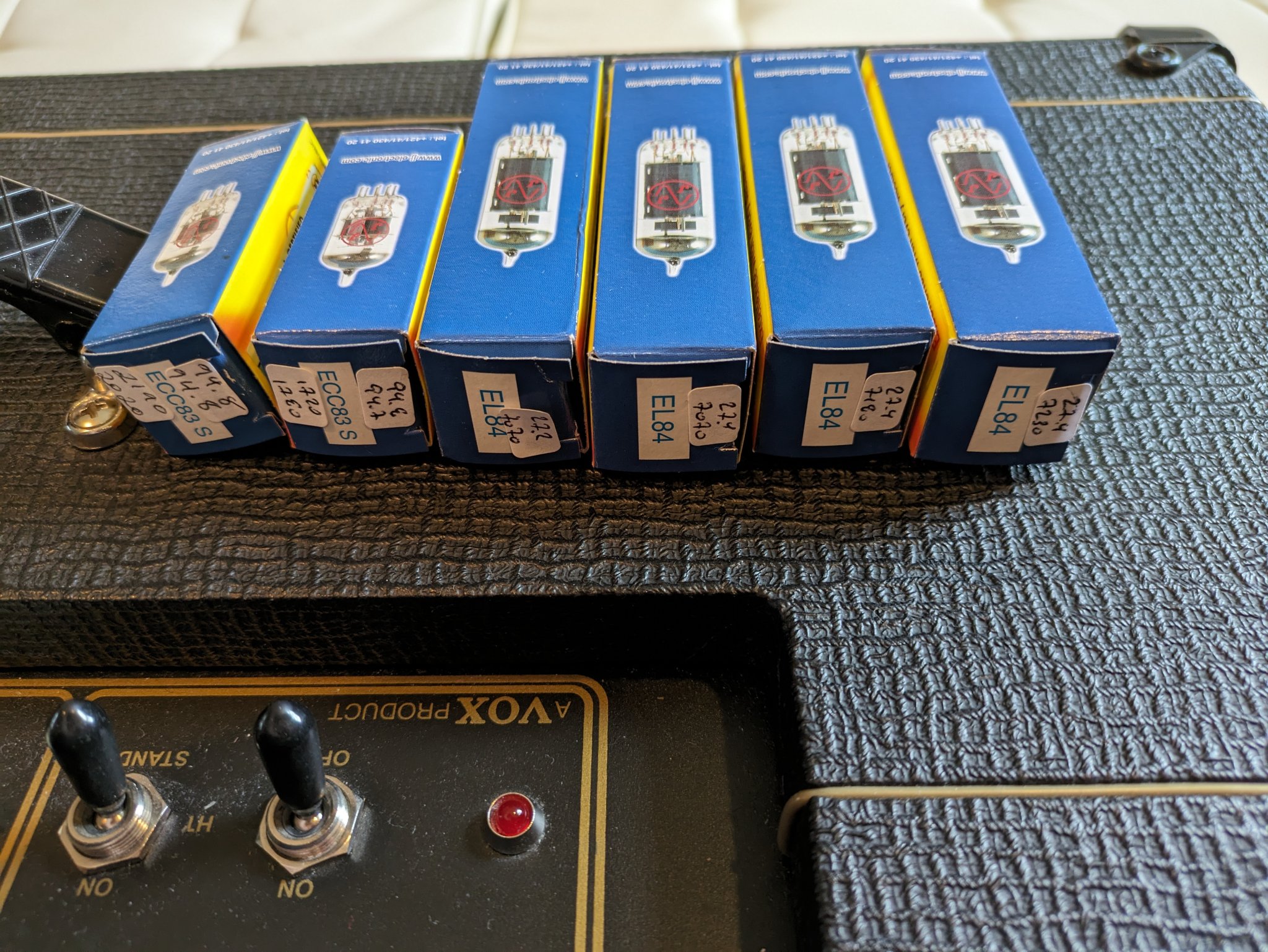

Here is an update for posterity, and future AC30S1 owners.
tldr; Given the info provided by this forum and my experiments, I believe the "hum" I am experiencing is part of the design of this amp.
I never got around to testing the tube set that came in the used (new to me) Vox amp.
However, I did change the tubes out for a new matched set. I went with a set of JJ's from VivaTubes.
I also recorded 3 sound sample of the old set, the new set, and a Spark amp's modeled version of an AC30.
I maintained the controls on the amp and my mic pre for all three recording. The new tubes definitely have more gain. In hind sight, I probably should of decibel matched a known signal for the audio to mean anything. But alas. I think my conclusion would be the same.
