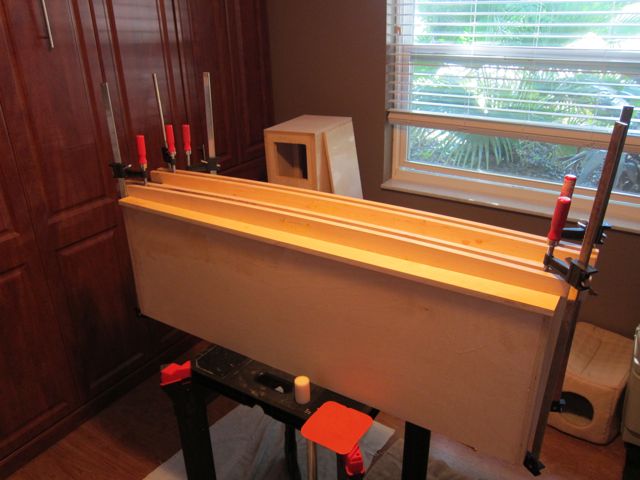

Wow... this thread really rolled on without me... (I have been away for the last 3 days)
I don't like the 15's... the magnets are really quite undersized for the weight of the cone...
Each tower is 60litres.. so each "subwoofer" is effectivly getting 30 litres... tuning frequency is about 38Hz was going to be 36Hz, but it made the port TOOOO long.. hehe

How high will the woofers go (or how low the mids)?
If you can get the mids down to 100Hz, then my recommended solution would be to have the woofer cabinets as separate enclosures. Positioning them to work well in your room would then be much easier. You could lay the subs flat if you wanted.
It's a bit radical and involves more MDF but ...
7V said:How high will the woofers go (or how low the mids)?
I dunno.... but I doubt my mids will go that low...
Laying the "subs" flat seems quite silly to me... I made them to take up as little floor space as possible..
I don't want more MDF... not too much more anyway.. lol

So what I am suggesting as one solution to his problem - build a trapezoidal pod that will house the mid-range and tweeter and sit on the top of the current boxes
Don't place them in a position that is fixed and design them in such a way that they can be toed in.
Then you can toe in the mid and the tweeter appropriately, yet leave the bass firing dead ahead.
If you become obsessive about placing the bass on a true, square line - then the bass frequencies will tend to "snap in" and reinforce themselves - not muddy at all - at least that was the case with the 801's. It really was an excellent design feature that worked very well.
