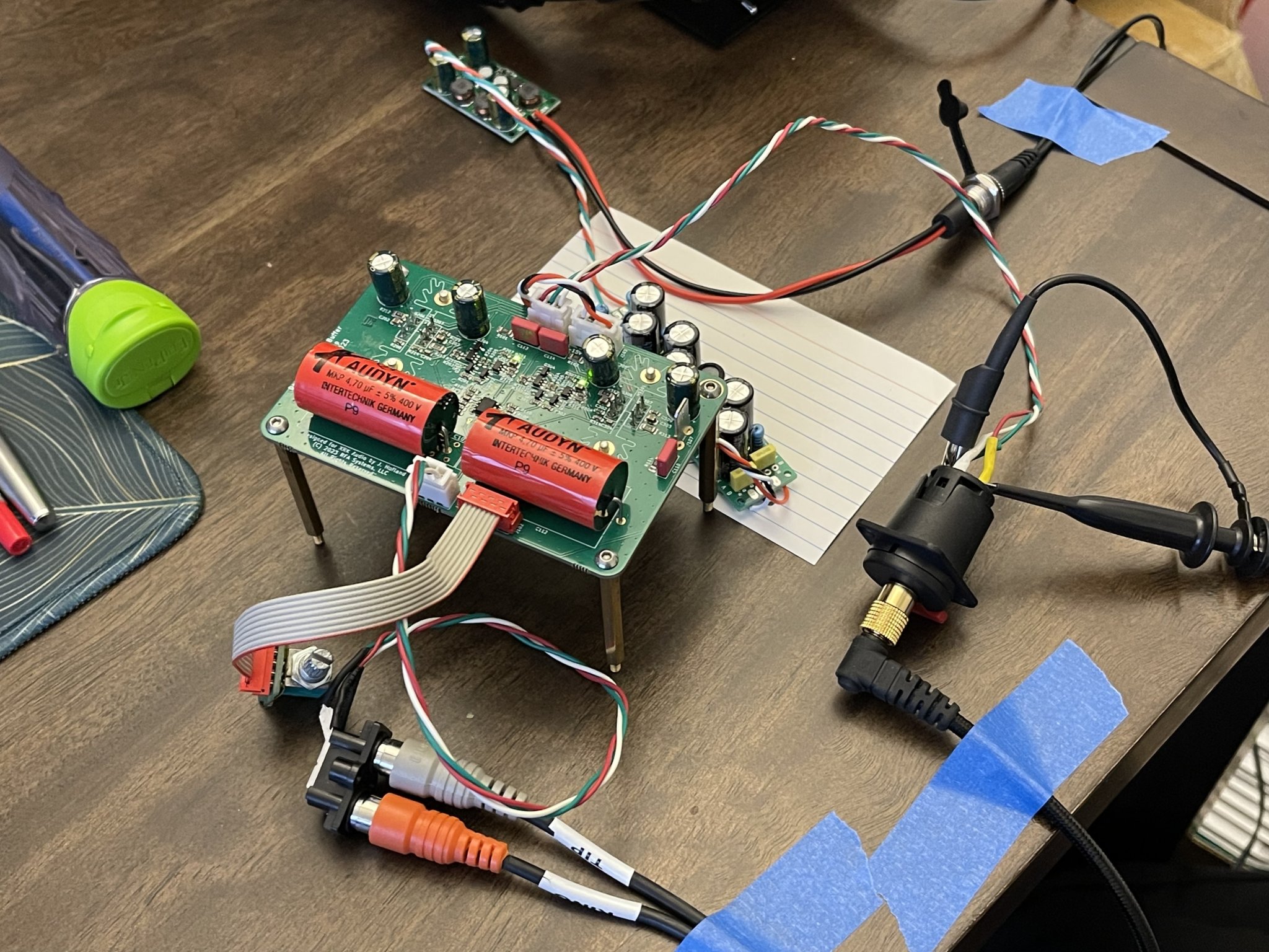

I got the Desktop Diamond Buffer headphone amp verification build in and testing it now. Sounds great. It does need a clean +/-15v PSU though. I am using a cheap DCDC switcher (no linear regulators post switching) and heat some residual noise. Bit for purposes of testing it out if circuit works, it’s good enough.
The outputs are supposed to be TTA004/TTC004 but all I had in hand are my prized NOS 2SC4795/2SA1837 which have flipped pin out so they are mounted from the bottom:

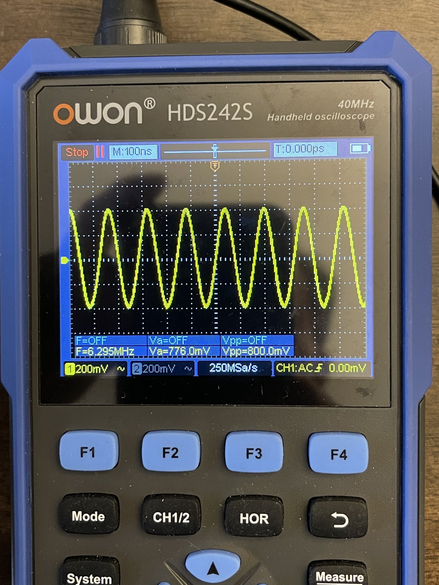

Pesky 6.3 MHz oscillation so I will have to reduce the resistor in the Zobel. Currently at 15ohms. Will go to 6.8R next. The diamond buffer has some very high speed performance so transients and highs sound great but this can have some issues with oscillations which we tame with an output Zobel filter. These typically need to be hand tuned as simulations don’t always predict them as models are not perfect.
I’ll swap out the resistors and report back.

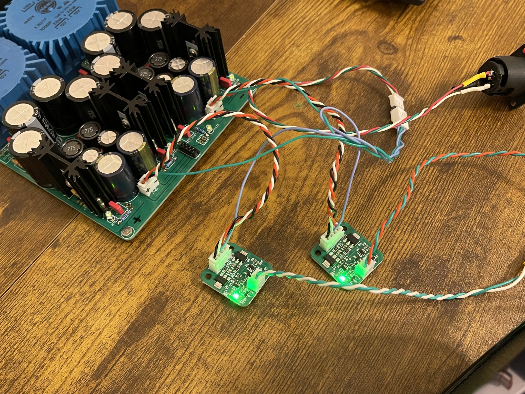

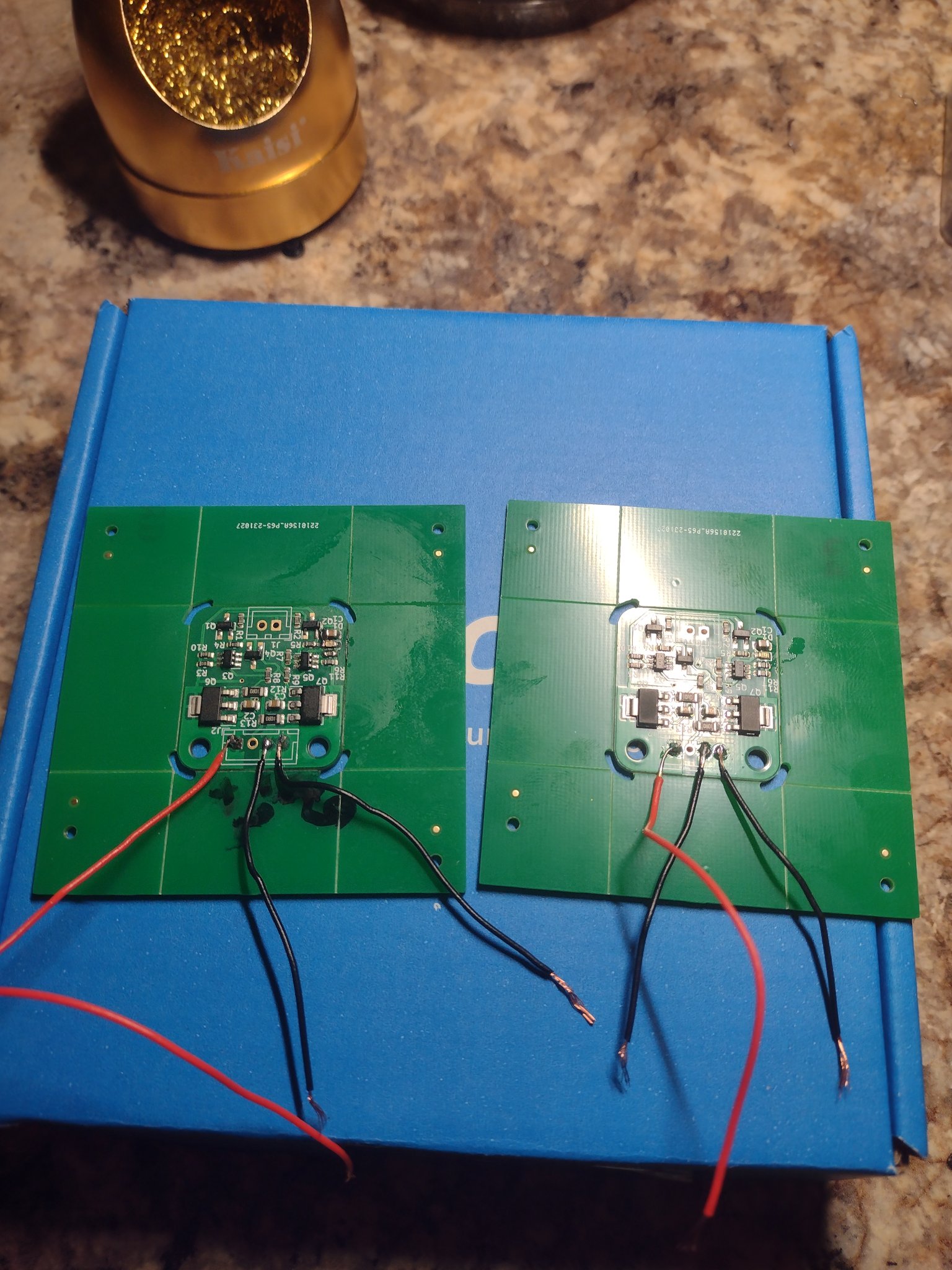

Mine showed up, but it will be a bit before I can get them in a case. I tried my hand at replacing the red LED with a green one. First board I used my solder iron and that went sideways quickly, ended up pulling the pad off the board. I managed a repair with piece of a resistor leg and too my amazement the board lights up when power was applied not sure about a signal. This convinced me to buy a 40 dollar hot air station off amazon, the second board was much easier and went flawlessly. The board on the left is the one I butchered :)

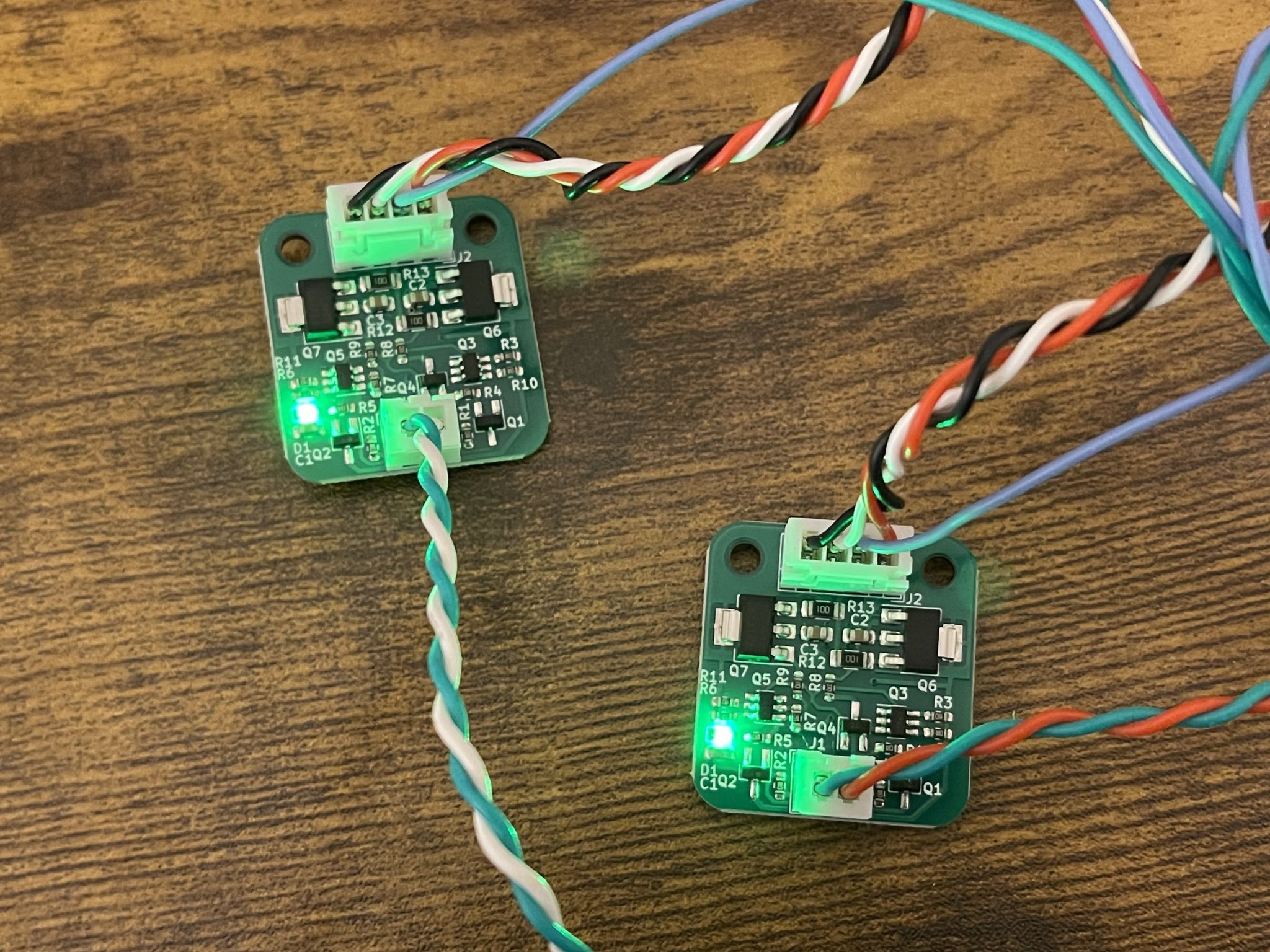

Just collected mine today from shipper. Excitedly changed out the red led to the green ones. Powered up and all went well. Connected the inputs to ground and DC offsets were measured to be 4.5mV and 6.8mV. Just a simple power up test today. Putting them into operation will be a couple weeks later after the long holidays.

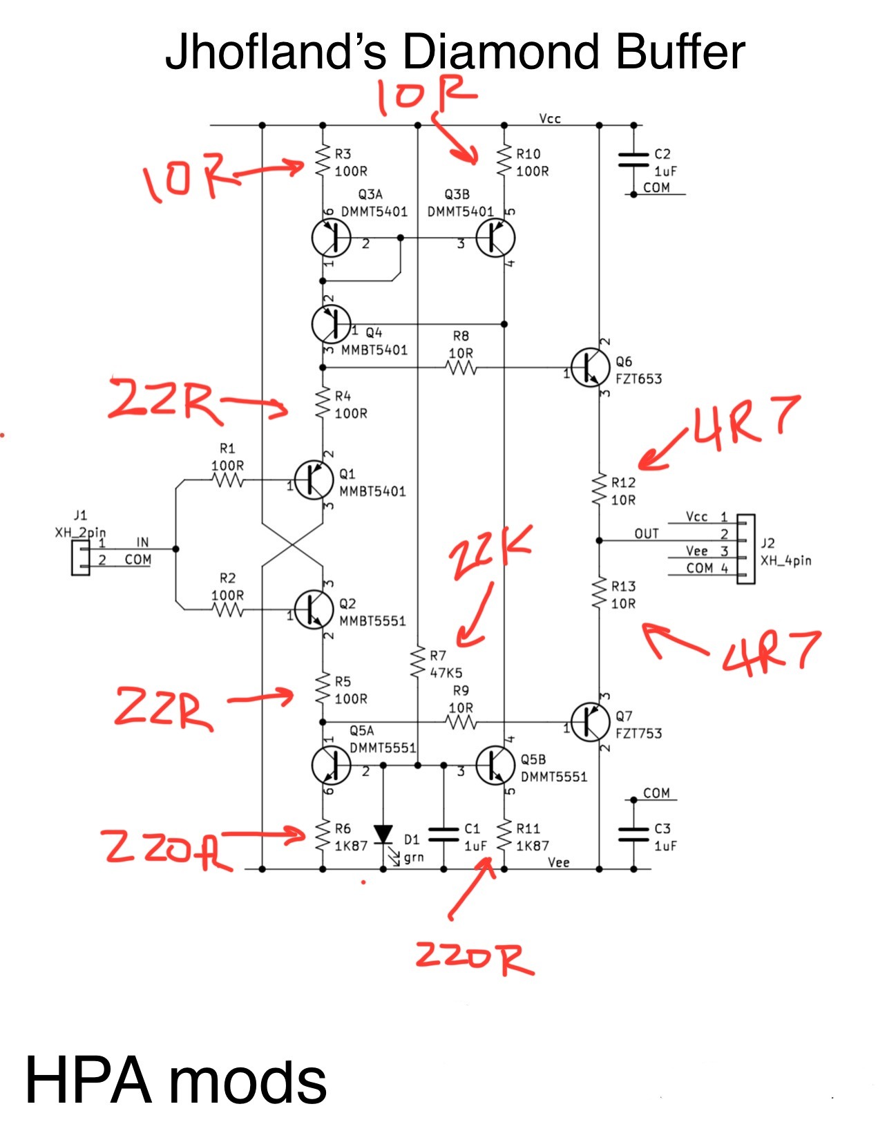

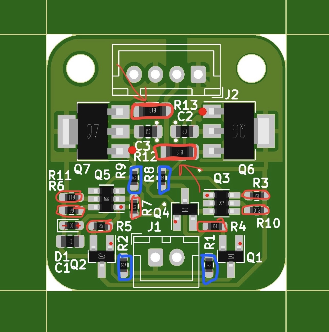

I have had a lot of requests as to how to convert these to powerful headphone amps.
More info here:
https://www.diyaudio.com/community/threads/jhoflands-diamond-buffer.401231/post-7563106
You need to switch these resistors in order to have amp operating with low distortion with as low as 32ohm cans.
The resistors in red need to be swapped with values shown above. Leave the blues ones.
Note well, the board or the BJTs need heatsinking if you do this. They will burn about 1.5W per board with +/-15v rails.

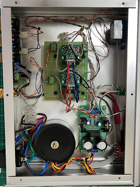

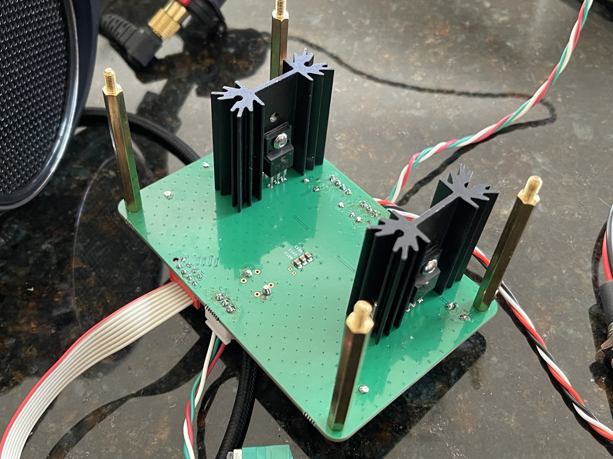

I have eventually managed to put it into a test. First impression is pretty good. Tone is balanced and natural with good details. The only issue is that the sound stage is a bit flat. Otherwise it can be a superb buffer amp for my system immediately.
I will remove the adapter board and give it a better power supply. At the moment it has only a very basic 7812/7912 +/-12V PS.
