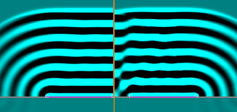

I thought I'd provide a demonstration on the problem of not running your line to the floor.
(I've put two on the same screen, the vertical line through the middle is the floor in both cases and each room is simulated on it's side so they fit on the screen. The left one shows the source to the floor and the right one shows a gap between the source and the floor.)
Of course the interest in this may vary in a number of ways at different frequencies.
Allen, Thank You for the demo. Very interesting, now is this example of a non tapered?
