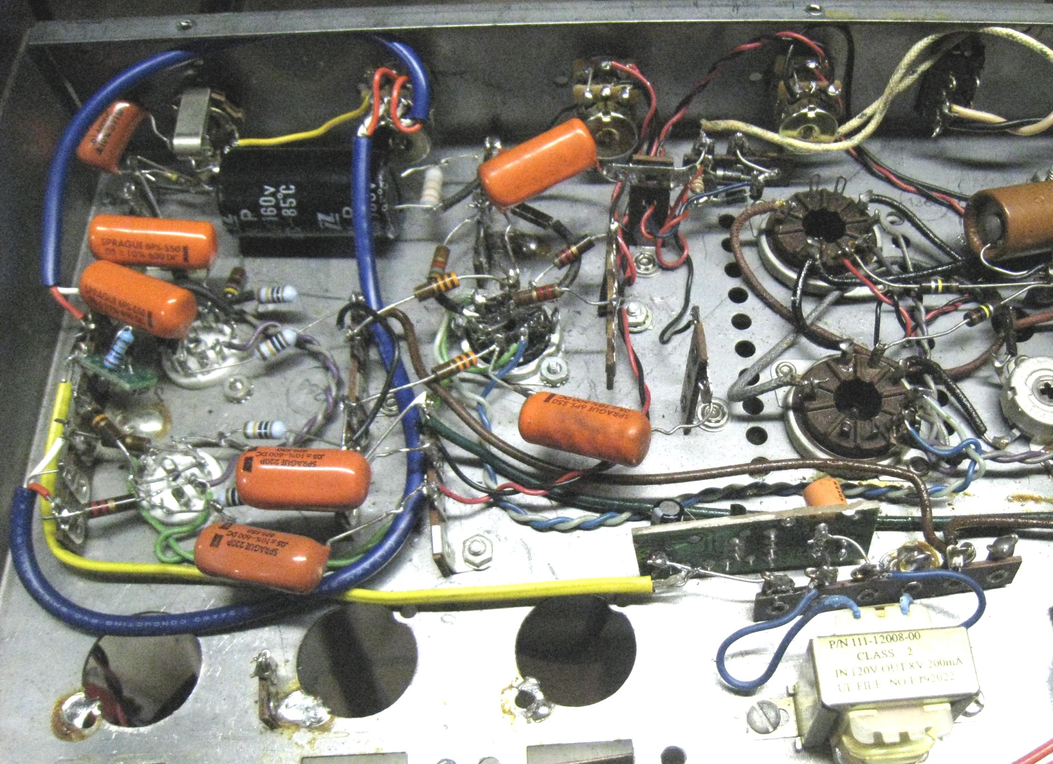

I luckily picked up one of these at the local Ham Radio swap meet. I'm going to turn it into a guitar amp / experimentation platform, to try out some ideas I've had. It will not be a "get a fender schematic and go for it" type build. An additional bit of luck, the amp came up on the Variac with no red plating of the 7868 output tubes and connecting a speaker, I've confirmed a signal makes it through.
Here's what the amp looks like with the cover off;
I gutted the whole thing, leaving only the output stage intact. Bought two new sockets, salvaged one from the mic transformer position. I was hoping to use at least some of the original circuits, but after wrestling several crimped wire leads off socket pins, I decided on a clean sweep.
Even testing my filament connections - smoke! How could this be? Turns out one wire at the upper left corner of the black socket possibly was touching a ground tab provided by that socket. Dont know why that would short circuit the heater winding...looking at the terminals where the PT heater winding attaches, neither are grounded. I ended up replacing the TWP from the power tube sockets and now all 5 tubes light. The original TWP was in bad shape; the short may have been there in a breached jacket in the first place. Nice way to beat up my PT, right out of the chute. Hopefully, this incident isnt foretelling of how things are going to go with my project.

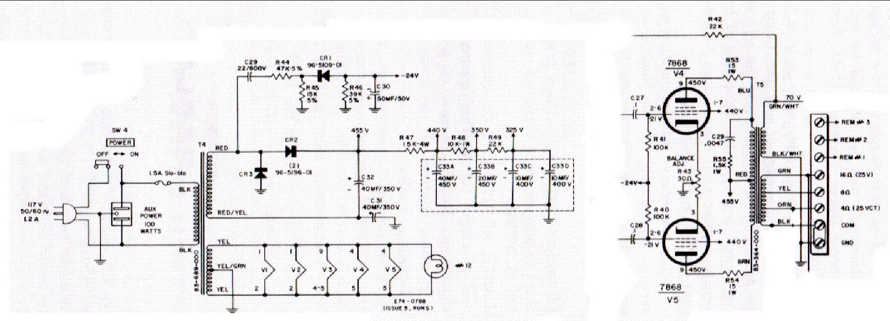

Here's a schematic of what's left after the gut. Mozz is right - voltage doubler B+. I have 3 empty 9 pin sockets besides, with the potential for mounting up to 3 more - probably more tubes than the heater winding can handle.
There's why the heater winding didnt like one lead coming into contact with ground...

Something I figured out is this Bogen's power supply crashes 70V (from 460 to 390) going from idle to full power on a resistor load. I dont mind the compression that might give on the output stage, but the droop of the B+ follows to my signal tubes causes the diff pairs to go out of balance.Beware some Bogens, well a lot, use a voltage doubler circuit for the B+.
That's right, at just over 300V B+ both tube sections amplify pretty much the same, Crash that to 230, now one side of a stage amplifies more than the other.
Part of the design is the assumption that both identically built inverting and non inverting signal chains operate identically. Until I tell them not to via some control or signal, versus a coincidence with something else.
The next issue I've found is that the dual pots I purchased dont track very well, causing discrepancy in amplitude in the middle of their rotation, while at the "end" or wide open, the + and - amplitudes of the gain stages are pretty close.
The old 40 uf 350V caps in the voltage double circuit both measure better than the value (47) unless I'm getting tricked by doing that in circuit. If I replace them with fresh and larger value caps, intuitively that would lower the output impedance of the voltage doubler. Is this true?
That kind of droop is not uncommon. It may be better with fresh caps, but that voltage doubler does produce high peak secondary currents so some droop has to be expected. Whatever happens, the circuit has to be designed to work with it. Might take a regulated 300V for the front end. For ahi-fi application, I will always do that. That phase splitter stays in balance.
