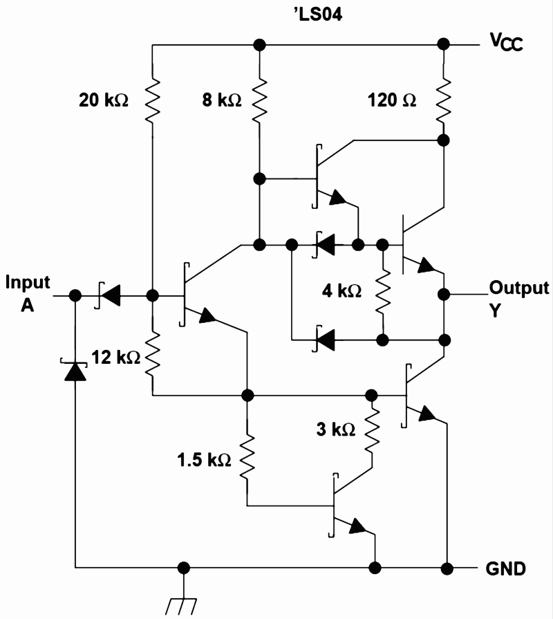

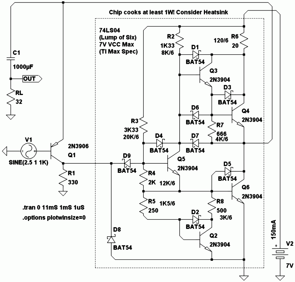

I know where you can get six of those cheap...
Add a PNP and collector pulldown at the input,
to keep that first Schottky forward biased...
74S04 might work better (more current) than LS?
LS is actually based upon older DTL style logic.
But S has got that strange TTL base - collector
junction thats sometimes forward biased. Didn't
know how transistor sim models might handle...
You see the JLH now?
There's a lot of Schottkys doing nothing in this
analog application. I left them for reality check...

JLH steering output transistor base current, ignoring output voltage and current.
(except in the GNF loop, after the paralleling). Seems a fairly compatible topology
for parallel abuse. Certainly with the 74LS04, as you got 120 ohms extra insurance
built into each output totem.
Could piggyback a dozen or more if you could figure a way to get the heat out...
PNP Collector pulldown must be proportionally smaller the more gates you drive.
Sim a dumbed down inverter logic gate in LTSpice is not the same, and it does
not work in this application. You need the full internal schematic to understand
why the input has to be pulled down.

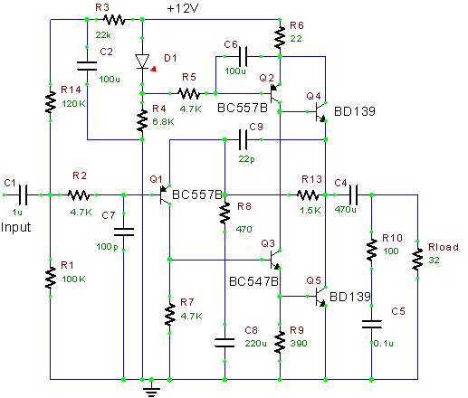

Joined 2002
Circuit diagram and some notes.
The circuit diagram is attached.
I used a 12-0-12 Volt power transformer feeding two FR107 diodes to a 2200uF cap. This is connected via a 10 ohm resistor to another 2200uF cap. This is the supply to a capacitance multiplier made up of a BD139 with 470 ohm resistor from collector to base. 470uF cap from base to ground and 100uF cap from emitter to ground.
I don't hear any hum or hiss from the headphone. Must try this at night when the ambient noise is very low. The LED on board is a red 5mm diffused type and isn't very bright. The heat sink I've used is about 30x30x1.6 mm. Both output transistors are mounted on it using mica insulators.
The heat sink after one hour is about 39 deg C and the ambient temperature is 25 deg C.

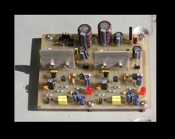

The board
Here is a picture of the board.
Not a clear shot.
When it's very quiet I can hear faint hum in the can's ! So a better supply regulator is required. I will of course rip up the grounding scheme of the board to deterimine if that is the cause. So more work ahead . A second listening session shows up the other headphone amp as sounding muffled in comparison. Is this one boosting HF ? Will have to run the tests now.
Note the cheapo yellow box 1uF input cap and standard Samwha elco's. Still sounds very good. No sloppiness in the bass. Nice and tight / deep bass and very good HF . On phones it has shimmer on the cymbals ( on some tracks)! Wonder how it would sound as a pre amp. That's for later!
