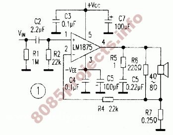

Hi Joe, any opinion about this circuit of current amp? I got plenty of LM1875, if it looks promising, I may go ahead an built it, just for fun.
Why not have some fun then? That circuit, wonder what the DC levels would be like if copied just as shown. But a trimpot to the negative rail may be needed. That 220R on the output will hep when no load or go really high, but with load, needs to be trimmed.

Just want to report...I built the circuit above, and not only its works fine just like it is, it sounds great. While normal recommended LM1875 circuit is ok, inverting with buffer sounds better. However, this transconductance circuit beats them all. It sounds liquid, like good tube amp.

adason, are my calculation of gain of your amp right 22k/0.25+1 = 89 ???
O no, I just notice, R7 is 0.25 ohm, not K. How large is gain and how to calculate it?
Where you place R6 - close to chip or on speaker terminals?

The gain depends on the load impedance.
No current flows into/out of the + terminal so the 22k resistor will not affect the gain.
