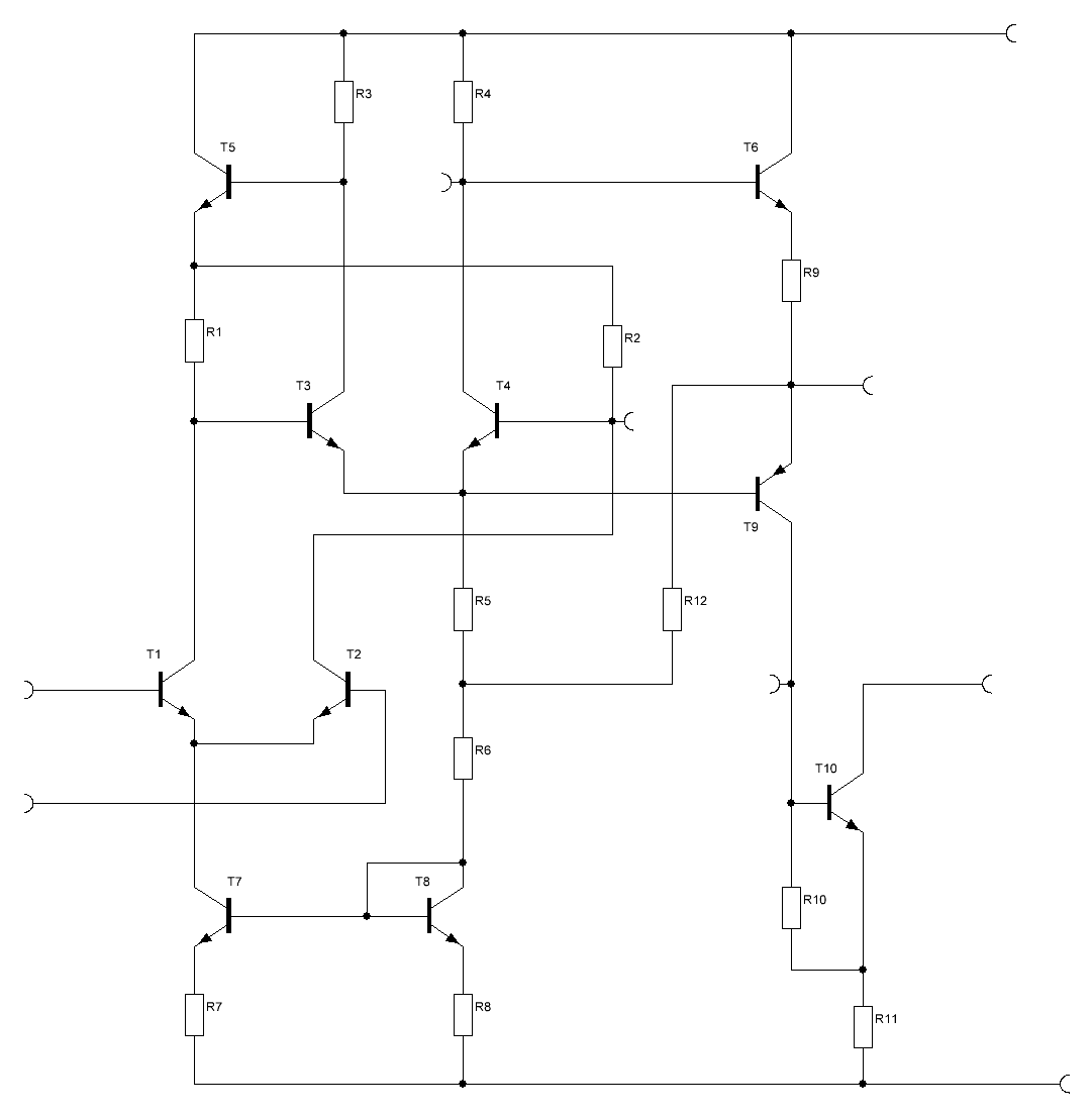

Just a small dimensioning challenge - discrete vintage operational amp - DIY2024
Why not recreate an ancient representative of the first integrated operational amplifiers and track down the developers?
Have a discrete op-amp at hand as a universal genius - and all this with exactly the components that you yourself consider to be the best at this point.
What could you /we conjure up from this? From an audio preamplifier to a power amplifier, to an active reconstruction filter for our countless D to A converters or even a sensitive, low-noise thingamajig for RIAA equalization - anything is possible!
Why don't we start a small dimensioning challenge,
at the end of which perhaps this year's DIYAUDIO (i.e. 2024) operational amplifier will emerge?
Here's a suggestion:
Fire away, but don't look in vintage data books and just copy - the topology is very well known and has been frequently integrated and sold as a standard, worldwide.
Kind regards and good luck,
HBt.

If you are building a circuit using discrete components, i.e. not on a monolithic IC chip, then feel free to use any and every discrete component available.
Use both PNP bipolars and NPN bipolars. Both are widely available and circuit designers can take advantage of this. To name one example, the lowest voltage noise bipolars are PNP and the lowest current noise bipolars are NPN.
Use JFETs. Their strengths and weaknesses are different than bipolar transistors. Exploit this.
Use MOSFETs.
Use Schottky diodes. Use Light Emitting diodes. Use Current Regulating diodes. They're discrete semiconductor devices, they're in stock today, and they're useful.
Use ferrite beads. Use three terminal "feedthrough" capacitors. Use inductors and transformers. Use Zener diodes. Use precision resistors. Use any discrete device that offers an advantage.
Reactions: 1 user

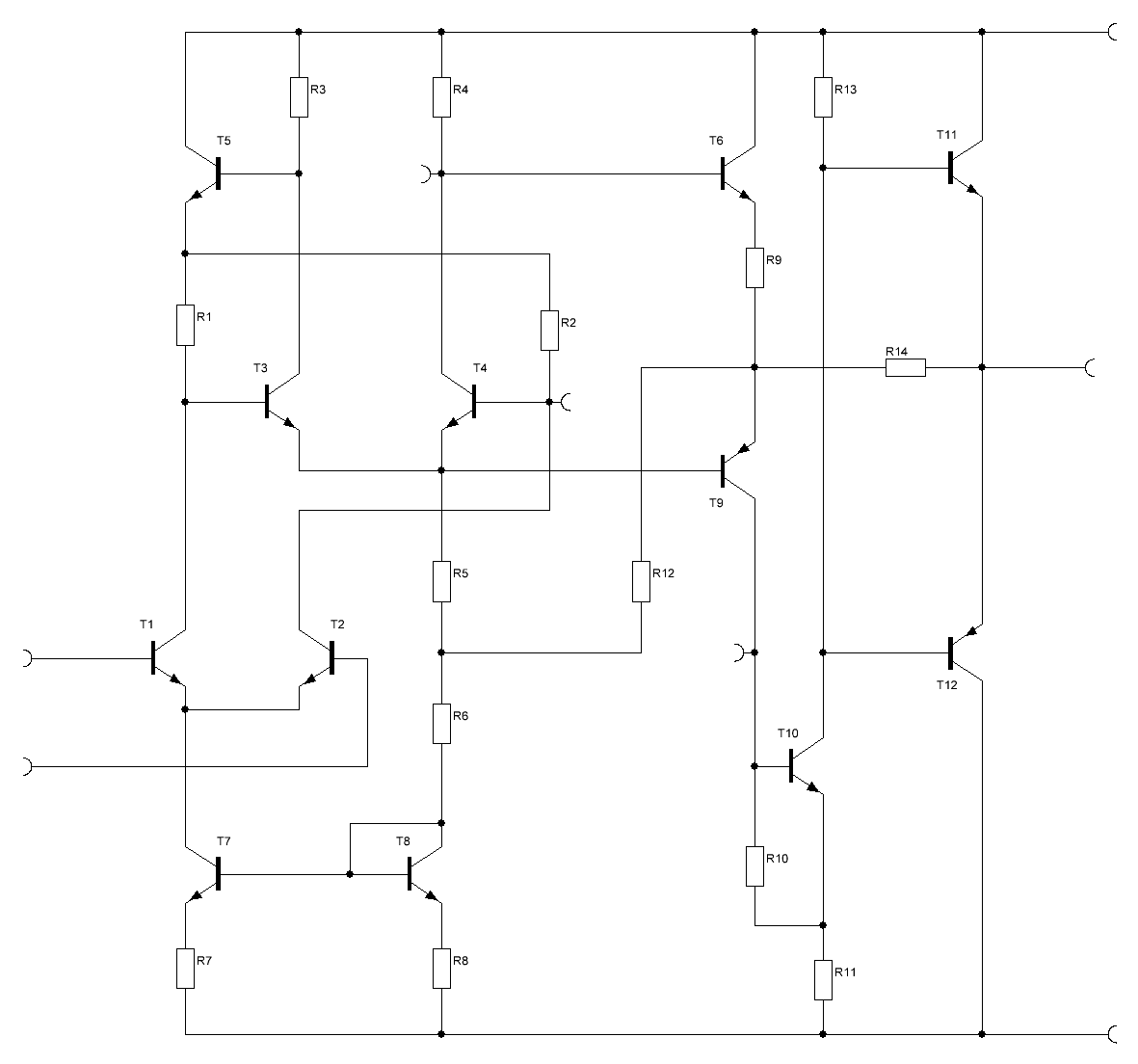

I have included the missing push-pull output stage (of the original) so that “the open collector” need not lead to further questions or fixations on the part of seafaring nations ..!
This is an interesting and alternative idea (solution) to the well-known LM741, in my opinion.

How is this discrete op-amp so different than just a SS power amplifier, with the NFB parts pulled out and the inverting input brought out instead to an input pin? The transistors are smaller in the "push-pull output stage"? The transistors are smaller in the driver to the "push-pull output stage"? The quiescent current is less?
To be honest, I don't understand your question (right away).
The schematic is basically nothing more than a map, a roadmap - in other words, a basic schematic that can be adapted or designed to meet individual needs.
Only the component selection and the dimensioning ultimately determine the application, it could be a logarithmizer or a power amplifier ... or a low-power module, an operational amplifier, an analog calculator...
The basic structure is the same or similar to that of an ordinary power amplifier. But such a module is much more (valuable) as a learning medium.
Only from this point of view does such an undertaking make sense, otherwise I might as well buy a bag of leftover A109, µA709 ... at auction. But none of us would want to use this ancient OP as an integrated component.
But who knows what else you can get out of the actual core?
both an integrated and discrete op amp so as a power amp are identical except for the selected quiescent currents of the individual stages and the deliverable peak current of the output stage.
This term I don't understand:
according the wanted conditions one can always choice both non inverted mode and inverted mode - thus sometimes both the non inverted input pin and the inverted input pin can serve for the signal input and NFB input.
Got it.
Just thinking of an op-amp as a 3 terminal device (sans power pins), while a power amp is two - the feedback mechanism embedded somewhere in the whole circuit. Rather than brought out to a pin you can connect that up to yourself. The closest is the old tube power amps with 4, 8, 16 ohm taps and a wire for the feedback that you're supposed to connect to the tap used.
