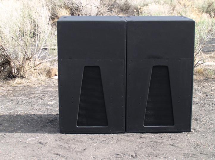

Keystone Mouth compared to full width Exit
Hi Art,

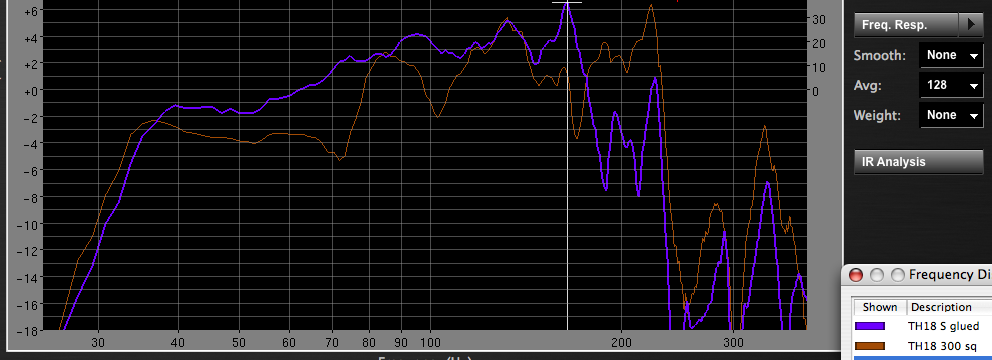

It would be nice to see the difference in the keystone vs a normal box width terminated TH mouth.
My laptop is back, memory undamaged, screen replaced.

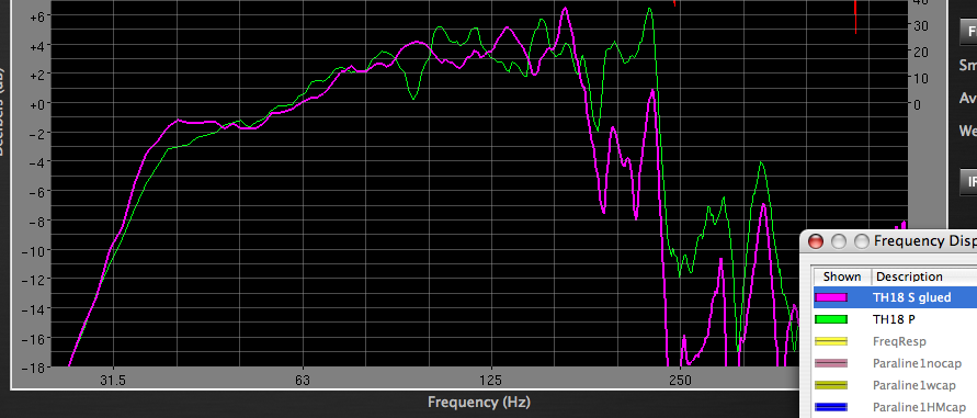

Below are screen shots of the Keystone exit (TH18 S glued), which is 6 inch wide at the top, 12.5 at the bottom, and 25 tall, 306.25 square inches, compared to the normal box width termination of 300 square inches, a 25 x 12inch exit. The Keystone shaped exit smooths out the response, and adds level over most of the pass band.

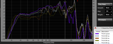

The next screen shows 200, 300,400 and 500 square inch exits compared to the TH18 S glued (Keystone exit). Although a bit harder to see with all the traces compared, the Keystone shape improves level and smoothness over any standard termination size.
Many (dozens) more shapes and sizes were tested, the 306 square inch Keystone exit size (which turned out to be within a few square inches of what a "normal" exit should be for this TH) had the most extended, smooth response of any.

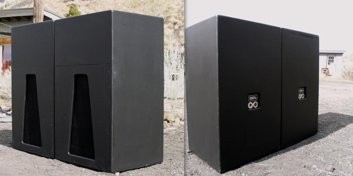

It looks like you've used the keystone to extend the mouth opening to the driver tap?
Do you think that a TH where the driver is not recessed into the horn would have a benefit from a keystone mouth?
Good to see you got your Mac back up and running.
Yes, the thinner portion of the Keystone mouth does extend nearly to the center of the driver.
Since heat rises, having the speaker's rear cooling vents near the upper portion of the Keystone exit also gives thermal advantages.
I think many upright fold TH which have the final exit making a roughly 90 degrees turn would benefit from the Keystone mouth, whether or not the driver is located at the very end (mouth) of the horn.
The Keystone shaped exit would probably offer no advantage in the type of tapped horns where the final segment is pointed forward with the driver located at the mouth.

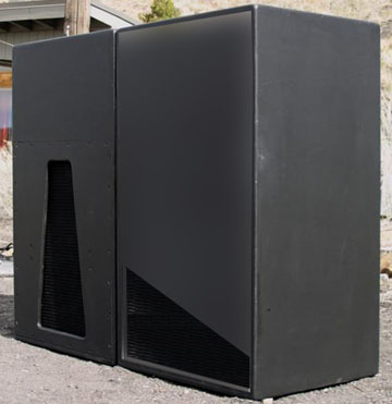

Art, did you try a similar key opening (same mouth area) in different position in relation to your final one?
(Danley seems to use a similar approach and I'm curious about those results)
Maybe not Dan, maybe it's nothing more then a design solution in the TH28. I was just wondering about the results of the "Art-key-opening" in relation to its position. If it still works the way it suppose to and if it behaves perhaps a tiny little better in the lowest octave.

I did not try asymmetrical openings.
The “sideways” keystone in your picture would work about the same as a 300 square inch opening at the bottom of the cabinet, as shown in the chart in post #23.

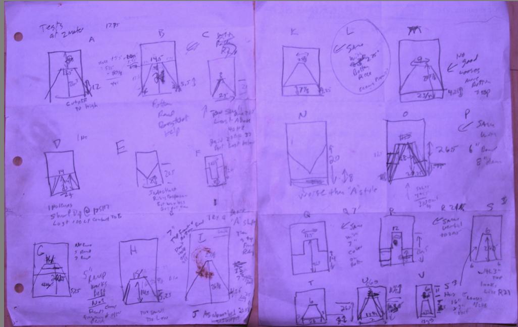

The sketches below show the various shapes tried before (and after) arriving at the Keystone shape.

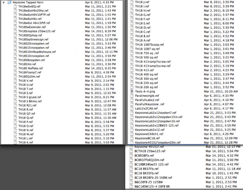

The list of tests is actually only a fraction of the tests performed, many “in between” area tests were done and not saved.
Early in the testing one shape seemed promising, the extended upper response turned out to be a clamp resonating on a piece of wood.
After discovering that problem, each test required walking a 200 foot round trip twice, once to set the clamps and pieces of plywood in place, back to the shop to turn the pink noise on, then back outside to listen for any rattles and correct them if necessary. In retrospect I could have just unplugged the cabinet and saved half of those trips, but probably would have worn out the plugs from hot patching.
Of particular interest, the shapes in “E” and “N”, although similar in cross sectional area in relation to the horn path, did not smooth out the response, or increase SPL like the keystone shape.

I did try a rectangular mouth of the same area which started in the same spot in the path and ended in the same spot without the expansion, test "R".
The Keystone shape seems to be the best compromise for this particular cabinet, I don't know how to explain it other than the way Goldilocks did her testing- too hot, too cold, to hard, too soft, just right.
I'm sure if I had extensively studied laminar flow patterns and such I could give a more technical explanation.
I found the sound output of the Keystone can throw up large rooster tails of sawdust in the shop.
It would be interesting to use a strobe and smoke and watch the air movement patterns around the exit.

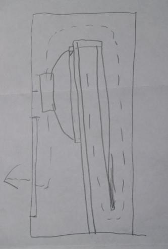

Although LF sound behaves in a cabinet more like laminar flow than ray tracing (light waves), if one visualizes the last portion of the horn, a "keystone" correction needs to be applied for the horn exit to appear rectangular from inside the horn. A regular rectangle or square is actually "too big" at the top of the exit. The overhead photos show this effect, when the keystone shaped exit appears more square, the cabinet itself looks keystone shaped.
It is possible another TH with different dimensions (but similar fold pattern) may work better with a slot or "A" shape, but I am fairly sure none would benefit from a "V" shape, as tests "E", and "N" resulted in worse response curves than a standard opening of the same area.
Those results support my "keystone correction" analogy.
Test "F" was poor too, it seems the sound waves are disturbed with side openings rather than center openings.
Mouth shape, size and positioning all have interrelated functions, it took a lot of tests to work them out.

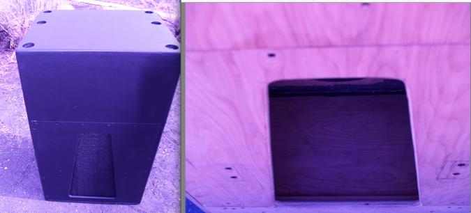

Fair enough... I like the way that you planned to have a removable panel at the mouth so that you could experiment with different configurations. That is good thinking and planning ahead.

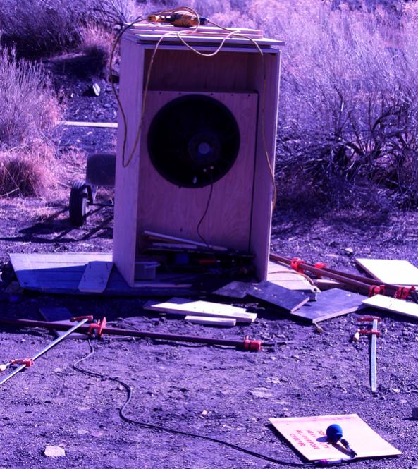

The entire front of the cabinet was left off for most of the testing, as I was also experimenting with corner ramps too.
I'm glad to be done with the Keystone, lugging out the cabinet, all those clamps and bits of wood started to get old after a few days. Or weeks.
Art Welter
