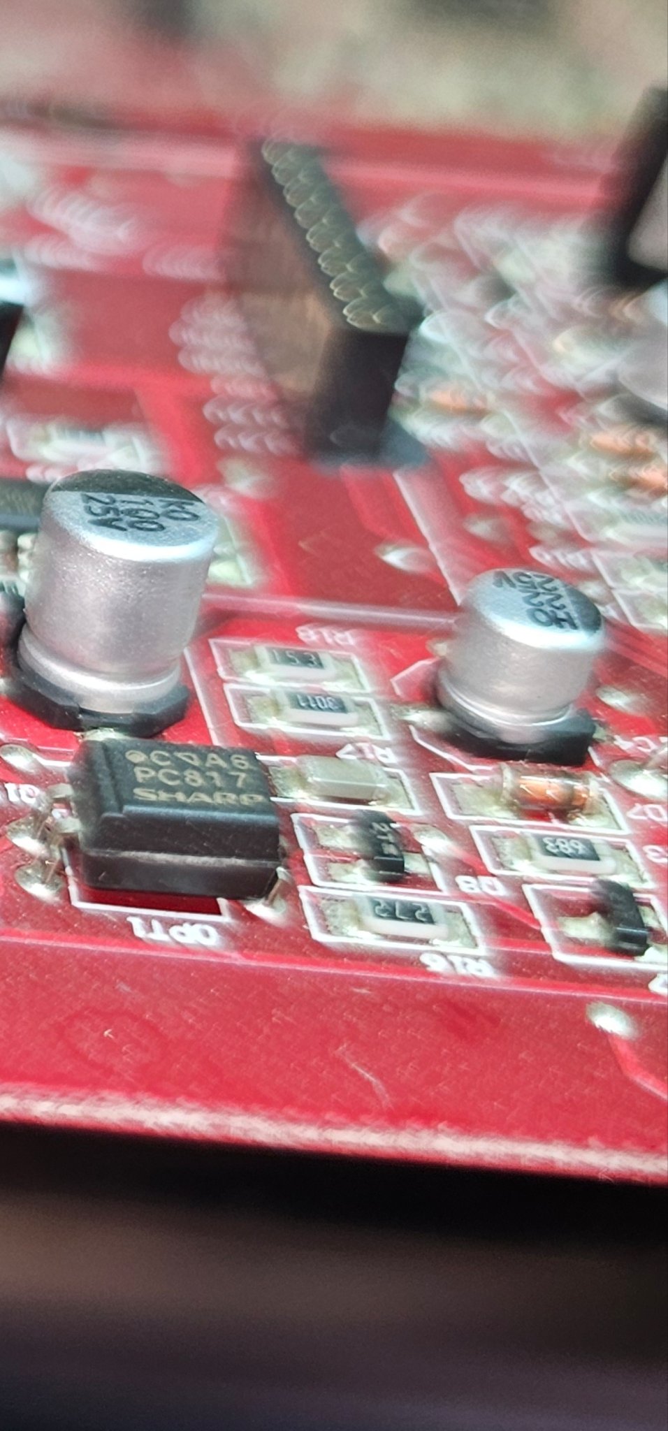

Well, the output fets were replaced (which actually seemed very poor quality to me) and as for the power supply, it is a 120 amp switched source in conjunction with a car battery. Is there any substitute for the IRFP264N? I can't find originals with my supplier
I just did a test with some fets that a friend lent me, and it does the same thing, I suppose I should try with a good battery since I only have 12.3v, I had not had problems before regarding supply with this source, I will return my fets and try
How about it, the voltage does not drop, the fets are original (from another amplifier and from the same batch) based on the source it was an assumption, thinking about all the possible scenarios, now I see that it is not due to low voltage or amps but rather that it is protects and when protected the source is turned off
The red LED and pin 4 came on, I saw that it reached 8v and it did not send pulses to the u2 source fets.
I found this small 2t Q8 transistor with a leak between the collector and emitter, I changed it and it seems to be working well, it is no longer protected, I will continue pressing the amplifier to see how it reacts
