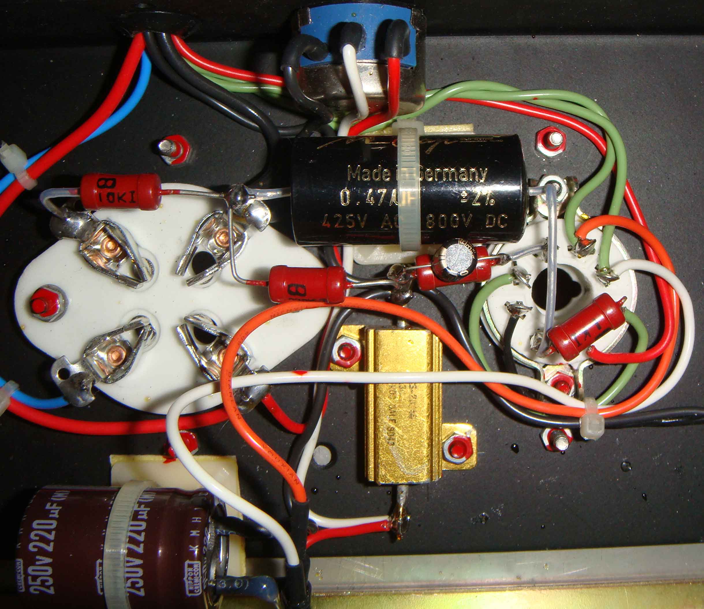

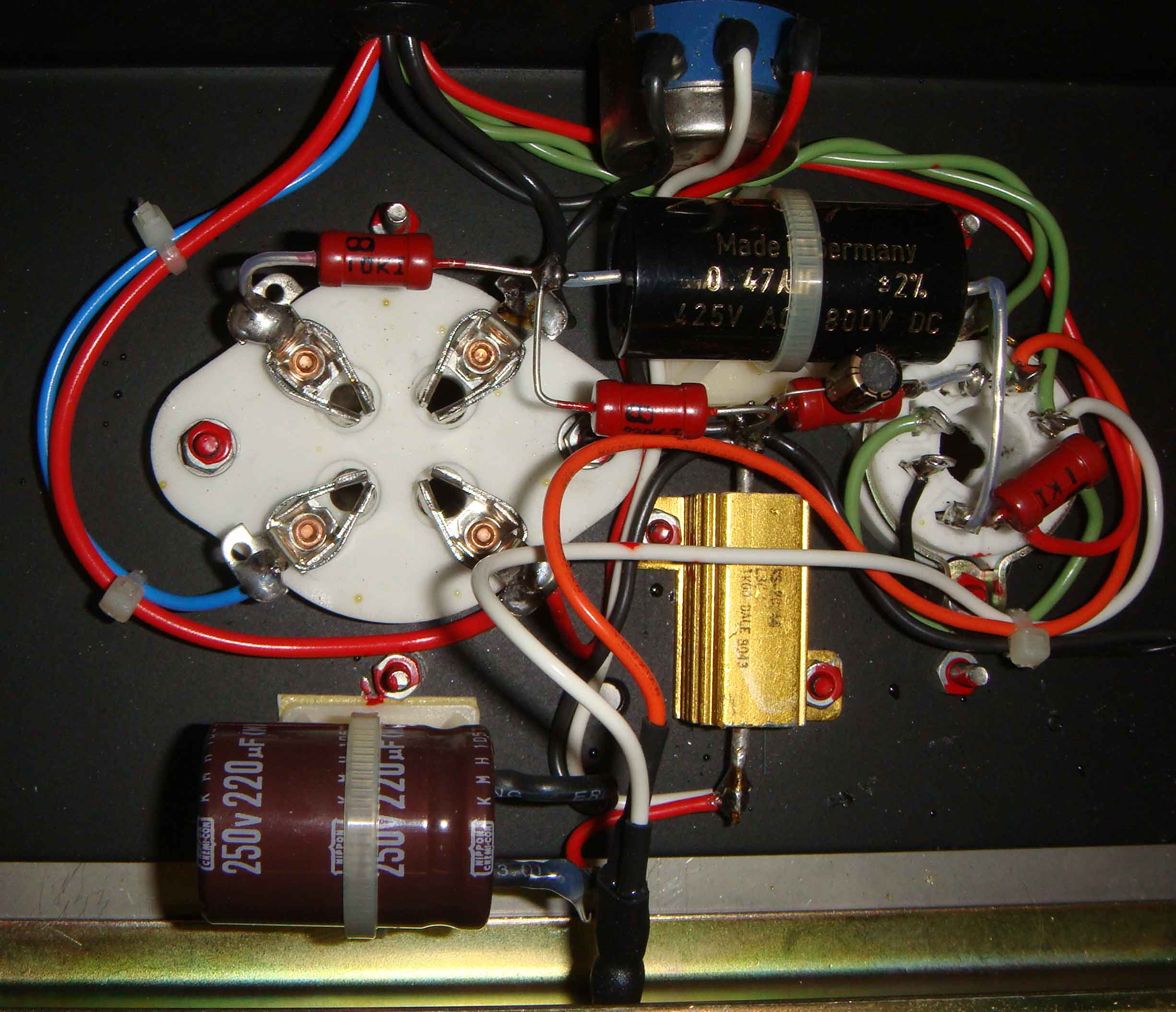

Help with 300B cathode coupling cap
Thorsten, I'm lost on the 100uf Cathode coupling cap. You mentioned its c4 in the schematic. But I can't find anything like that in the amp.
There is a 10000uf Rubycon across the + and - of the rectifier, .47 Mcap supreme from the driver tube to where the negative lead attaches to the 300B, and a 200uf cap that goes across the large resistor that is in the gold heatsink. I've attached some pics to help.
If you can help point out where the cap I'm missing is, I'd appreciate it. Everything else I think I have figured out.
Best, Bruce

Hi Bruce,
its not Thorsten, but as I have heavily modified Ladydays, I feel somehow responsible...
The cathode cap should be the small one right under the .47 Mundorf, which is soldered across the small red resistor. Possibly someone changed it already to a better one, together with the mundorf.
In case you don't have a film cap with that big size, you could try a 100 or 47µF Oscon Sepc or if not available a Oscon SA, which is an older version. Film caps are better, as Thorsten pointed out, but these Oscons are close.
It should also be rewarding to change that resistor for a very good one with the same value, a Takman 0,5 watt is a good choice, where the metal film is a bit more on the clear side, the carbon film on the warm.
But the heater supply is clearly most critical, and the CCS is a nice upgrade too.
But, honestly, the biggest upgrade is surely changing the driver valve to something more suitable for the 300B. I tried 6sl7 both systems paralleled, then with CCS, but ended up with C3o in pentode mode, a 6.3 Volt Version of the C3m. And this is how it will remain for sure, its miles ahead of all the other drivers I tried.
Also very good was the E81L as pentode, which also has a 6,3 Volt heater and could be used with your power transformer, but with a different tube socket.
I tried quite some drivers during the last years, its fun and you can learn a lot.
cheers,
Jogi
Unfortunately, I don't know the history of the amp so don't know if what is there is standard from Opera or was changed.
That the small cap is the one in quesion makes sense. The printing on the cap was cut off right where the outer wrapper goes to the edge, so the value was half cut off. So I could read a 1 and that was about it making me unsure I had the right one.

From your Photo's the Amp's look completely stock, I wprked on quite a few, they all pretty much look like this.
