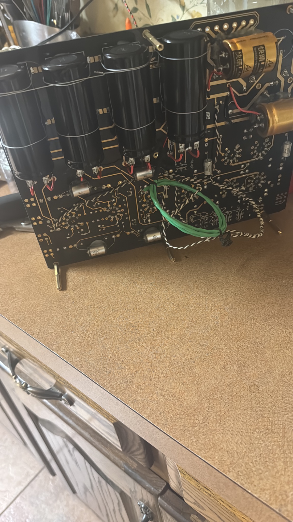

Hello! I finished the kit with the clone case. I’m lucky I didn’t get any hum. However, I do get some white noise that increases as I increase the volume and I have a lot of channel imbalance. I have tried changing the position of the tubes and changing them for some RCA NOS 12AU7s that I happened to have as they are supposed to have less gain, but no luck. They even pick RF which didn’t happen with the 12AY7s. Any suggestion? Thanks in advance

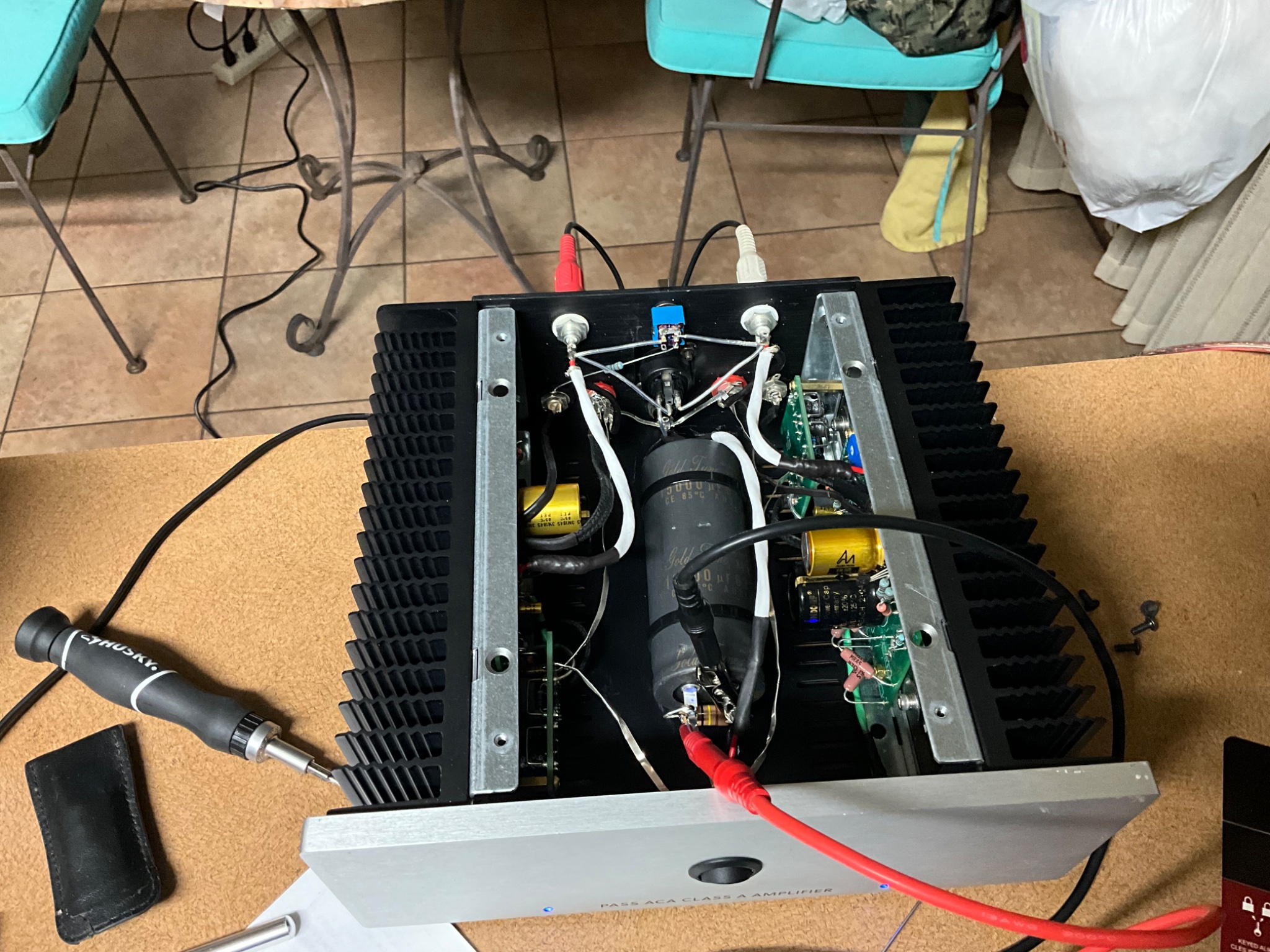

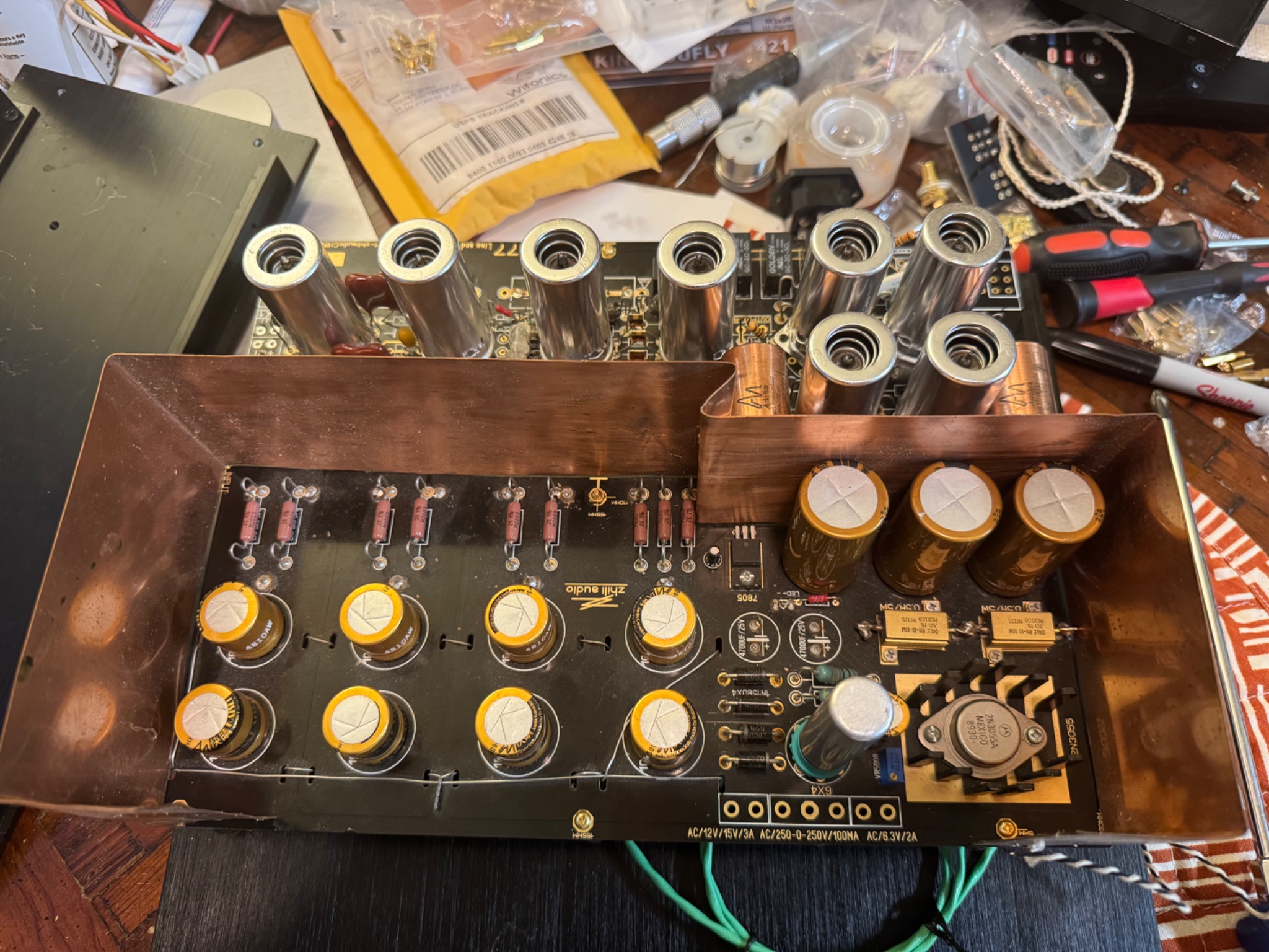

For all the matched components, potted inductive devices in fabricated copper pots and silver crap I put into one of the two I bought, my socks need to levitate off of my feet while my shoes are still on when I connect this thing into my mono block ACA’s.

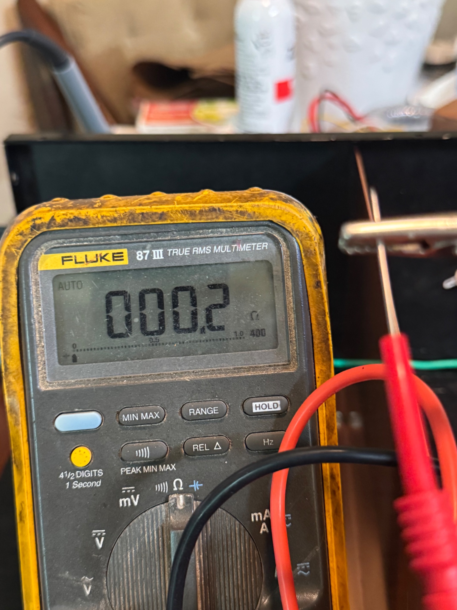

I just finished soldering the mj3000 and the zener diode. However the trimpot does not have any kind of stop and hence I don’t know how to set it to maximum resistance. Could you help me with that? Thanks in advance

Check the output noise when selecting a shorted input. Do you still hear something? It is quite common to hear white noise when the phono input is selected but nothing is connected.
Channel imbalance is odd, does it happen on all inputs or just the phono?
Do you have an oscilloscope, and can you use it to test if the output shows RF oscillations?
that would be helpful to further determine what is happening. In the 3-4 builds I was involved in, no oscillation happened and the two channels worked identical. We did however run into cross-coupling from unused inputs (the traces on the PCB run very close and in parallel over a long distance), but there is a fix documented in this thread.
Thank you for your help. Thats what I was doing but I can’t get to the maximum specified resistance. Guess its a cheap trimpot
If I remember correctly, it is 500Ohm, you could just put a fixed resistor of the same value....
