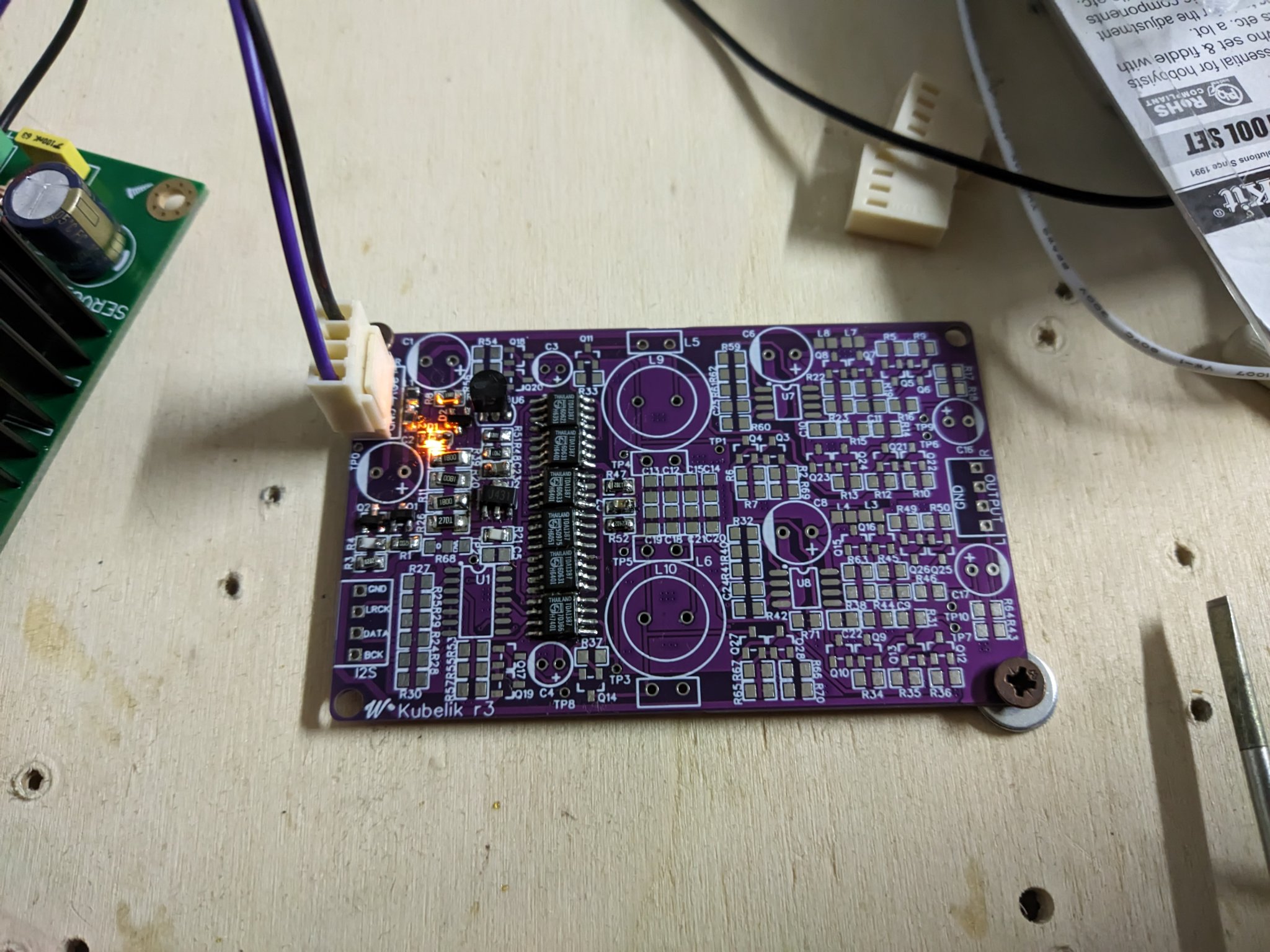

Hi guys, I just started soldering my Kubelik and it's my first attempt at SMD. I began with the tda1387 chips. To be honest, I chose to entirely solder them immediately, cause I felt more confident doing that than solder just two pins. So I of course hope that they are all working chips. I forgot just one thing: as per guide, it's suggested not to solder pin 7, but I did it, I soldered all pin 7. As far as you know, is it a big mistake? Does it compromise tda1387 functionality?
Thank you,
Gaetano.

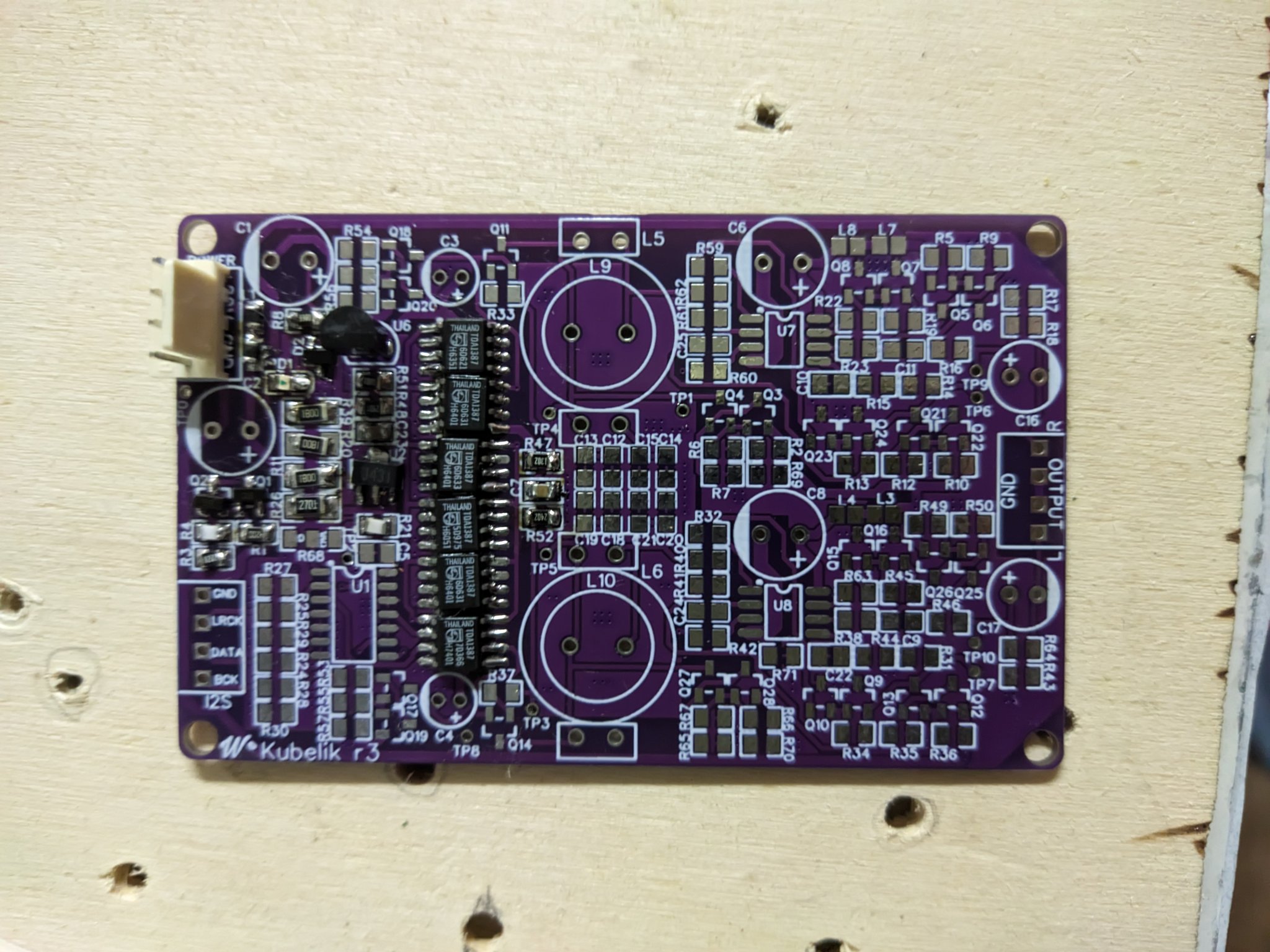

Hi Richard, I just finished my Step 1. All's good but TP1. It reads about 3.98V, while other TPs are ok. LED doesn't turn on and I tested all tda1387s pin 7 and they read all about 0.745V. Then what could be the issue?
Many thanks,
Gaetano.
Don't blame me for the poor SMD soldering skills, I'm at the first attempt, if something went wrong it's quite normal! ;)

:ROFLMAO: No, not yet!! Anyway I tried reflowing some solderings here and there and the magic happened: LED turned on and TP1 read 10.1V, being all other tests correct. Fiuuuu...I suspect Q2 wasn't working properly.
Gaetano.
