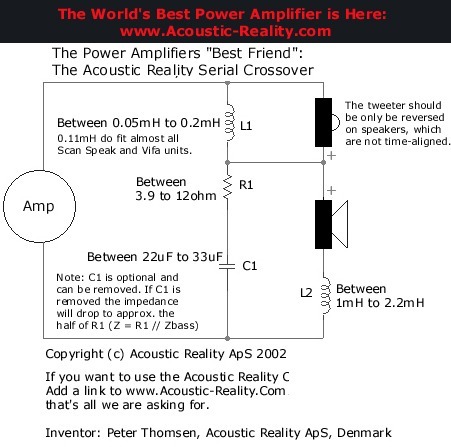

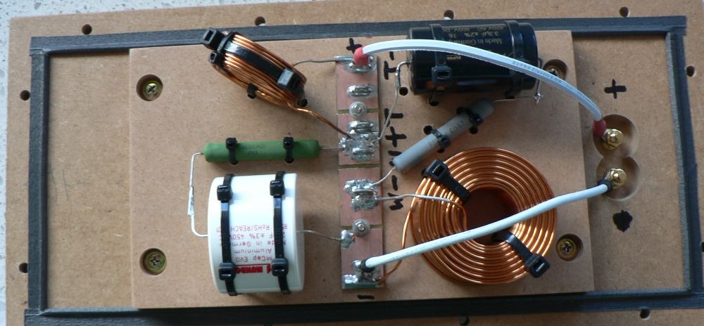

Hello, I’m looking at trying the Aciustic Reality series crossover. I’ve never laid one out though. Looks like just three components. Can anyone help me?
I’ve never laid one out...
Connect L1, R1 and L2 together in a straight line.
The amp connects to the free end of L1 and the junction between R1 and L2.
The tweeter connects to the free end of L1 and the junction between L1 and R1.
The woofer connects to the junction between L1 and R1 and the free end of L2.
(Observe the tweeter and woofer polarities, i.e., ensure the + terminal of each goes to the junction between L1 and R1.)
Is this helpful in laying out the crossover?

Without the cap missing in series with R1 in the same leg (Rabbitz' network has the cap as I am suggesting), the resistor there will get VERY hot as it is the amplifier load without the cap there. 100W heatsunk externally mounted resistors are recommended for best practices. It will also kill the output of the woofer as the resistor is directly in parallel with it without the cap. The cap should be 15-25uF range if you are looking to voice by ear.
The reason it is touted as amplifier's best friend is the resistive load the capless network makes.
The result of a series xover does not add the impedances for a higher load value. This is incorrect internet lore.
The AR series xo tends to have a flatter impedance plot around the xo frequency rather than the usual roller coaster shape you get with other xo's. Most of mine fall within a 4 ohm envelope excluding the woofer Fs rise.
AllenB is correct about the tweeter sensitivity as if it's too close to the woofer sensitivity R1 becomes too low and the xo impedance drops dramatically. A few dB higher for the tweeter SPL is the aim.

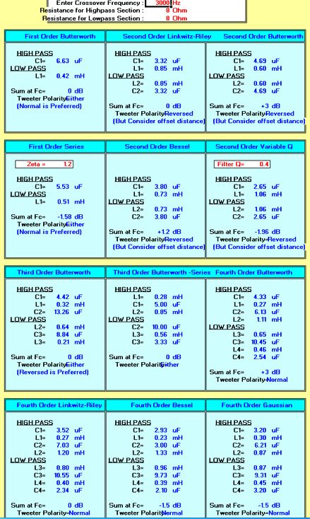

The late Jeff Bagby was a great theoretician and published this table of values for 8 ohm speaker filters:

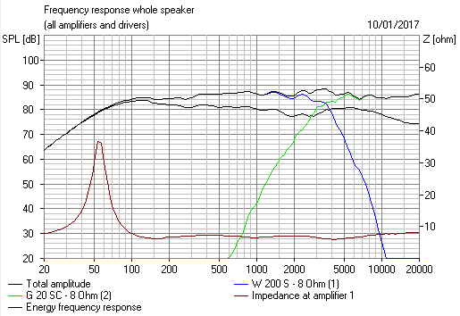

I tried this in Boxsim 1.2 simulator and the results were impressive, albeit they might be bass light:

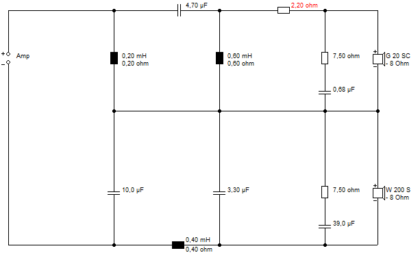

The circuit was this with visaton drivers and time alignment:

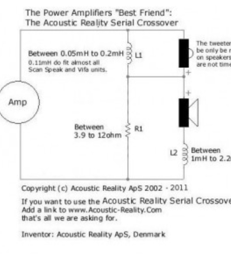

I have seen that Acoustic Reality Series Crossover many times in past 10 years - as well as many variations, and always annoyed me...... isn't it odd no crossover point is ever indicated? How about tweeter and woofers - are they 4 ohm, 8 ohm? Those stated component values calculated for woofer or tweeters of a certain impedance, so what are they?
Understood standard 1st (or 2nd) series crossover have same component values as a 1st (or 2nd) order parallel, but that AR Series are not standard values, and appear to be 2nd order on woofer and 1st order on tweeter?
That AR website implies you can put this magical crossover on any 2 way speaker and it will be transformed into something special, regardless of crossover point...bah!
What gives, or am I just slow?

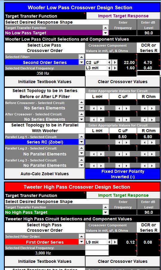

The best advice I can give to you is to ditch that silly crossover, and design (with measurements!) a proper serial or parallel crossover, using any free crossover simulation software.

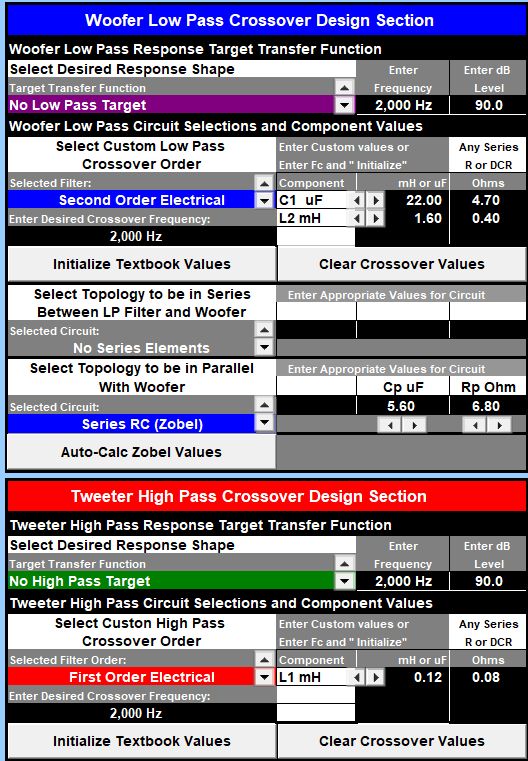

I have and used the Bagby Crossover designer for quite some time. I assume I go by the 1st Order Series? If not, which one will get me the values of the AR for L1 and C1 or L2?
In PCD you have to select Series Two-way and then load wiring configuration. Woofer select 2nd order series and tweeter 1st order series. See an example for PCD and SCD which has a zobel as well which is not part of the original AR design.
It's only one type of filter using L, C and R and has advantages and disadvantages. With this type of filter any changes to say C1 and L2 also effects the behaviour of the tweeter. It's important to have a very low DCR in L1 and should be <5% of the tweeter Re (for protection).
