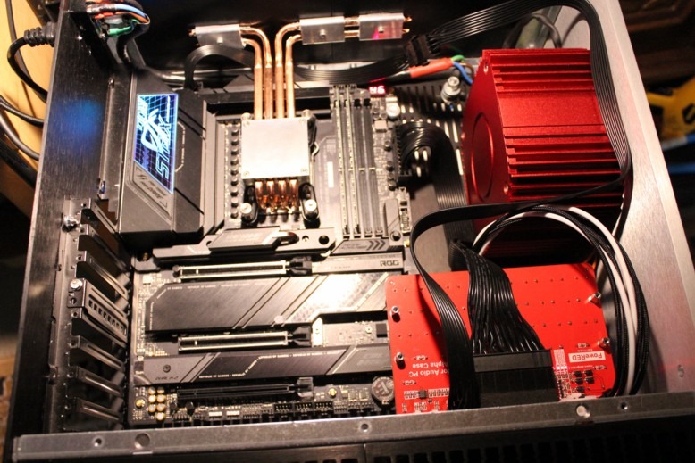

In the last few days I've built a server using a full size ATX ASUS board and the Luxor LPC250-RED LPS.
The Luxor comes with its own toroidal transformer, which weighs a ton for a 250VA transformer. In the pic it is housed in that Ali Express red finned case. JUST FOR COOL :cool:. I may have retired from my job...but NOT from childhood. NEVER!
Price and shipping for the Luxor unit from Hungary to Germany set me back just under $470 USD. You can see full pics and specs on it at the link provided above by Deenoo, to whom I am eternally grateful.
I would have bought one of the HDPlex LPS units, but they never have any. Tired of waiting.
The new build shows its heels to the NUC setup for several reasons. Even though the NUC was attached to a Singxer DDC the new ASUS build employs a Pink Faun I2S bridge, fed its 5 volts by my Sean Jacobs homebrew LPS. Both use APACER Industrial RAM, but the ASUS mobo makes full use of ECC.
Both also use Audirvana Origin, Windows 10, Fidelizer Pro, and Audiophile Optimizer.
Before Audirvana I was using Euphony Stylus. Audirvana is the hands down winner. Euphony makes a total mess of music file organization. Audirvana has turned it into a work of art. The great sounding Linux-based Euphony is lightweight and easy on the resources. Audirvana is anything but. But, WOW!
In the next few days I'll try the new system with a Streacom ZF240 switchmode power supply just to see if I can detect any differences.
Very interested in what your conclusions are. I am about to try to install some lps in my pc.
Theoretically, I thought ECC can only introduce more (instead of remove) noise and jitter because it's fundamentally more steps and checks.

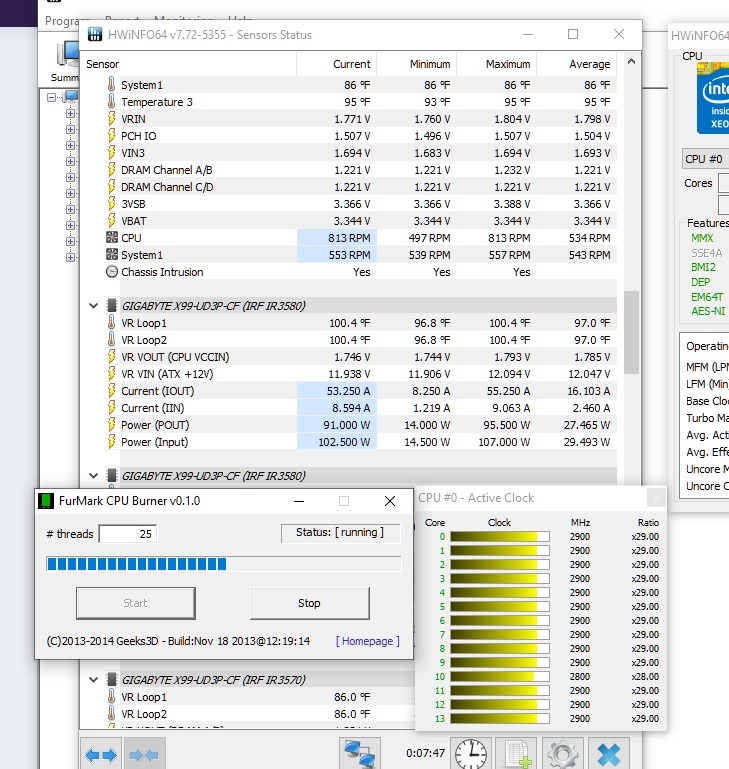

My main PC is a super quiet E5-2680 V4 Xeon , the PS is a Corsair RM550 (<10mV all rails).
-12V is legacy and maybe not needed andmore.
What? , all the CPU and memory VRM's run off of 12V (below). Xeon sucks up 8A @12V to supply 53A .9V Vcore. ATX 5V and 3.3V aren't used
much anymore. CPU Vcore , PCI-E and memory all run off the 12V. Video card also can use 8-10A 12V....
3.3 and 5V are used mostly for drives (SATA).
I notice the Corsair PS 12V drops to 11.9V with all them low voltage amps flowing.
My external 12V (for the audio interface) is a small SMPS , no analog ?? under 1mV.
