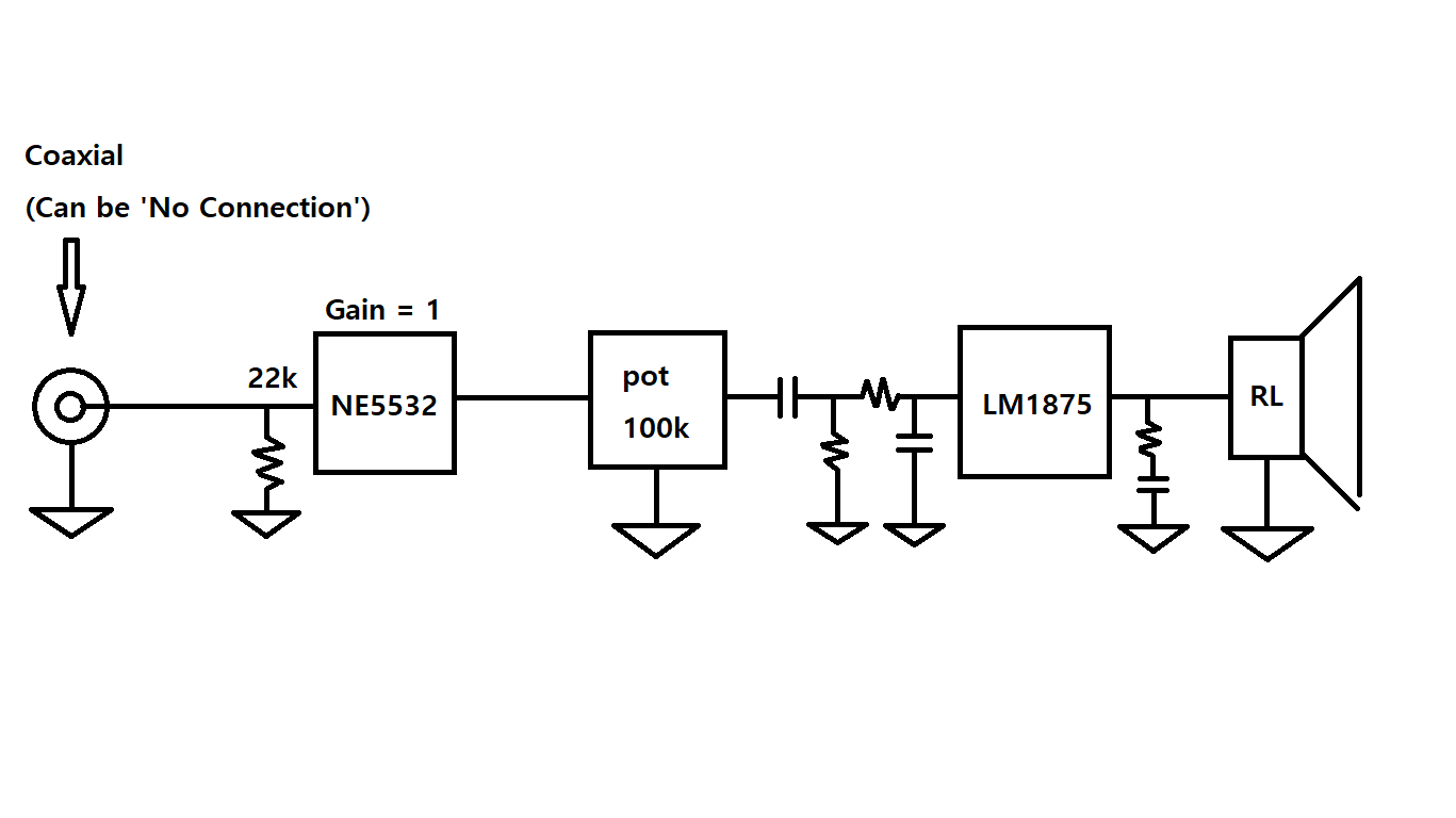

Hello Tom.
Thank you for your more specified description!
Could you also kindly explain me whether below diagram should works?
I'm using NE5532 as a unity gain buffer to isolate exeternal signal and keep output impedance of buffer to low.
The key point above diagram is this : There's LPF and HPF networks at LM1875's input but there's only 22kOhm resistor at NE5532's input, without any DC blocking capacitor.
Would this be safe at any source of audio signal, including situation of NC coaxial?
That's because I want to make durable amplifier, could be treated like any other "commercial " home appliances.
So I thought considering most of unwanted situation is important and would like to reinforce my design through other's advice.
Wish you have a nice day
Also huge thanks to the Tom, that explanation really helps me a lot!Most amps with a JFET or BJT input will need somewhere for the input bias current to go, so they need a DC path to ground. Your figure shows such a path for both the LM1875 and the NE5532 so I'd say it's good ... at least as far as floating inputs go.
