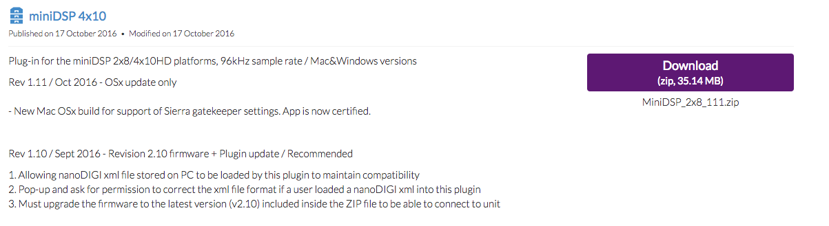

The plugin and the firmware come in the same ZIP file, and that's the only file offered to download @ minidsp. enclosed screenshot of download screen.

If you had an older plugin version installed you might have to uninstall it before installing the latest plugin. They have fixed that issue a couple of years ago, and you no longer need to do that, but if your installed version was earlier than 1.06 (I believe) and you try to update directly to 1.11, I believe it will cause an issue.
Regardless, this shouldn't affect your ability to flash firmware to the unit since that's essentially a separate process. You might try running the DFU tool by itself directly via the installed shortcut.
