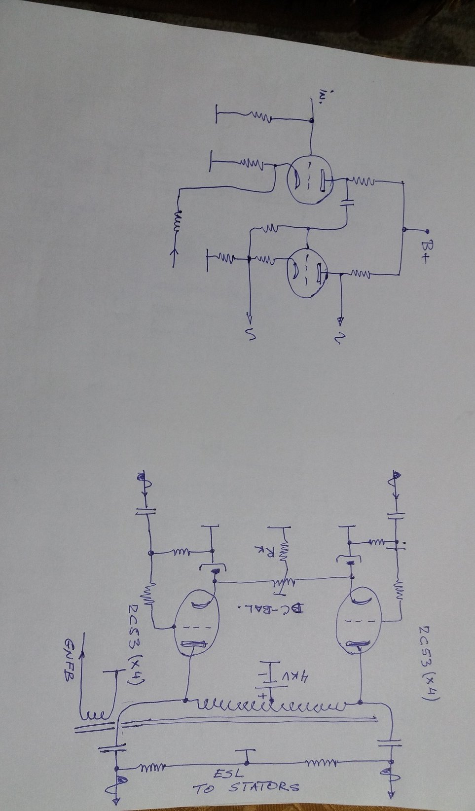

This may be the most useful tube found yet, needs paralelling offcourse, but would be easy to driveWould parallel tubes for the required current work? Thinking tubes like the 2c53 or 7235 . Heater current for five 2c53 in parallel is still only 1.5A.

that`s just OK to made experiments with those tubes and to see the results , but IMHO you should not ignore those 2C53 triode tubes , since their overall characteristic is very interesting for one simple HQ- ESL-OTL -AB1 class full tubes amp , only drawback is that you will need about three or four 2C53 tubes per PP side , but one of the advantage is that you can drive them very easy with one more double triode such is let`s say 6SN7 or 6SL7 tube .
