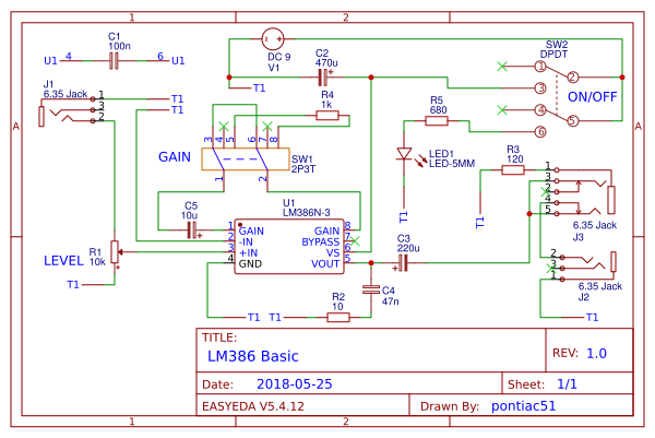

Lost on LM386
Oh, that is actullay a 680R for 13mA. The 5mm LEDs I use are recommend for 20mA.

The 47nF on the IN did nothing for me. But raising the supply voltage to 12V nearly got rid of the crackles, they are far less dominant now. What is this and why is it happening? Or even better, can I get rid of it?
I used a power supply this time and noticed some hum or fizz. Could I counter that with a 100nF on Pin7?
And I changed the 120R on the headphone ground back to a 10R. Of course this is much louder now, it's on the brink of being to loud at full power.
I also changed the LED resistor to a 2.2k, which still is enough to light it.

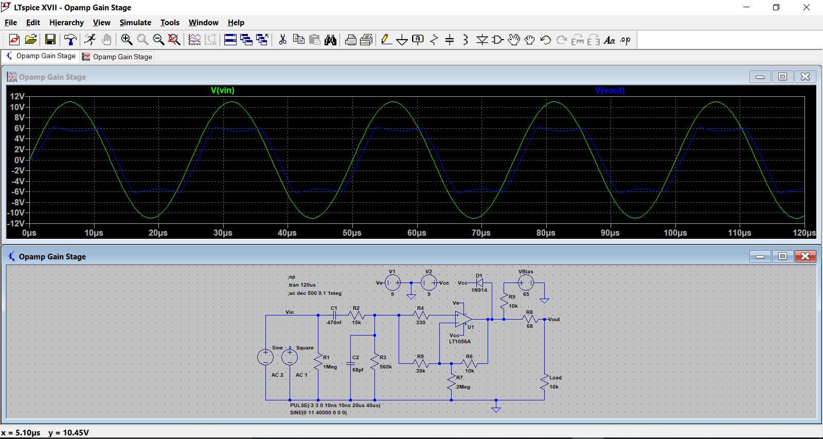

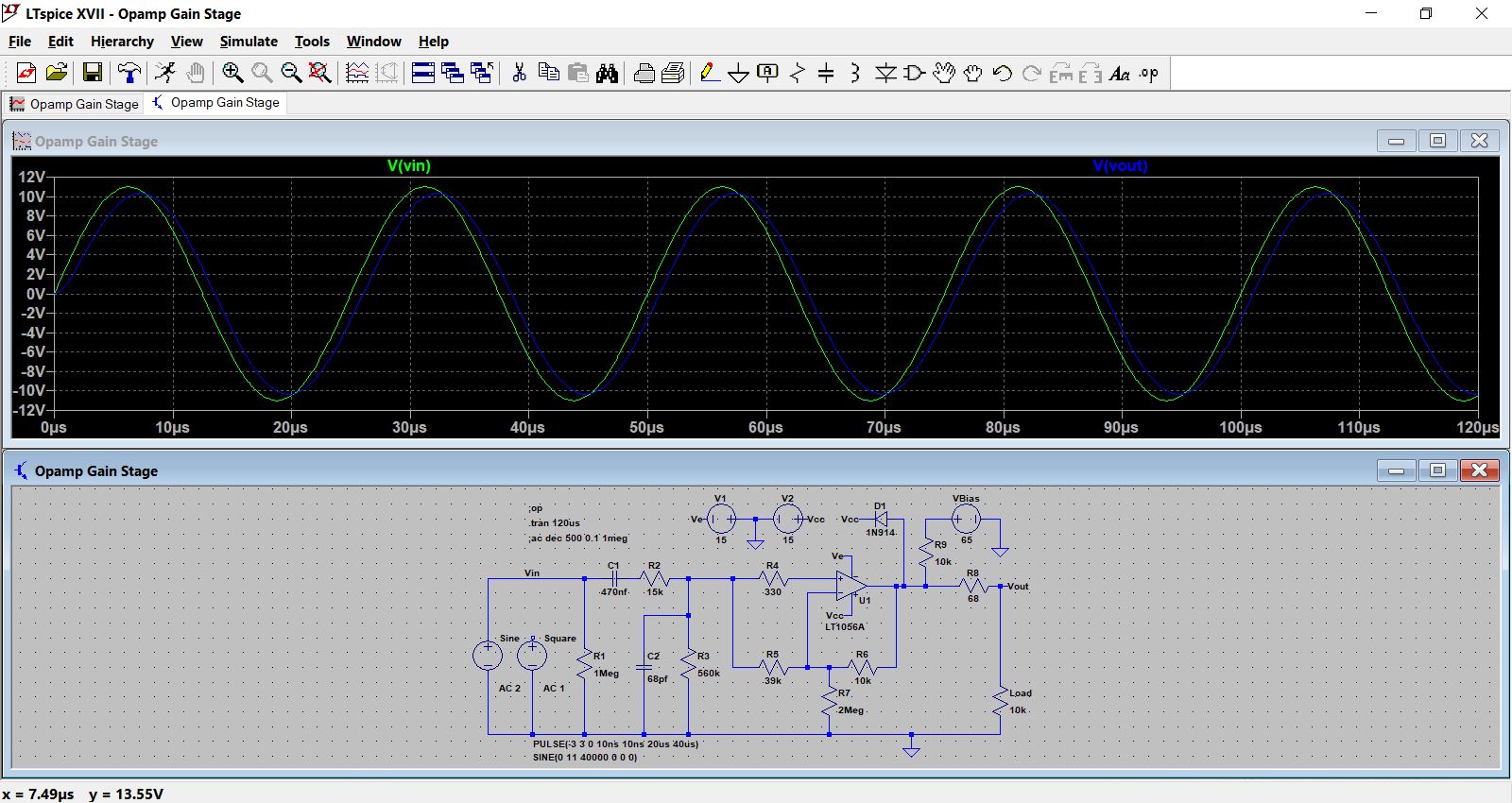

It sounds like the amp is running out of steam and clipping. That means the output voltage is trying to go beyond the limits of the power supply.
This shows a simple opamp buffer running on -/+9 volts and being fed an 11 volt peak signal. It clips. Now we raise the supply to -/+15 and its all good.
You could try a cap from pin 7 to ground. Perhaps something a bit bigger such as a 10uF electrolytic. Try what you have though, there are no hard and fast rules for that.

I've never studied the differences tbh but the N4 seems to be rated to 18 volts as against 12 volt for the others.
For 9 volt operation into a speaker (and headphone) the N3 looks the best bet. For higher voltage operation into a higher impedance load (headphone amp) the N4 looks best.
A preamp wont overcome issues of overloading, in fact it would probably make things worse.
Ok, then I will have to make this tradoff. I really want to stay on 9V.

This might sound illogical but try adding a small (0.5 or 1 watt) resistor as a dummy load even when using headphones. Something like a 6.8 ohm to simulate a speaker loading.
Connect it from the output side (negative) of C3 to ground. That will make the chip work much harder and so distort earlier when using headphones.

The 1W 8Ohms on the OUT and the signal limiter on the IN (I hooked up two LEDs) just let everything crackle more. But I guess that was to be expected. Yes, I tried that one after the other.
I'm sure the headphones are fine and yes I have tried different ones (ever more ohms) and that sounded the same. Breakups and crackles as soon as I went over 80% on the volume dial. It sounds like an overdriven speaker, but this also happens when I up the headphone resistor. It gets quieter, but the breakups are still there. So, I am sure its not the headphones.
The voltage on the ouput pin checks out at 3.87V with 7.75V overall powered up.
