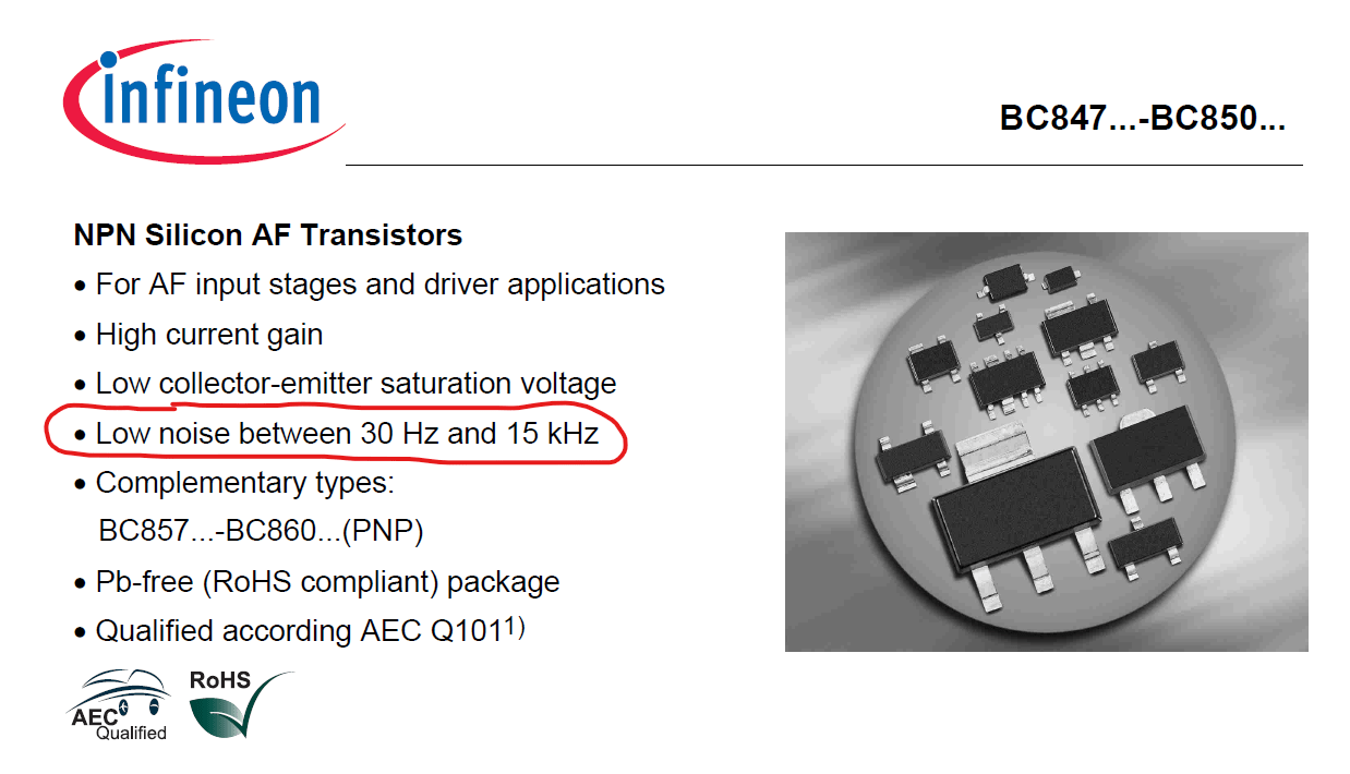

There are some duals in the BC8xx series.
I don't know if they are very low noise parts; never used them for that specifically.
I hope you like SMT.

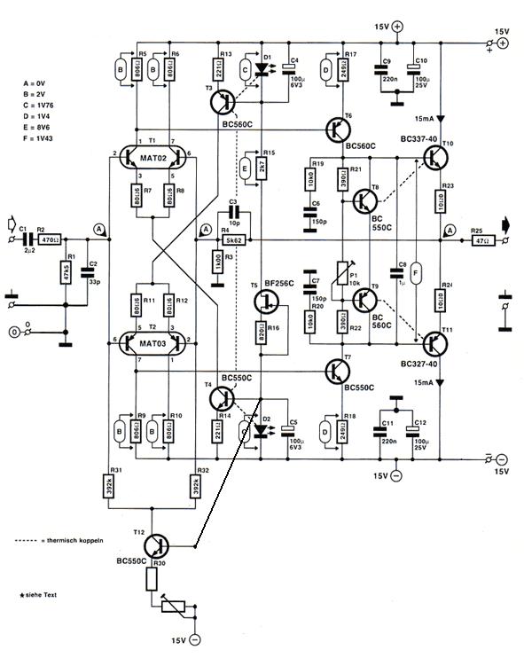

@hcpower if your concern is low noise you might consider the following, if I recall this correctly, a dual LTP input has higher total contributed noise compared to single LTP. Although the symmetry looks aesthetically pleasing to the eyes there is barely anything advantageous about it, not even the very best low noise opamps usually don't utilize dual symmetric LTP input stage.
You could rework that Elektor circuit by skipping the p-type LTP and its CCS, and then tie up T7 as a CCS, something like that.
