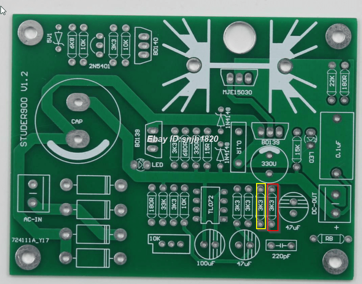

Hi, i have a problem with this STUDER900 v1.2 board: https://www.ebay.com/itm/353965460852
I want the output to be 5V and have feeded it with small 9V output toroidal transformer like the seller has stated in description. And the RB resistor is also 1kohm. But the output is 12.8VDC, i tried to change the RB resistor to 10kohm to see what happens and then i got 13.0VDC output.

Okay got it, one led was missing in the kit and i did not populate it at first... didnt know it was needed to work properly Now installed it and got the 6.6VDC reading minimum. It's kinda useless anyway because I was planning to use it with my Primare NP5 streamer but it seems the streamer is not working with 6.6VDC.. maybe it has some protection or something.
Yep, DIY pack, soldered all myself and was double-checking all the caps and resistor values too.
You have there one variable resistor, please make some turns when connected to the muticet and see whether the volatage is changing. Be patient, it is changing very slow and try to get to 5 VDC. In case there is no change somethig is wrong.Now installed it and got the 6.6VDC reading minimum

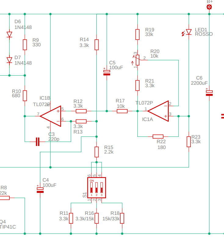

You need the schematics of this board . If you look to my schematics in the pdf attached to post #328 of this threat, you see that in the "old" board the output on the PIN 1 of the first OP Amp is compared to the Voltage drop given from R14 connected to Pin6 and the positive voltage. The voltage drop depends on the current flowing through R14, which you can change with R11, R16 and R18 or a combination of them (parallel resistor).Okay got it, one led was missing in the kit and i did not populate it at first... didnt know it was needed to work properly Now installed it and got the 6.6VDC reading minimum. It's kinda useless anyway because I was planning to use it with my Primare NP5 streamer but it seems the streamer is not working with 6.6VDC.. maybe it has some protection or something.
At the end with R11 of 2.2 k
Ohm you are in the range of 5V output and you can then fine adjust the voltage with the 10KOhms Potentiometer.
Now looking at the images of the board in ebay it seems the the position of the op amp are inverted.
If I have read right the tracks of the ebay board, you should try to replace the 3.3k resistor marked in red in the picture with 3,3k+2,2k resistor ca 5.5k. If you have 5.6 k better , but it does not matter.
If it does not work maybe try with the one marked in yellow. But I am quite sure is the one marked in red.
Hi,please advise where to get a schematics of the variant 1.2 which is different from the "old" board ?You need the schematics of this board . If you look to my schematics in the pdf attached to post #328
May be too small, should be about 1 A, check it and if required replace ithave feeded it with small 9V output toroidal transformer
The schematic is identical with the pdf of my post. The only difference is that the position of the opamp is switched.Hi,please advise where to get a schematics of the variant 1.2 which is different from the "old" board ?
The other difference is that know there is no place for an additional resistor to set up the range of the output voltage.so you have to substitute 3k3 with what you need.
The schematic of this regulator has never changed.
