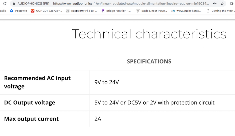

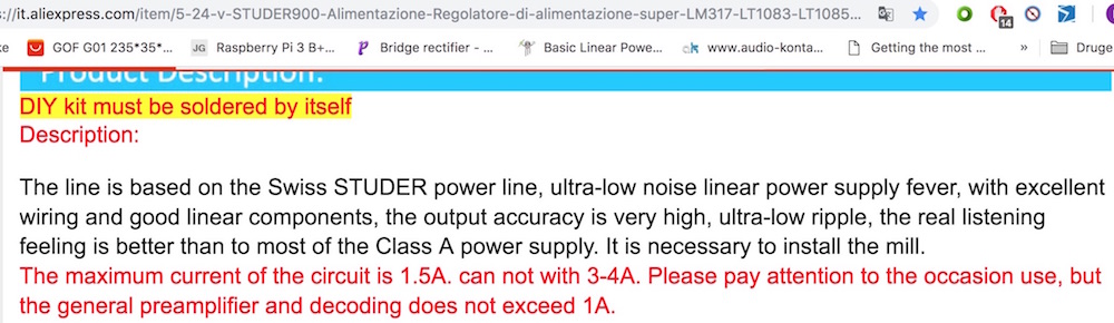

I am really confused about this board.
Same pictures...same board on audiophonics,ebay,aliexpress...but different info abut max current...from 1A to 2A.
I can see some people say it can do 3A.
:confused:

@nikolacigo
You can't trust the specs. because they don't state the voltage at which the stated current is available. The ebay merchants are mostly re-sellers who don't know much about the board at all.
With an appropriate AC input you should be able to get 1.5A at 5V. If you want a continuous 1.5A you would probably need bigger heatsinks.
I'm successfully using a 5V boxed version to supply my RPi 3B+ (slightly underclocked and under-voltage). I had to fit a lower current-limiting resistor to get enough current. The MJE15034 transistor is heatsinked to the case, which gets only slightly warm.
