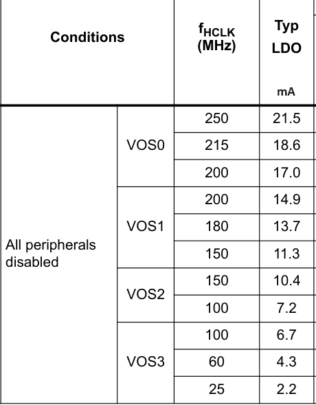

For some reason I didn't catch on when these STM32H5XX were released last year but they turn in some quite respectable figures for uA/MHz. To me 'respectable' means <100uA/MHz. The other thing going for them is their top speed of 250MHz, I don't know of any other M4 or equivalent that runs higher - except when part of a multi-core perhaps.
Here's the most optimized configuration current draw vs MHz chart. Its slightly ahead of the STM32U5 above and also beats the HC32F460 but has fewer useful peripherals like SPI and I2S than the F460 and much less RAM :
The STM32H5XX range comes with an 8k instruction cache which practically guarantees programs that can fit within 8k will run at 0 wait states.
